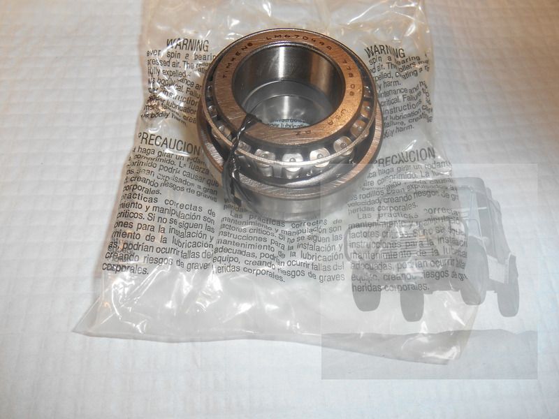

Two things will let you know you have (most likely) Timken Bearings when buying them in a non-Timken Box;-
1) the 'Matched Bearing Assembly' Notice and
857f1ec13640261302c6854fad019838c9919eab
2) the plastic bag that the bearing are actually in (might be a bag in a bag)
2fa6de01696396a88285d561a16093a1ea26b73e
