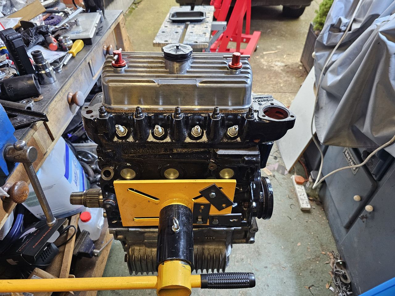

The gearbox was reunited with the engine yesterday.  So a bit of a milestone moment for me.
Sadly, the rather expensive (but excellent) RTV gasket sealant took a nosedive off the overcrowded bench and smashed the dispensing trigger/nozzle etc.
Awaiting a replacement so I can get the transfer housing/and the rest of it back on.
So it has been a bit expensive, >£2,750 so far.
Engine rebore, completely rebuilt head with unleaded valve seats and all new valves.  New EVO1 Cam, lightened timing gears & chain,  New X-pin Diff, new lighter flywheel & clutch etc.
I just hope I haven't made any serious mistakes in the rebuild.   :rolleyes:
