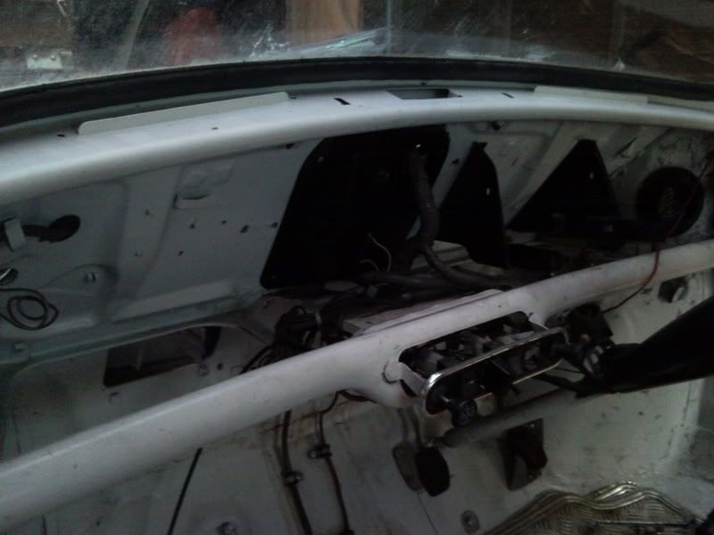

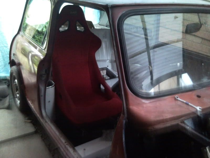

update

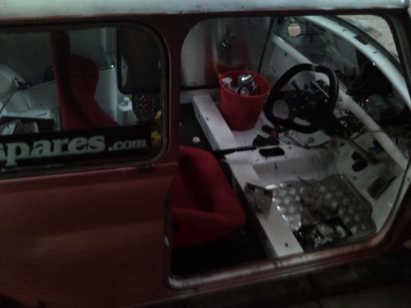

tha last couple of days i have been a little distraced with the sale of my mpi, but heres a update >_<

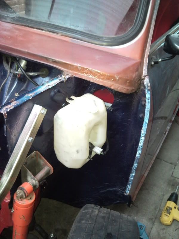

right got the both seats inplace (although passenger seat not in pic), the drivers seat is bolted down just need to drill though the carpet so i can bolt down the passenger one. (they also need a blooming good clean as they are really dirty)
got the passenger door fitted, just need to fit seal.
got some of the wireing sorted in the engine bay, and the dash area is nice and tidy.
started to swap the 2clock dash for the 3 clock but not sure if they will just plug and play as there are a few less pins on the multiplug..

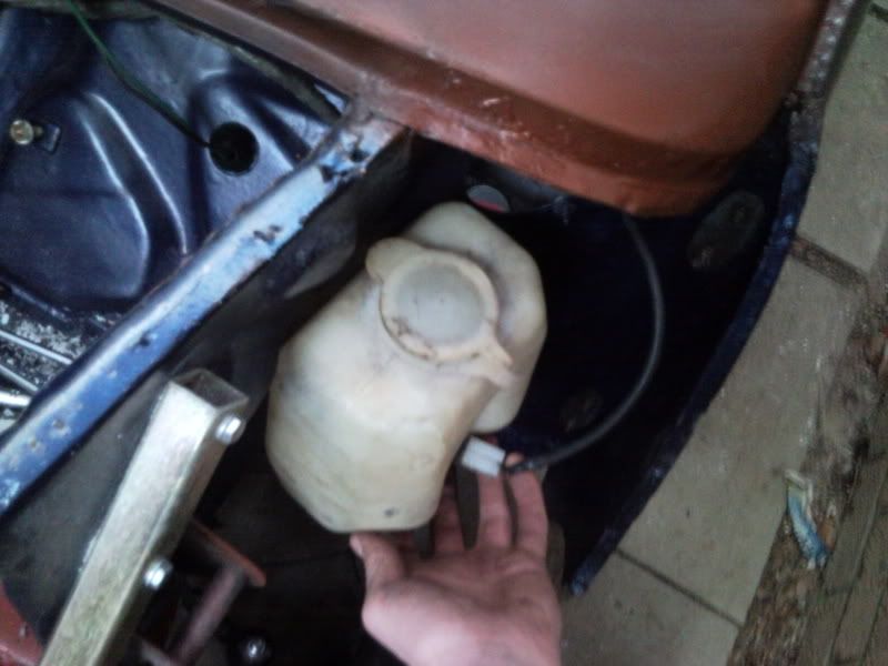

got the washer bottle placed and just need to whip up a bracket.

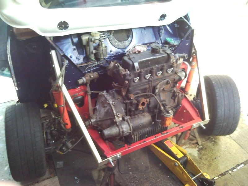

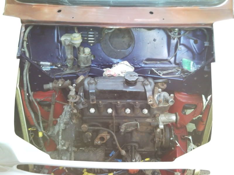

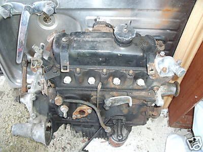

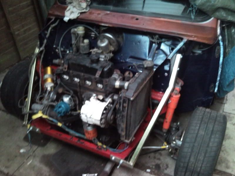

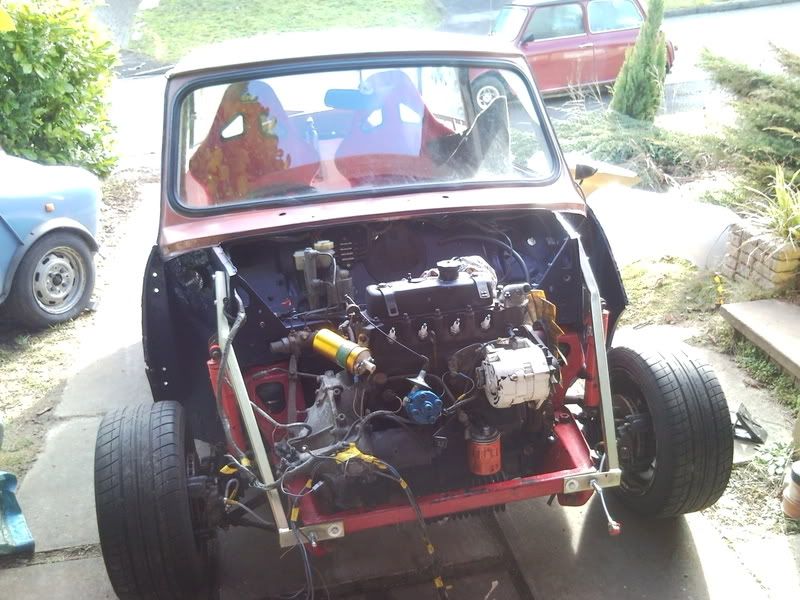

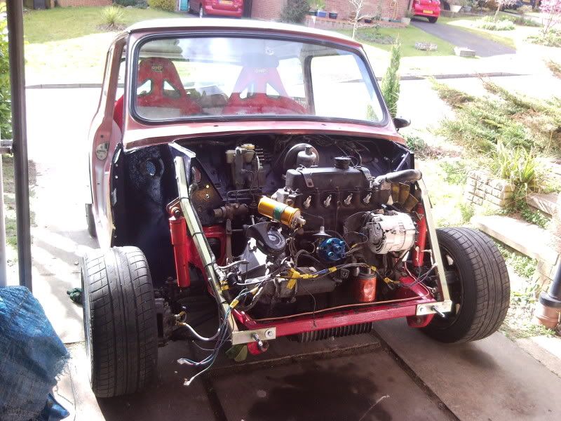

so with the lack of a complete engine, means i had been looking for a local engine complete or a replacement gearbox. a friend kindly offered a 1275 box as a loan. but i found a complete 1098 on ebay just outside of basingstoke. and won it for £50 with approx 55k miles.. :D
so i set about fitting it (just going to bung it in and see if it works as it is).. ive got the front hubs broken (with the wheels still on :D flip flops rule!) and swapping engine mounts from the old engine as they where new.
the engine also came with a carb and alternator! bargain! so i need to fit my lcb in order to fit the exhaust. which means the inlet will need the carb set-up for the 1014 swapping to the 1098 carb i was given, and fingers crossed the k&n will suit.

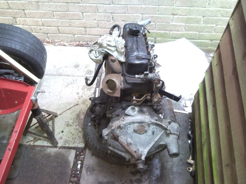

heres the engine (looks worse than it is)
only thing i need for it is a dizzy. not sure if my standard 998 one will fit, i assume they are the same.
today..
well its in and fitted! :) with alot of sweat and effort i managed to manouver the engine into place with the aid of two tyres and a deck chair ;) lol..
got the hubs fitted and driveshafts connected. and its back on all fours..
thats all for today its soooooooooo cold here!

Posted 07 February 2009 - 03:02 PM
if it is the enmgine in the earlier pics then no it will not fit as this "new" is Pre A+ and the other engine is A+ so the dizzy's are different
ok tar muchly mr boo! :) i'll have to source another one..
does the dizzy need to be a 1098 pre A + or will most pre A + dizzy's suit?

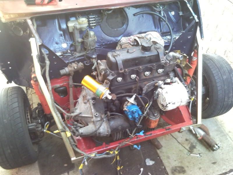

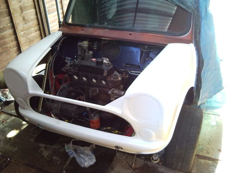

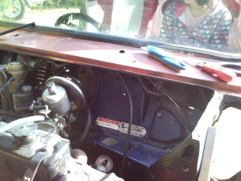

Posted 21 February 2009 - 11:07 AM

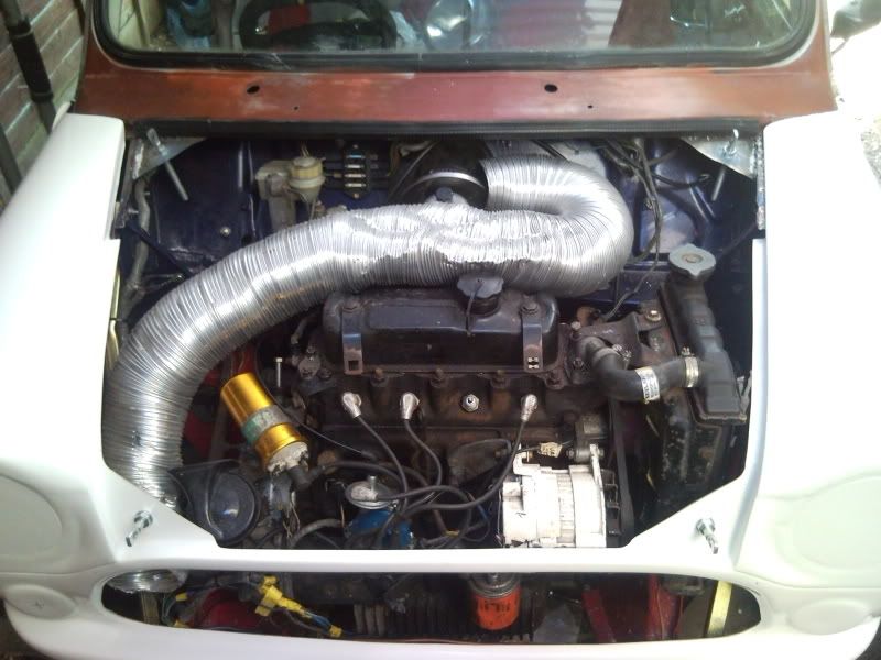

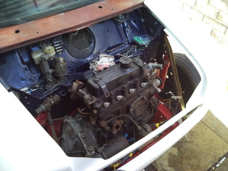

right been busy bolting bits and bobs on :wub:
alternator, belt and fan on, as well as the coil and the dizzy (thanks MiniMorley) is in..
most of the engine is wired up and the engine steady is fitted

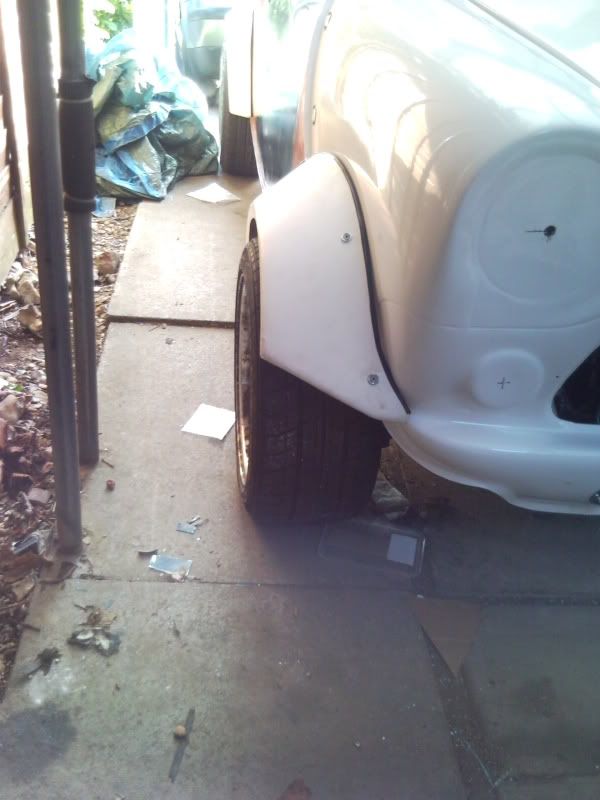

couldnt fit the radiator top bracket or ultimate steady as the 1100 thermostat housing is different :techsupport: doh!
heres the front :) phhooorahh!! arch just placed :o
also got the carb, inlet and full exhaust system fitted.
and gave the boot and boot lid a lick of paint (will need another coat), mainly to keep spray costs down.
its getting there :P :thumbsup: :thumbsup: :thumbsup:

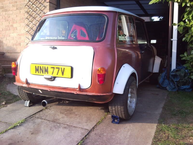

Posted 15 March 2009 - 09:00 PM

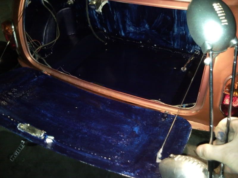

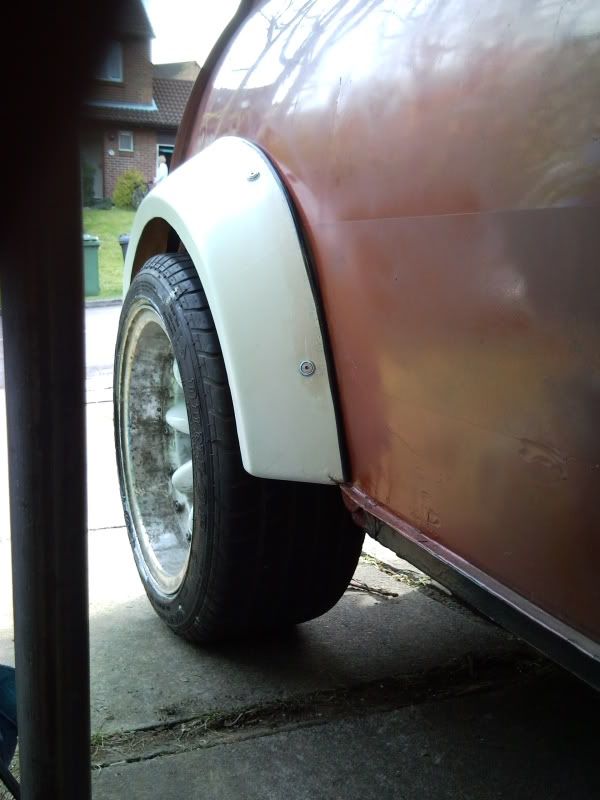

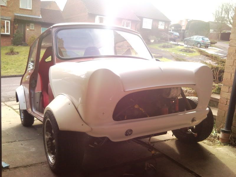

right where do i start!
sorry for the long wait :D got loads done!!

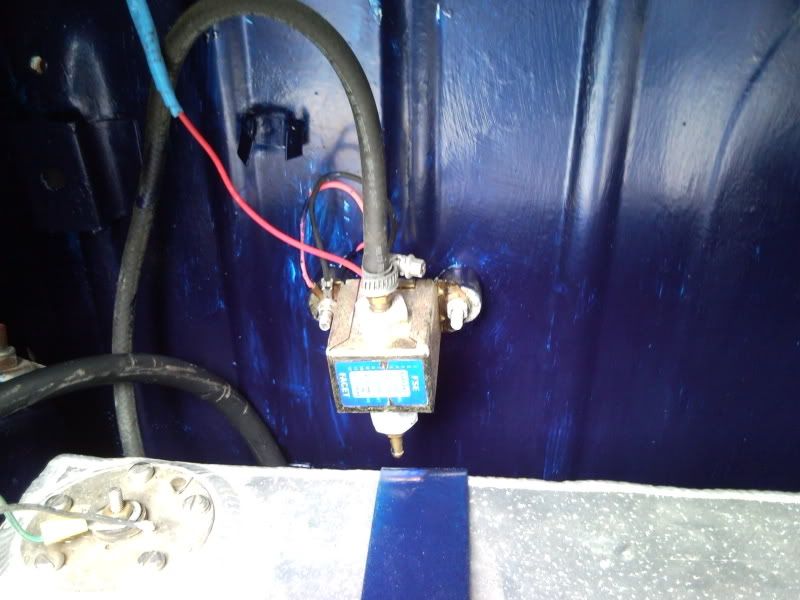

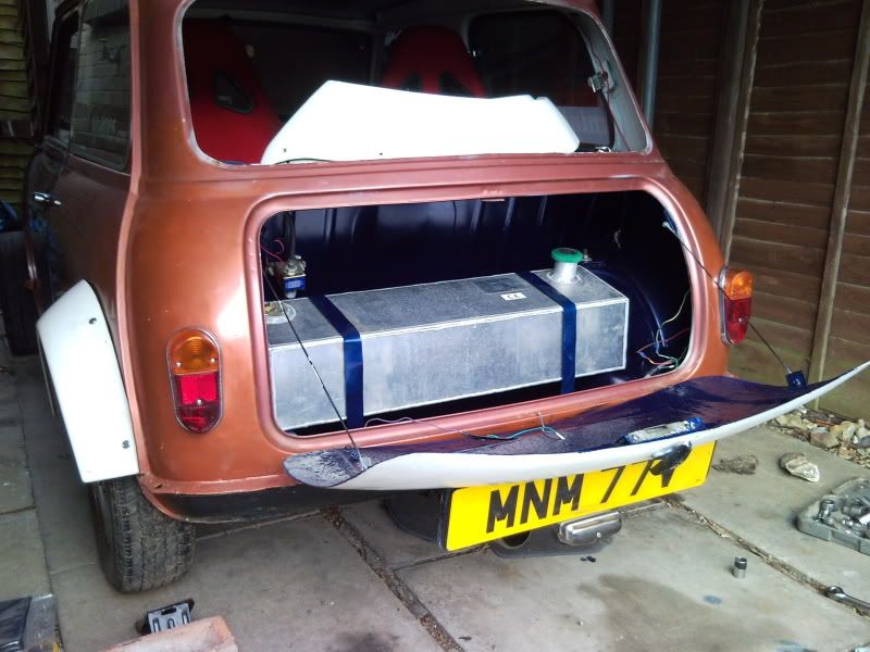

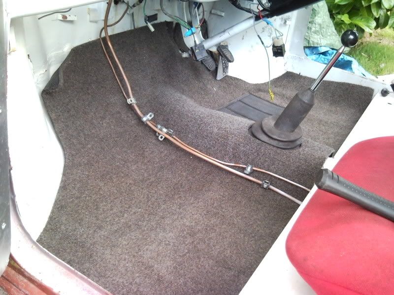

- fuel tank in and fuel lines plummed in
- front carpet in (just need to fasten down the brake and fuel lines)
- washer bottle bracket made and fitted :w00t:

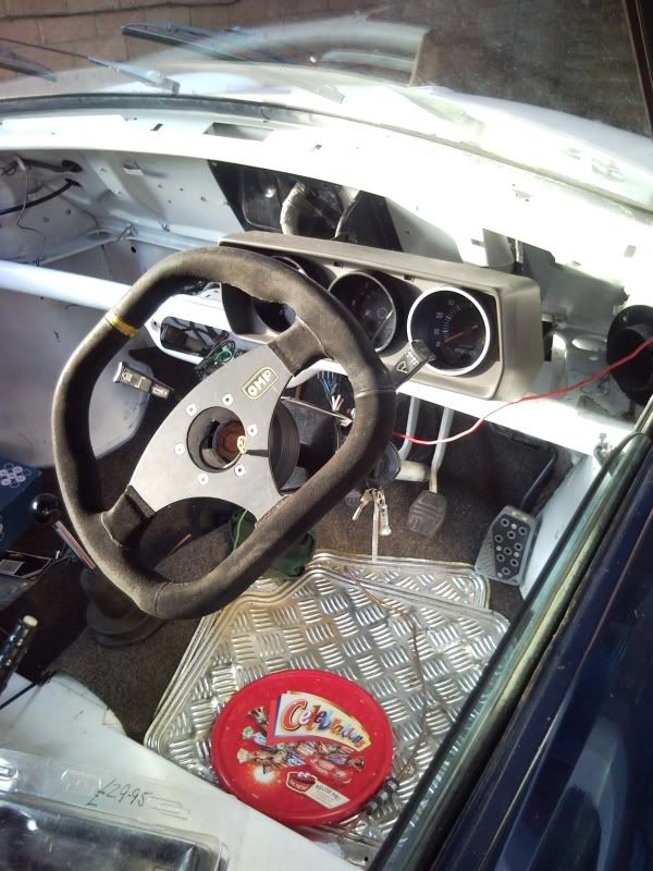

- 3 clock dash fitted and connected
- rear arch rubber trim fitted

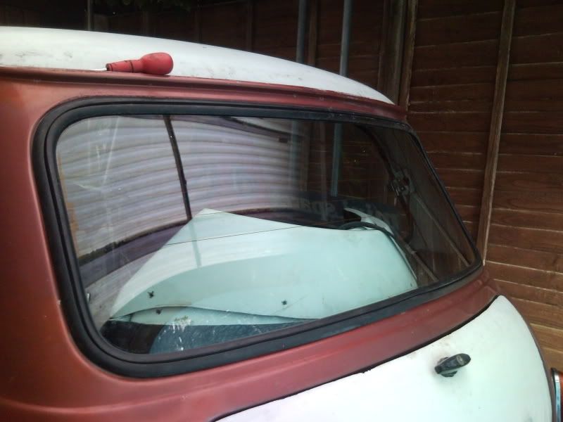

- rear window fitted (although still needs the chrome trim
- chassis plates fitted in new location ;)
- front subby brake line made and fitted, along with the brake union
- clutch slave cylinder fitted and piped up
- horn fitted in new position
- wiring loom tidied and attached to the brace bar
- bonnet pin plates welded
- flip front apanel tabs welded.
- flip front drilled and dzus fastners fitted.
- front bonnet pins fitted
- rear tyres bought and fitted (they look miles better)
getting there slowly but surely!!
just needs to be functional for the rivi run!!! ;)

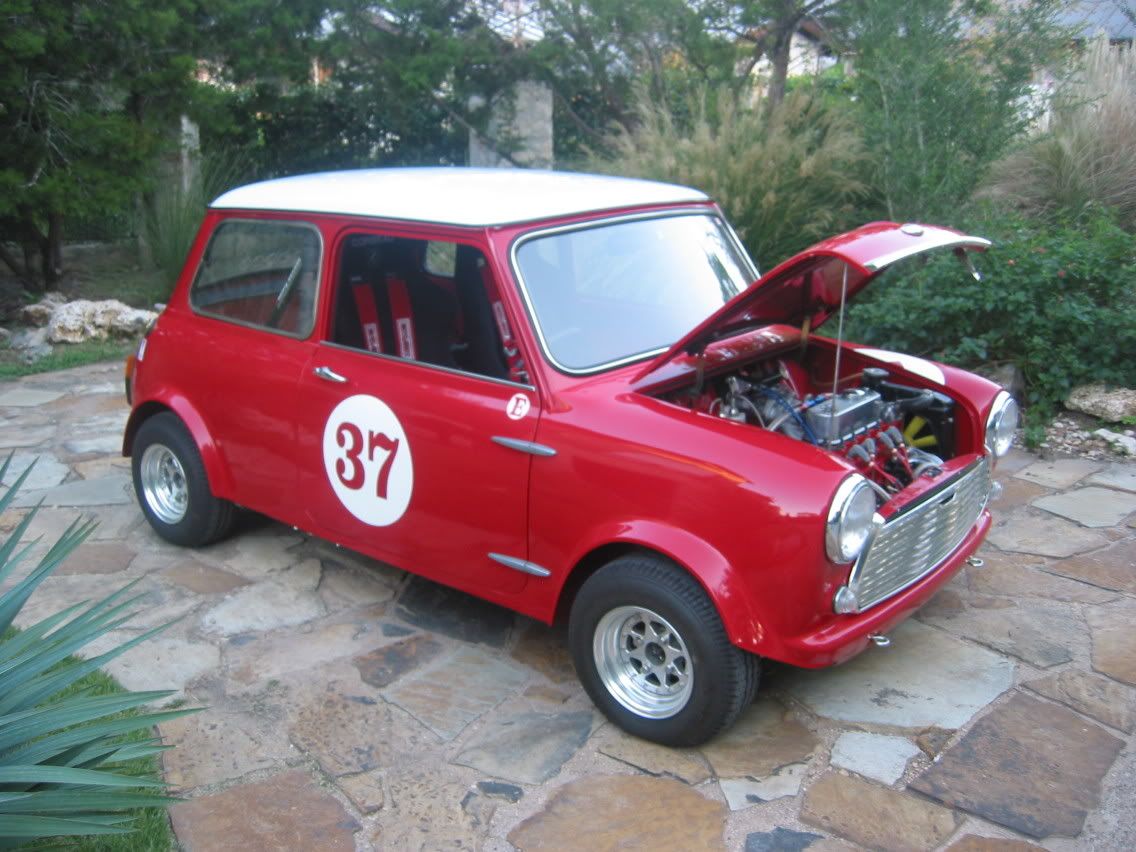

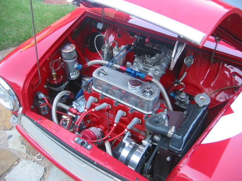

My minis is a road going, Miglia Inspired mini as well.
Goes like one too.
As you see, instead of the miglia arches, mine are steel molded in (actually welded in but molded seems to be the word everyone uses).
Next to my other project.

cool nice fuel tank!

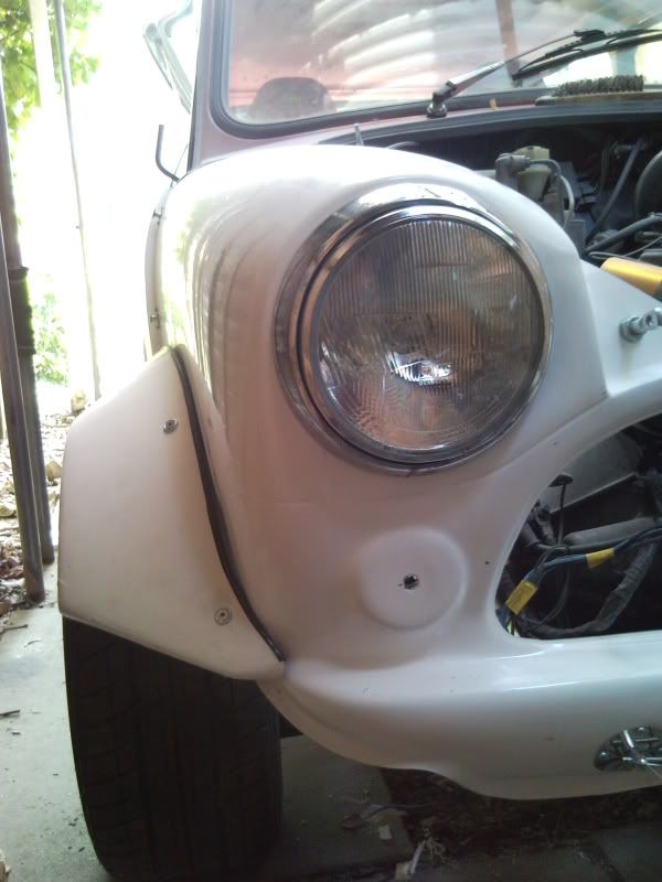

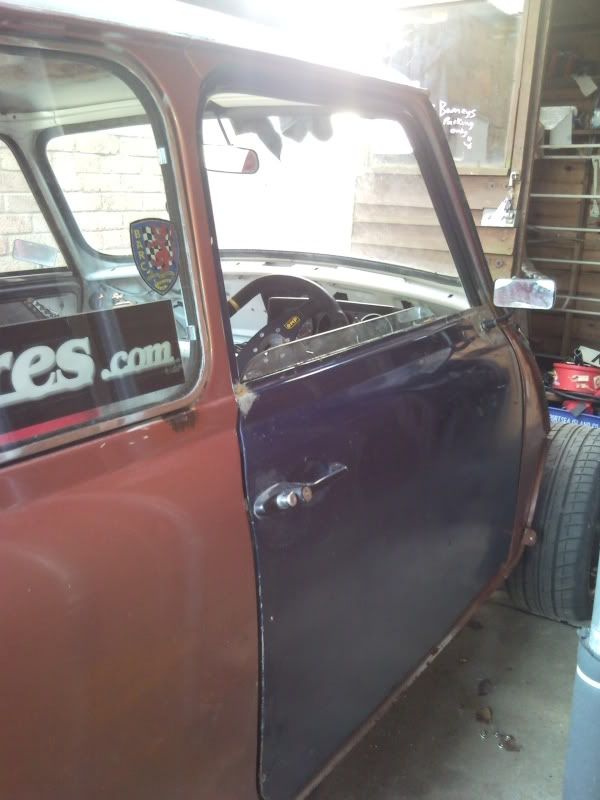

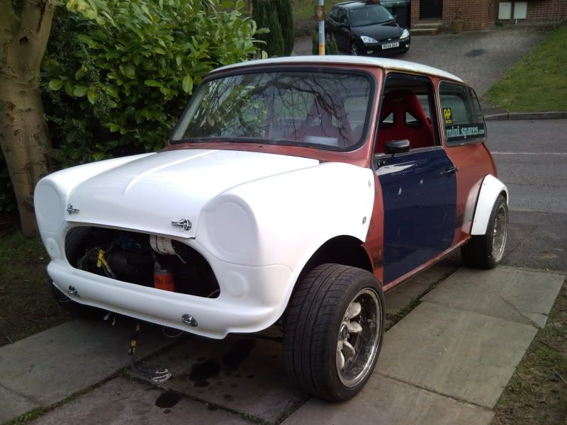

Posted 17 March 2009 - 07:51 PM

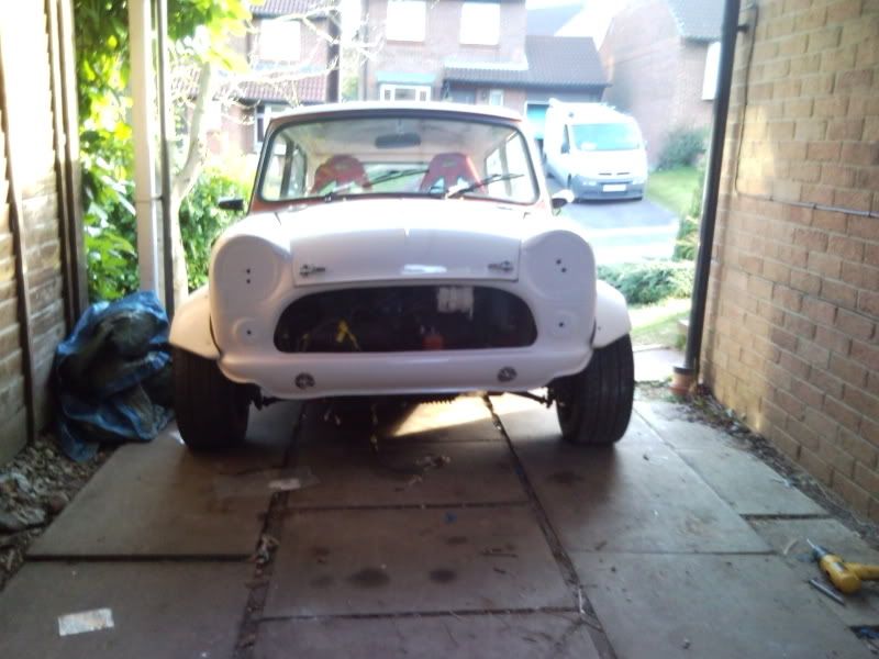

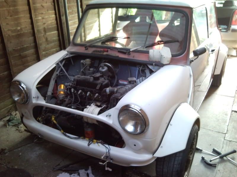

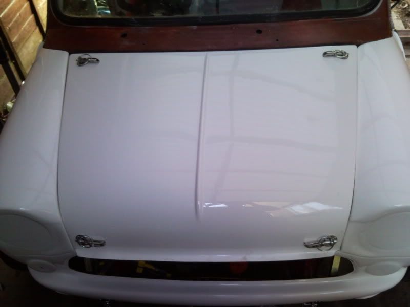

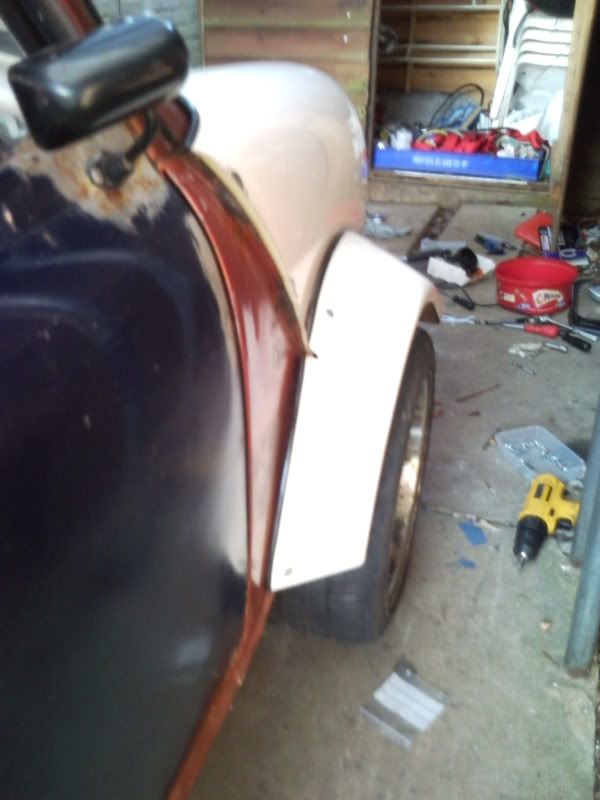

more progress ^_^

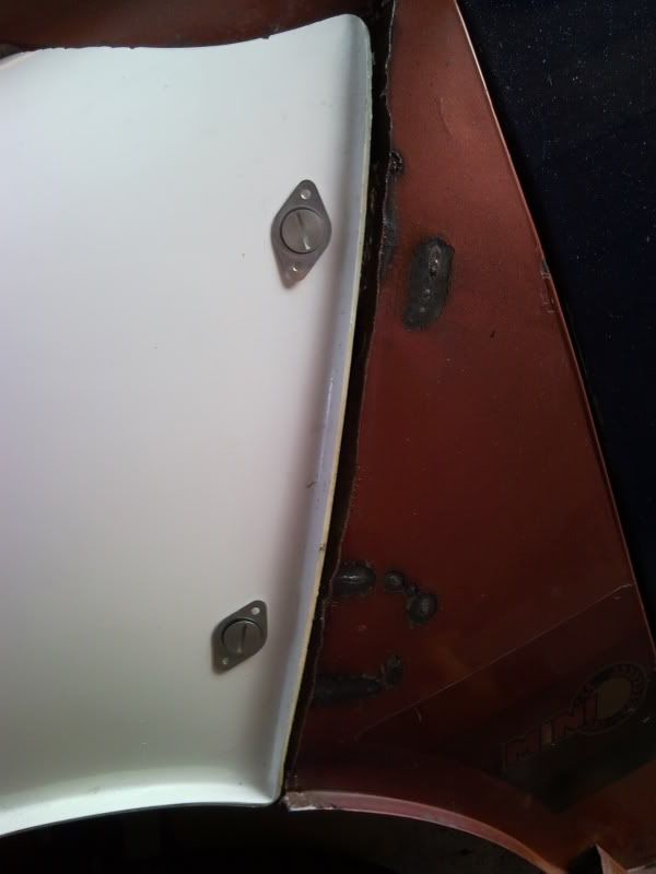

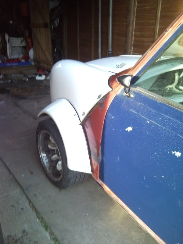

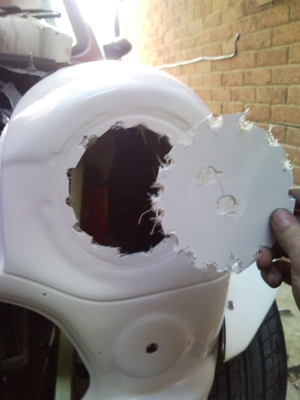

- rear bonnet pins fitted,
- rad fitted and piped up, also my air duct remolded for the new shape engine bay
- drivers door fitted

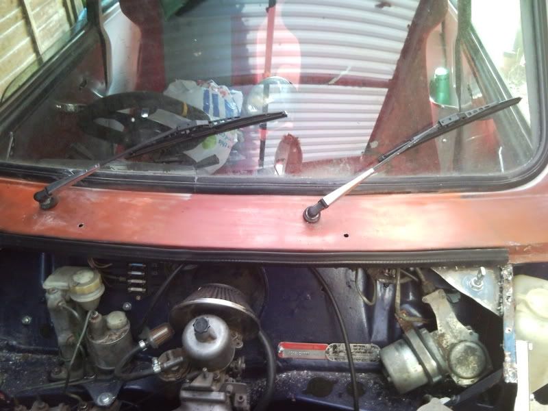

- wiper and motor fitted

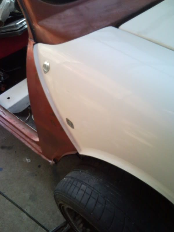

- FRONT ARCHES!!!!!! :shy: :genius: :D
- speedo pic

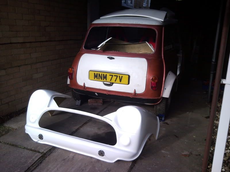

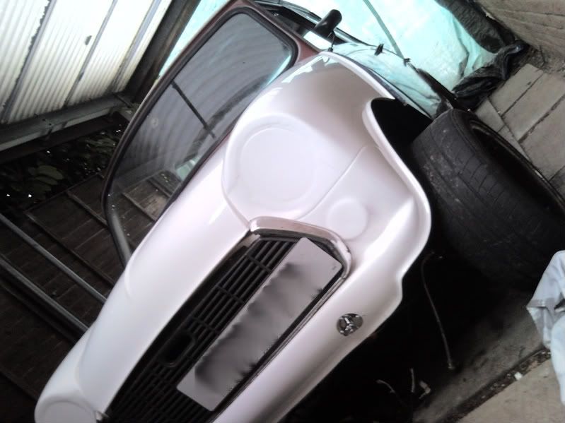

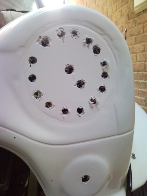

tomorrow i'll put the head lights and grill on. and i need to get some more dzus fasnters for the arch to a panel bracket. i was going to cut the arch at the seam, but i think it would be very hard to get it lined up nicely, so i will make it so the whole arch comes off with the front...
:dontgetit: ^_^

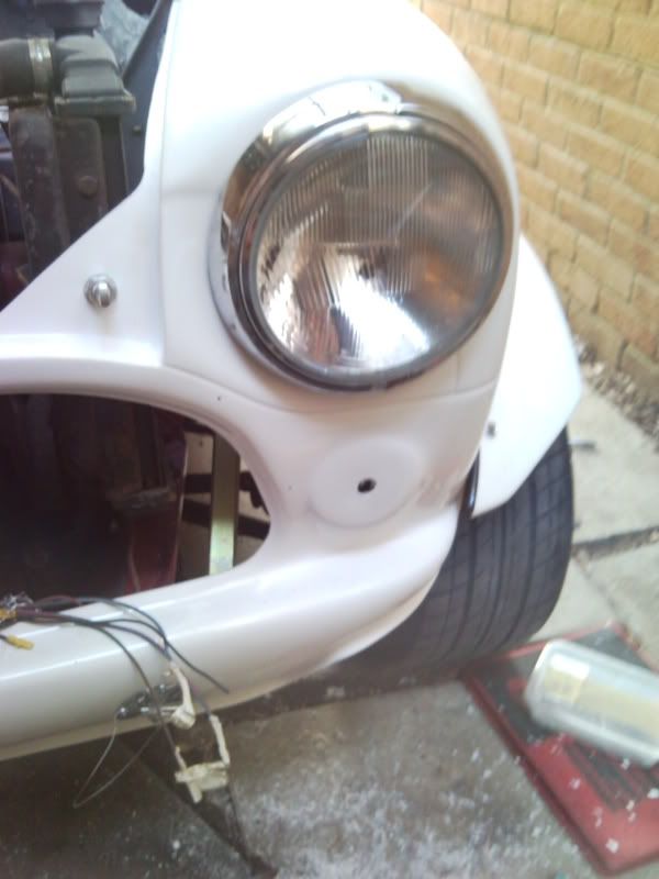

Posted 18 March 2009 - 06:38 PM

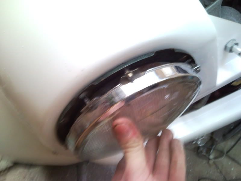

more cheese gromit??

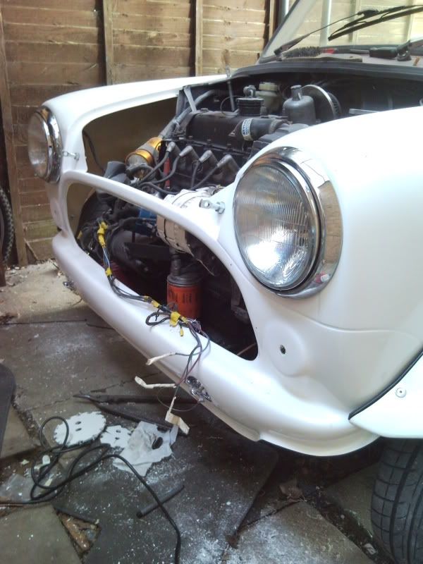

Woop!! head lights, Need to buy some self tappers and then they are done :genius:
thats all folks :D :thumbsup:

love this mini, let us know how the bearings etc hold up with those spacers on. Want to do this myself. Where did you get the steering wheel from?
