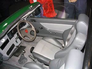

Interior of a nice factory Midas Convertible.
