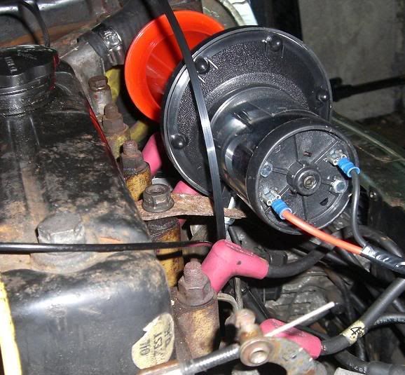

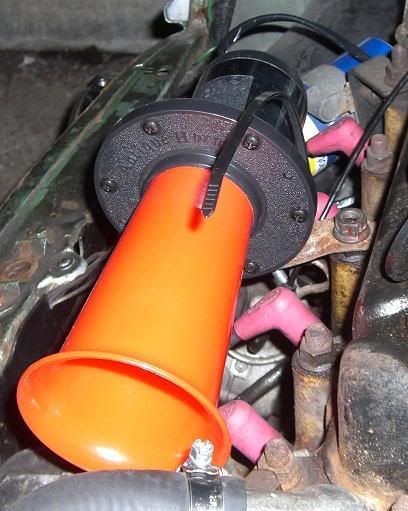

OK here is the klaxon horn - the photos just about show how it is fitted, the bracket is a door hinge bracket which was lying around in Pete's garage and it's just screwed to the cylinder head bolt and the horn :crazy:
We used a 5-pin relay to allow the horn to be on the normal button, with an extra switch on the dash to determine which horn goes off.
The cable tie is attached to the oil dipstick to make it easier to get out! The good thing about the way the horn is mounted is that it's easy to remove should I need to, to get to something underneath. Hence keeping it so simple, and the wires connecting it are long too so it will just about sit on the floor if I need to take it out :angel:
