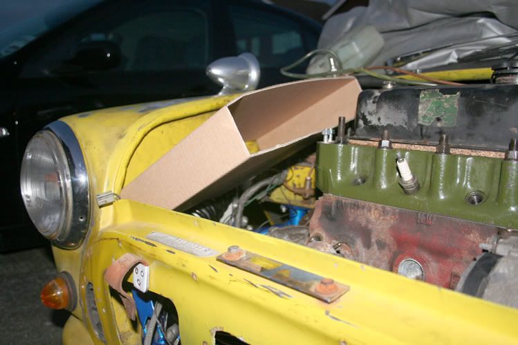

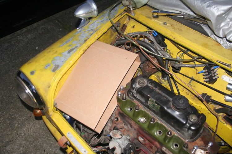

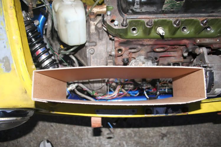

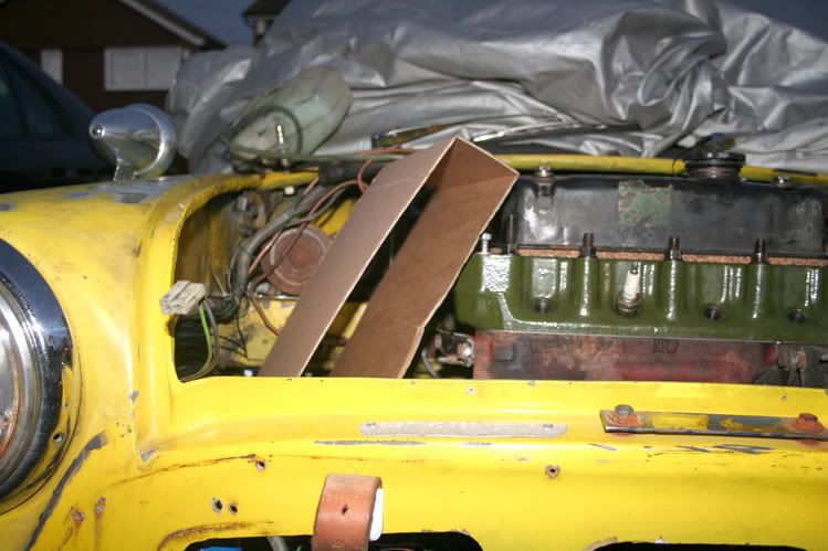

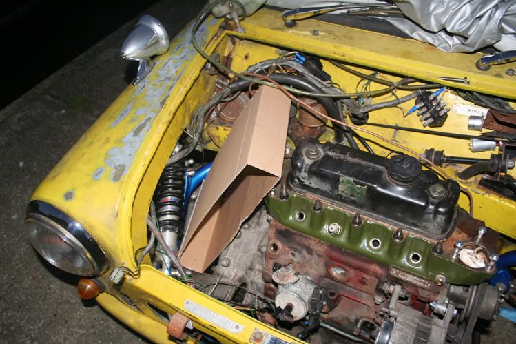

Well...
No way I could get an MPi down the front, unless I relocate the oil filter and the alternator. I couldn't put it above the starter, because then to get it under the bonnet I'd have to tilt it back and then there would be no room for a fan on either side...
(Click to enlarge)
So, then I started looking at other possibilities, namely the rad going over the clutch side...
Posted Image Posted Image Posted Image Posted Image
(Click to enlarge)
Its definitely a possibility! Theres enough room to get a fan underneath it too.
I also got one of my F3 rads, and realised it will just about fit underneath the starter motor, between the front panel and the gearbox, however I'm not sure if there is much point, as I doubt there will be much airflow, and it would require a remote oil filter...
