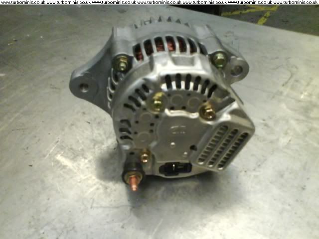

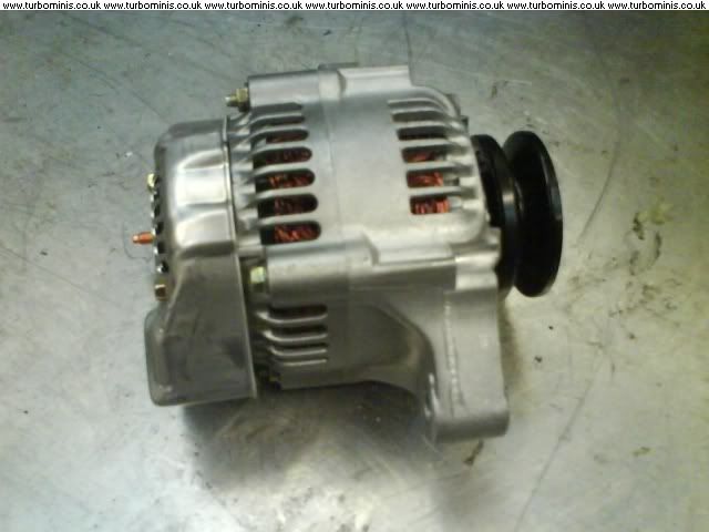

if your nippon denso alternator is the same as this go for it, they fit without much problem, and if you run a shorter belt than usaul you can keep it really close to the engine giving more room up front.
this is the one that most of the guys on TM run.

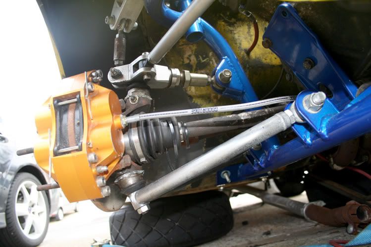

Started off by getting the hub/driveshaft assemblies out and cleaning them up a touch. Went to bolt in the balljoints to the arms and realised the thread didn't come through enough to be able to get the nut on. Then realised I had the top alloy bits on the wrong side! :D Swapped them round and the drivers side bolted in beautifully, a lot easier than with normal Mini suspension.

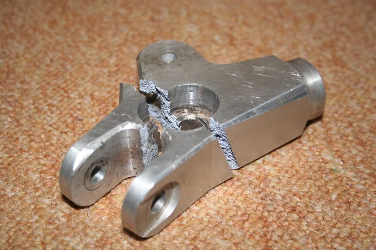

However, when I came to bolt in the passenger side assembley, due to the camber I could get the bottom balljoint pin into the hole. Therefore I had to take the top alloy bit off this side, and try and loosen off the top arm pin so I could knock off the camber. A little heat and it was loose. Unfortunately this must have weakend the alloy bit, as when I came to torque up the top balljoint nut, the taper must have caused the alloy bit to split into three. :thumbsup: So now I'll have to get a replacement from Z Cars!

Brake hose looking a little "out of its reach" there?
Is that correct?
#478 Jammy
Jammy
  • 25,397 posts
Posted 21 March 2008 - 08:18 PM
The brake hoses aren't plumbed in yet. There isn't any provisions for bolting the front brake hoses to the subframe, so thats another thing I've got to work out!
