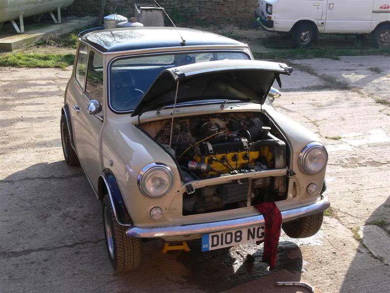

And.. I've got no oil pressure :P
#468 *DJH*
*DJH*
  • 4,972 posts
  • Location: East Anglia
Posted 17 February 2008 - 05:17 PM
It's bright green, so I'm guessing its just oil.
well if it as a 'rainbow' effect then it is just oil
oh dear, i had that on engine no2 and that went :xxx: but as long as you don't drive it, it won't need replacing, just replacing some parts.
#469 Bean
Bean
  • 8,054 posts
  • Name: Jean
  • Location: Malvern
Posted 17 February 2008 - 05:25 PM
I don't want to drive it at the mo, anyway - because i've got a worn subby mount, I think - so there's nice clunks coming by my feet!
GRRR!!
i think the oil is coming from the timing cover
#470 *DJH*
*DJH*
  • 4,972 posts
Posted 17 February 2008 - 05:39 PM
GRRR!!
yeah that'll probably be the rubber mount that bolt through the firewall/floor pan. only a ten minute job to change, and only costs a few quid.
yeah that woud make sence if it's coming from the right hand side of the engine.
#471 Bean
Bean
  • 8,054 posts
  • Name: Jean
  • Location: Malvern
Posted 18 February 2008 - 03:20 PM
Well, it IS the timing cover :wub:
So... Radiator out :(
#472 *DJH*
*DJH*
  • 4,972 posts
Posted 18 February 2008 - 05:17 PM
oh dear :) i think you need to get the crank pulley off to in order to change the gasket >_<

I dunno when I've got time to do it. I think it's gonna have to be Saturday >_<
But Wednesday, Reggie's gotta be up at the bodyshop, as he's having the crack in the paint looked at. I'm gonna see if they'll come down to my house, as I'm just round the corner (They said that would when I'm ready for them to take a look at Ronnie, anyway).
If not, god knows!! I'm not gonna risk driving him at the mo.. even though he NEEDS to go on a run, so I can check the oil pressure.
But to be honest, I'm really nervous about taking him anywhere :) As I don't want the oil pressure to hit 0 again :P

thing is tho - he would only lose pressure once he'd been on a run, and then the revs drop and the pressure would plummet.
He was sitting on mikes drive idling OK and when i took him for a quick spin, the pressure was fine... but it was just on the way home after travelling at 55mph ish. At 55 mph, I've got decent pressure... but then when i slow for junctions etc, he dies. Every single time.
