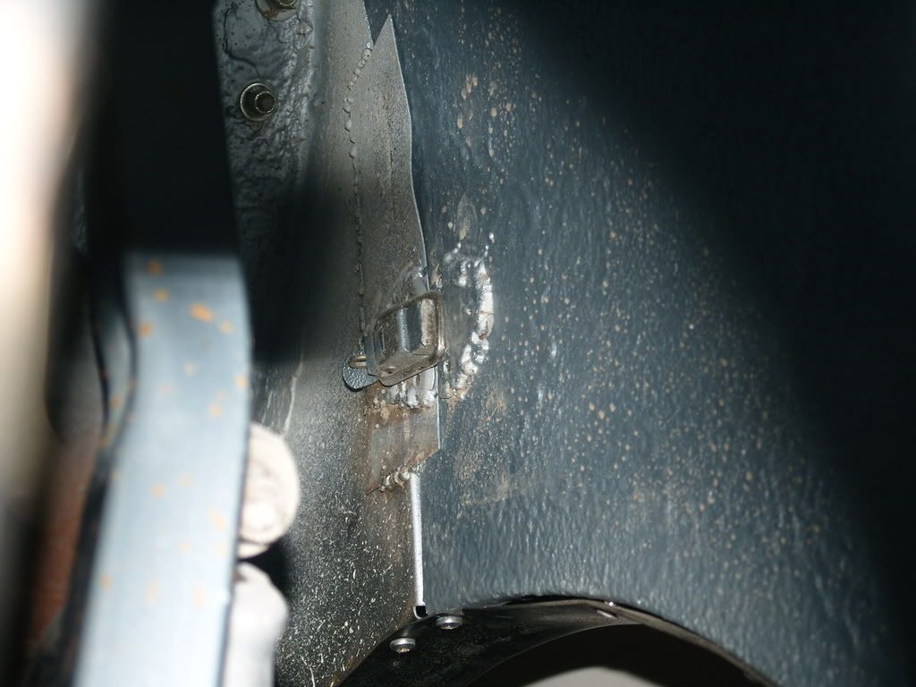

i think those are the best pics i have of the arches cut.
and yep, just cut with tin-snips and bend out over with grips

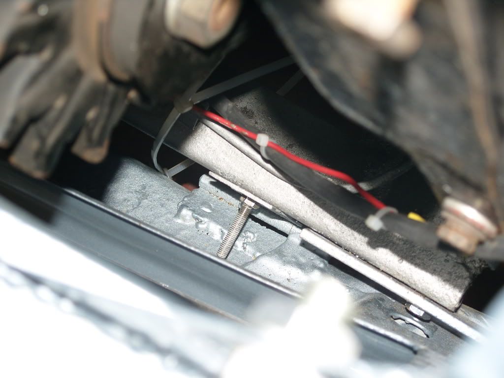

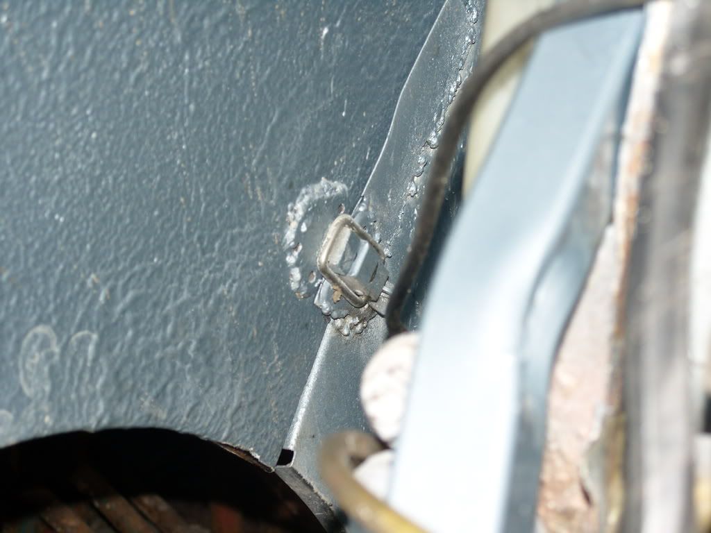

ive got you a pic of the brackets used to 'flip' the front but they arent very good
beneath the bolt, you can see a weld ? that weld is holding the short part of the gate hinge to the front panel. the long bit after the joint is the bit the bolt goes through and holds it to the subframe
hinges were just like these at the top http://www.fencing-a...357_general.jpg

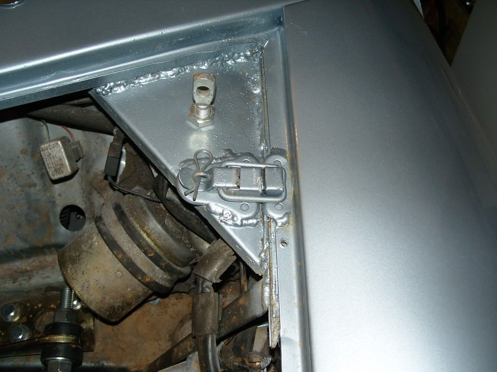

then to hold the wings in we used these little latches
and same again between the wings and a panels
quick lash of paint and a few fancy bits and you end up with this
if you want a little guide of how the front was all marked out and lined up and what stages things were done at, just let me know and il write one up

Posted 12 June 2008 - 08:33 PM
one on the left aint bolted up tight but you get the idea
