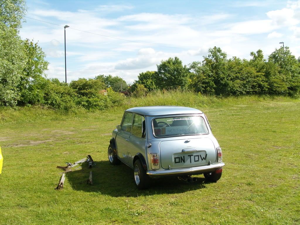

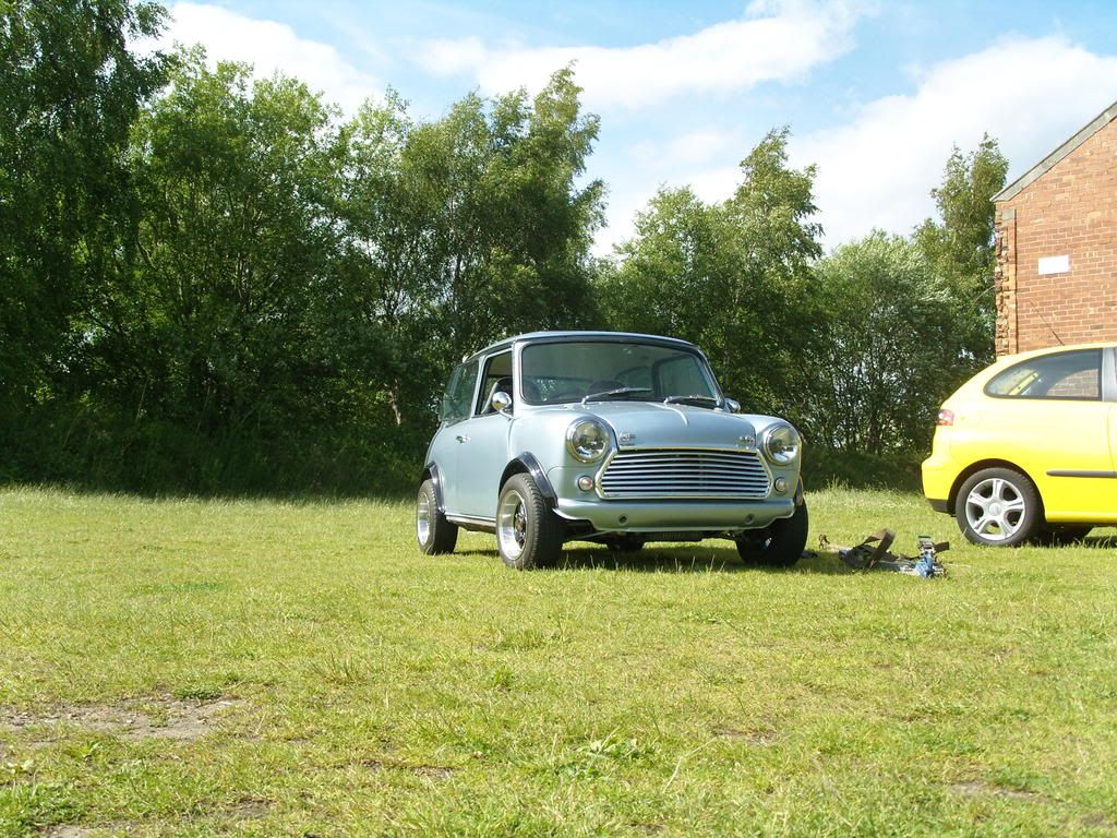

Tuktuk driving the mini other night. Cant get speed due to the damp grass, it just wheel spins as the cam comes on
Jordie
#217 tuktuk
tuktuk
  • 1,231 posts
Posted 01 July 2008 - 07:58 PM
haha, yeh as soon as my foot hit the floor the wheels went off on one...
and man i look like a tramp there lol, suppose thats what you get from a weekend away camping with flooded toilets ^_^
