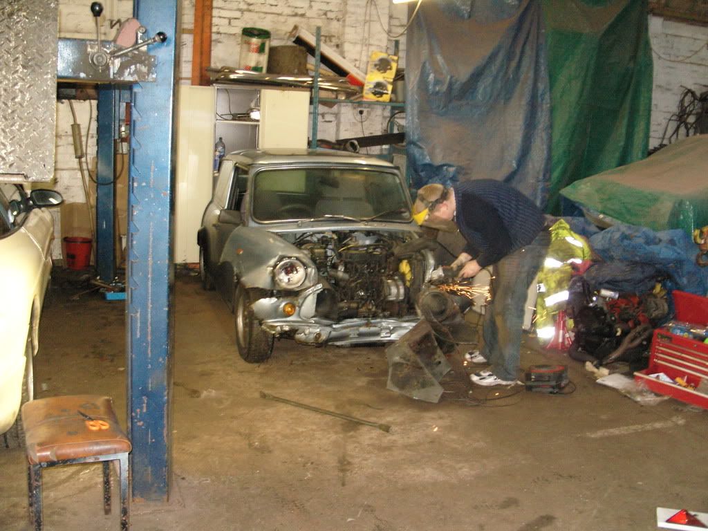

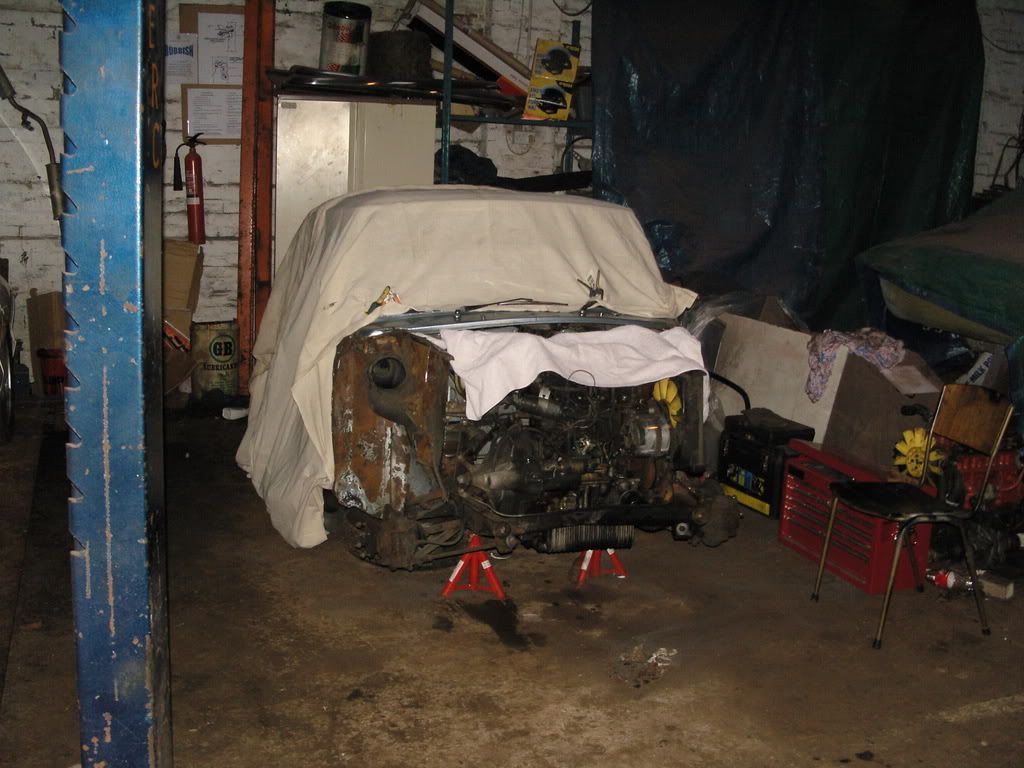

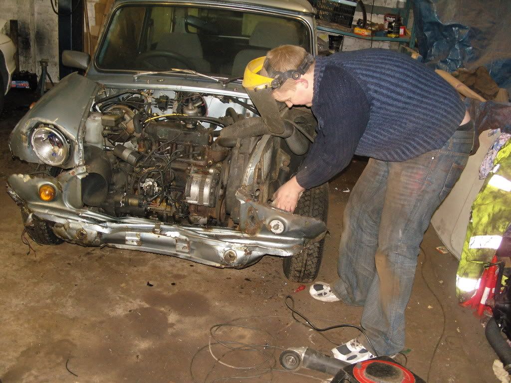

today me and jordie made massive progress :thumbsup:
we took it away to the restoration club where jordie attacked it with a noisy tool
he made it look like this :D

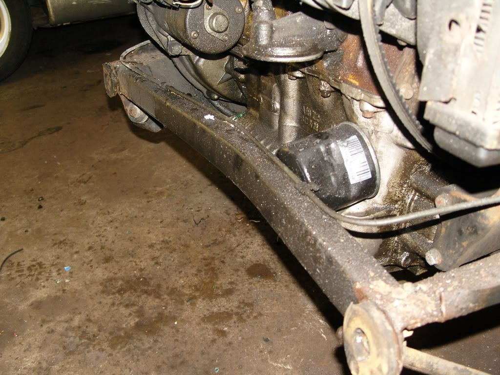

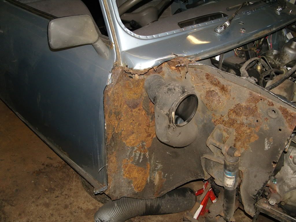

we then assesed the damage from the crash...
the above being the worst. i expected alot more to be wrong than we found.

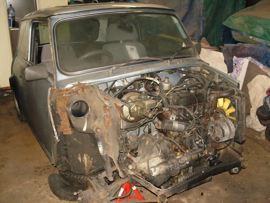

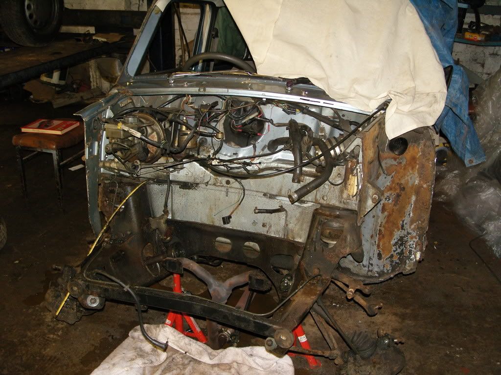

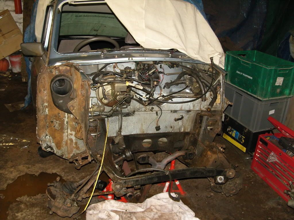

cut away the A panels

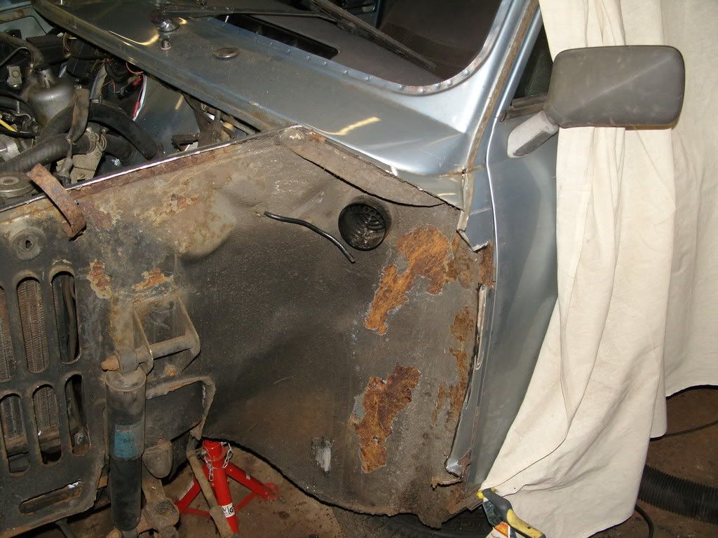

then away went the inner wing, followed by chipping sanding away the inner arch bit

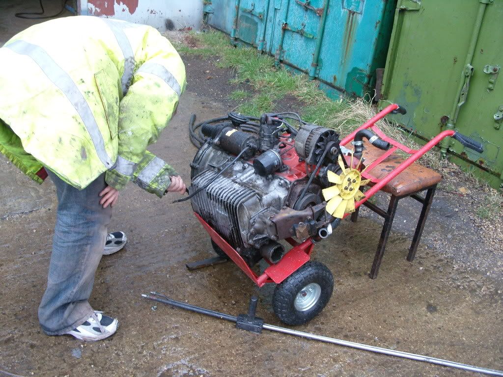

meanwhile, jordie steamcleaned the new engine

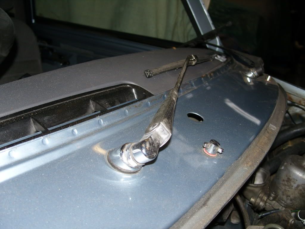

took out the windscreen and found a perfect scuttle
anyone tell me what this is ?

so whats the diagnosis with the subframe and its mounting points, is all intact?

#38 tuktuk
tuktuk
  • 1,231 posts
Posted 04 February 2008 - 12:37 PM

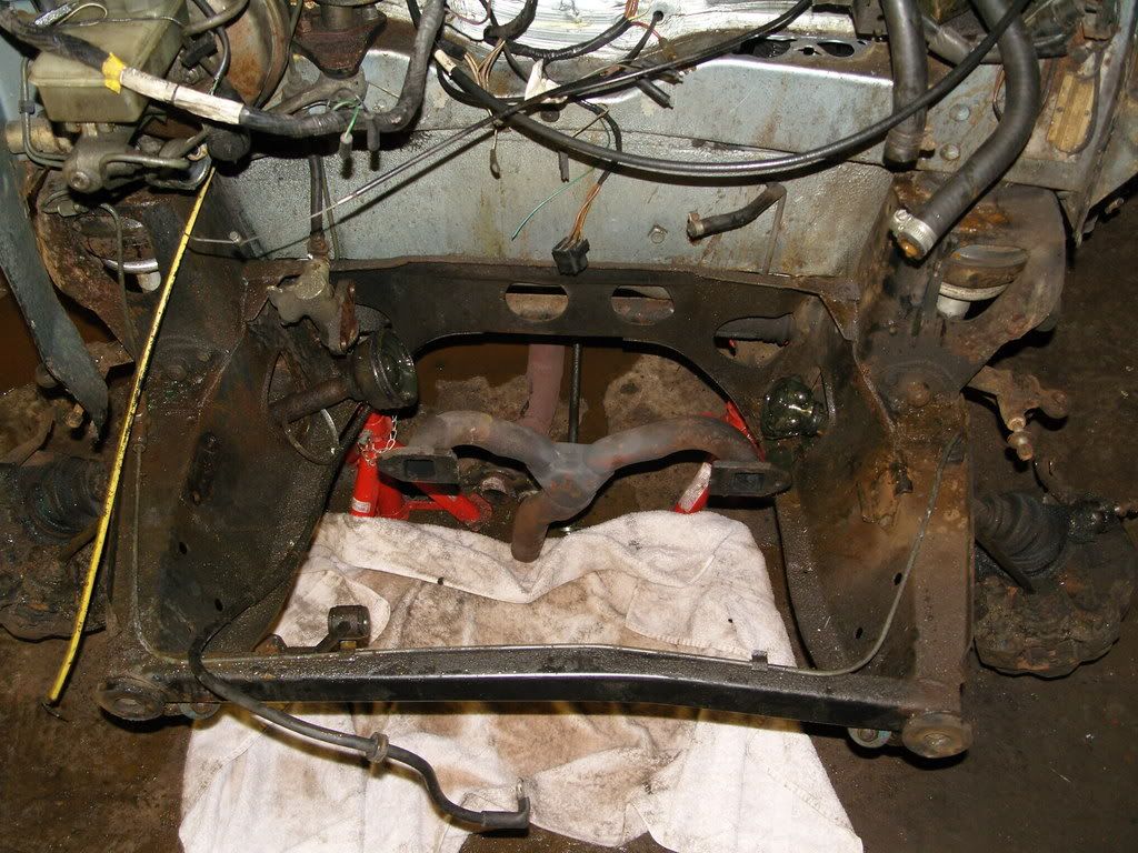

subby and mounting points all seem fine so far exept the very front bit bent in the piccy... thats gonna be streightened out after the engine is out (tuesday) ;D
i expected ALOT worse to be honest :w00t: i expect all will be revealed when the engine is out and we can properly check things :cry:
#39 charlie_the_miniboy
charlie_the_miniboy
  • 314 posts
  • Local Club: ipswich maniacs mini club
Posted 04 February 2008 - 08:24 PM
subby and mounting points all seem fine so far exept the very front bit bent in the piccy... thats gonna be streightened out after the engine is out (tuesday) >_<
i expected ALOT worse to be honest :lol: i expect all will be revealed when the engine is out and we can properly check things :blink:
if i was you i'd bin the subby and get another and that thing you was asking about it's for the headligths the dim-dip, if say you had angel eye headlights u unplug the plug on that thing and side lights are then only the little bulb not the main head light on dimly.... SO KEEP IT!!

And on what basis do you say bin it?
The subframe is only slightly bent, the tie bars are straight and the mounting points line up. We can easily bend it back. Insurance assessor said it was repairable.

Engine is all undo except the driveshafts need splitting and the gearlinkage undoing. It was too cold and dark to do it last night laid on the floor.

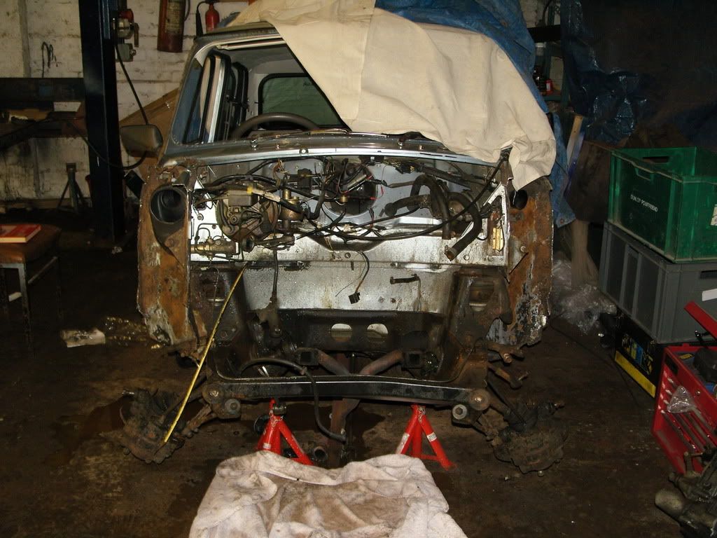

Posted 08 February 2008 - 08:26 AM
engine now out...
going for panels tomorrow morning :P

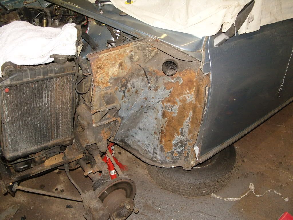

Cut the scuttle corner off and steve examined the rust/damage.
Forgot to take any pictures when we packed up, but basically the flitch panel repair section has been cut to shape and is resting in place. Tom and steve used the rolling machine thing to put a lip on the edge of the metal, so the panel joggles in behind the old panel for a better weld.
