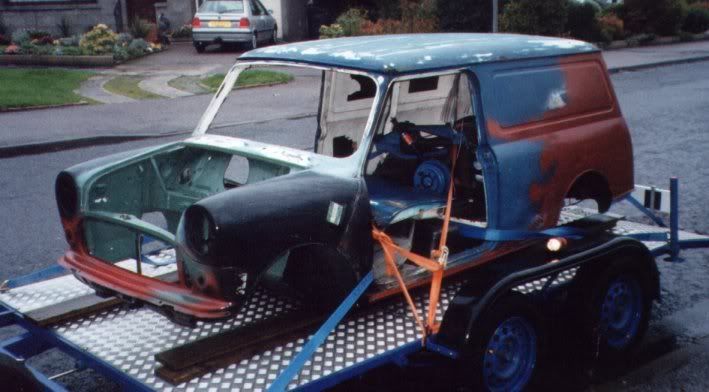

Argh dave,
Found your thread at last.
thougth I would post up here something that you'll remember from when you lived where the steering wheel is on the other side......
Can you believe that this photo was taken in 2001....this was one of 2 that we bought.
this is the one I still have int eh garage (under the stock of parts)
This is my latest project. 1962
