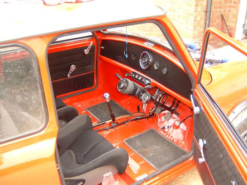

I'd rather go flush, with the MK1 set up I'd still have room for a few switches, but my dashboard plan is similar to this..
So any switches that didn't fit I can mount in there, with the rally style letters underneath for each switch. I also want to loose the switch panel for the fog light.. so that can go up there as well with the rest, also need an additional switch for a reverse light as I'm converting to MK1 rear lights.

Good work mate
that orange car is lush by the way, whose is it?
and do i see a turbo? lol

It's Nics over on Turbo Minis, not sure what he's running now.. that's an old picture, but it's gorgeous, and red :D

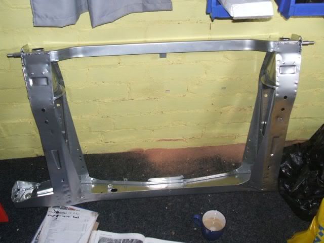

Mental day today, only just got the chance to update this as I had to get quickly cleaned up and fed before my shift so I didn't have the time for a good write up.
Dad told me we can pop into Long Eaton early tomorrow morning to drop the bits off for shot blasting & powder-coating, so today I had to work hard and crack on, get all the bits ready. Didn't have much to do but I was constantly running into problems, main one being the support pins in the rear sub-frame mounts..
Just couldn't get these out, spent hours and hours trying, in the end I rang up John Whiteman, the place I'm taking the bits tomorrow morning and asked if he had any tools there in which I could get this bloody thing out, some sort of small dremel or a cutter small enough to get into the gap to cut the bolt off.. he said they've got a flame torch, job done I hope! (i've made a proper mash up of it)
Oh and I knocked the lower suspension arms out, easy when you know how!
Stripped down the rear brakes so I could get the backplates done, with the help of a table mounted vice for the brake adjuster!
By the time I'd finished my hands were just black all over, sign of a good days work :)
Box of assorted bits for tomorrow, will lay them out tomorrow and take note of each bit. Just to make sure I get everything back.
& the sub-frames.
