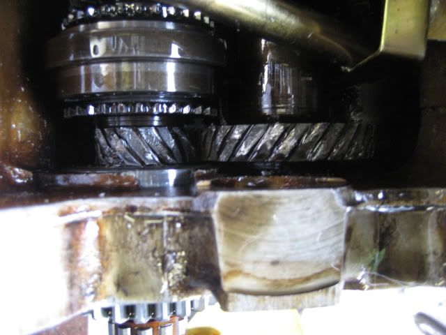

Ok.... that went well.....
Pulled the engine out the car this afternoon, dropped the box off and found this:
Yep, the teeth on the input gear and the laygear are destroyed, the laygear is actually smooth with hardly any teeth left!
The explosion has left a hair line crack in the case aswell, so the box is only good for spares now.
Also it looks like metal fragments have flicked up it the crank & bores, so for good measure im stripping the engine down and inspecting. There are a few dinks in the crank where the teeth have hit it but nothing major, I'll just file them smooth.

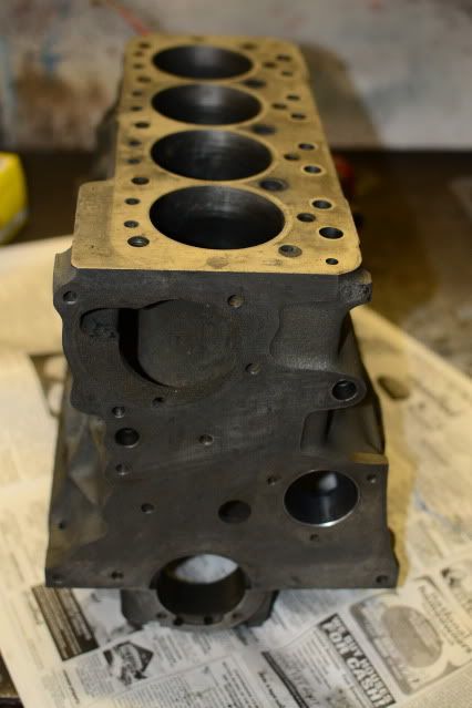

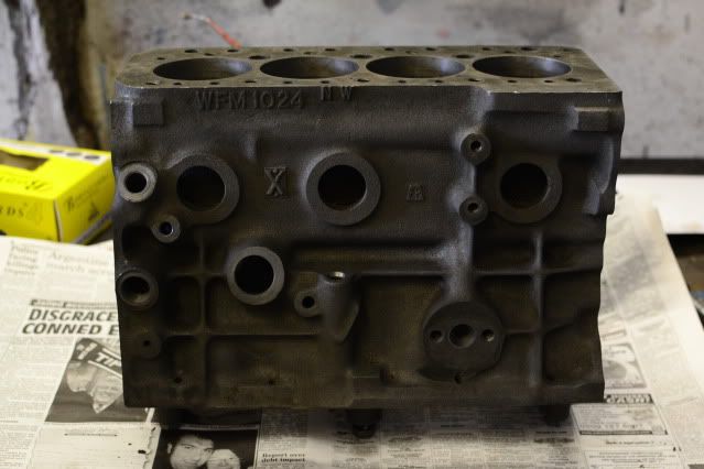

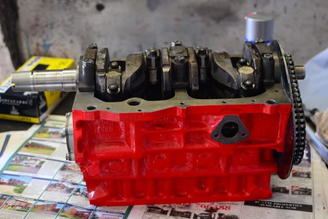

On further inspection of the engine, I notcied the explosion had left metal shards in the bottom end, so the only thing to do was to completly strip the engine and rebuild.
After stripping the engine, it looked like that there had been some contamination of the oil and the bearing shells where badly scored in some places. This meant that the crank had to be re-ground again down to 20/20.

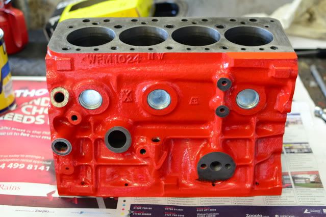

The block was sent into the machinists along with the crank. The crank was re-ground and the block had the cam bearings and oil gallery plugs removed, I removed the core plugs. Then I sent the block in to have it acid dipped. I wanted to make sure there was no metal fragments left in the gallerys.
I got the block back from acid dipping, had the cam bearings fitted, painted it, installed the core plugs and oil gallery plugs, and then it was ready to build!
Thats where I am up to today anyway.
Pics.

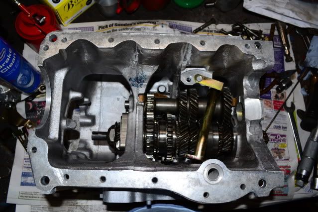

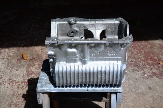

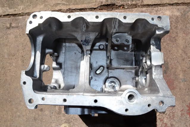

Managed to get a replacement box, and over the last few weekends ive been stripping and cleaning and getting it ready to build.
Finally made a start on building it this afternoon. Heres a few pics for now.
