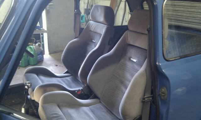

Interior wise, Ive fitted my recaros and I might fit my MPI dash next weekend.

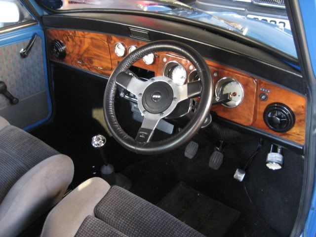

MPI Dash (inc. rat look style oil pressure gauge).
Recaros.
Only things left I want to do are. Get the interior re-trimmed. Fit negative camber bottom arms and adjustable tie rods to the front, to sharpen it up a little. Main thing is I just want to enjoy it, engines running really well, I haven't had it dyno'd yet but thats a job for first thing next year.
