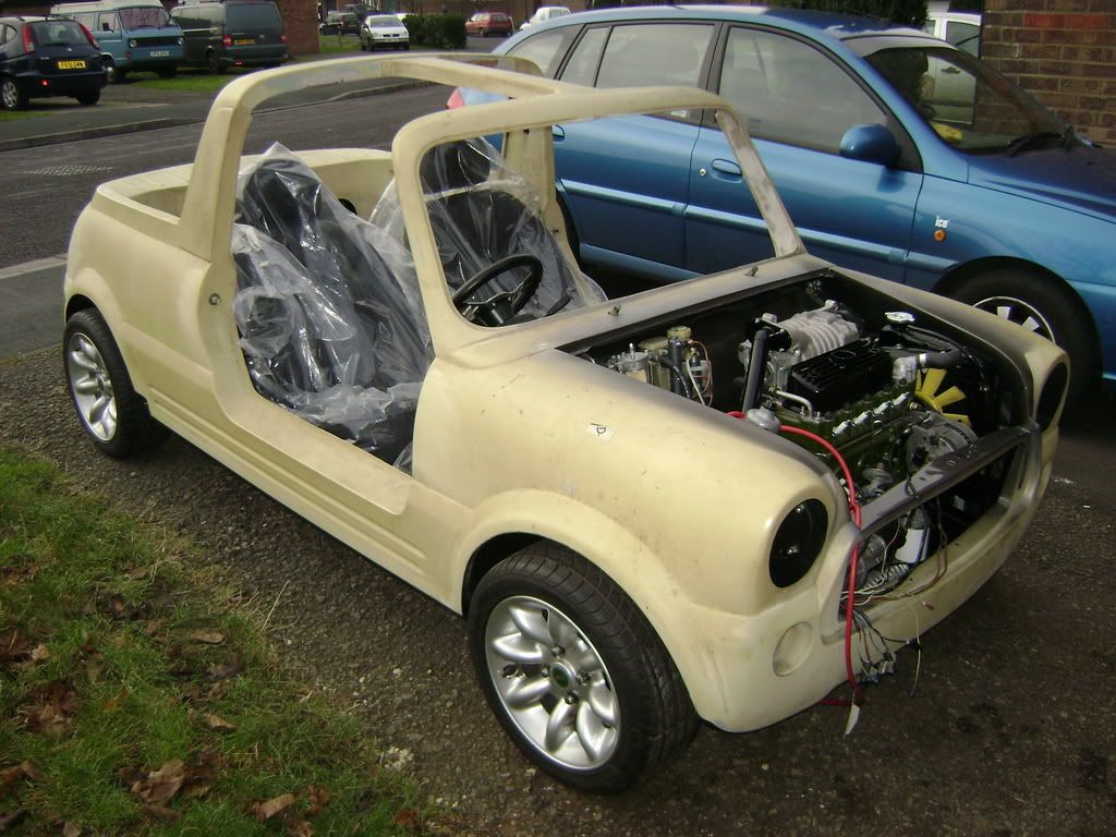

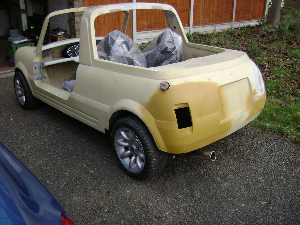

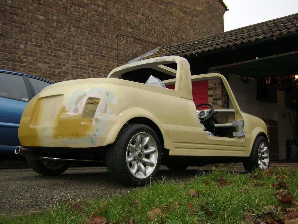

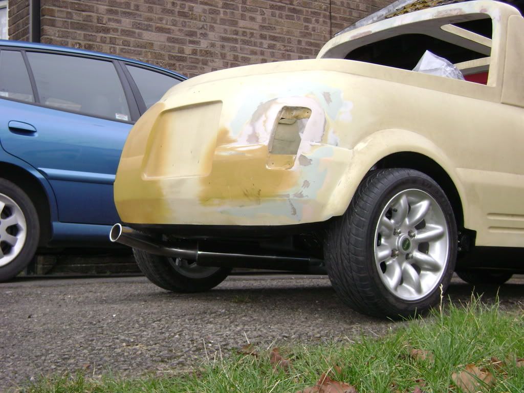

not a great deal to report, but I rolled her out into the daylight. here are some pictures for you to enjoy yourselves........

That looks fantastic!

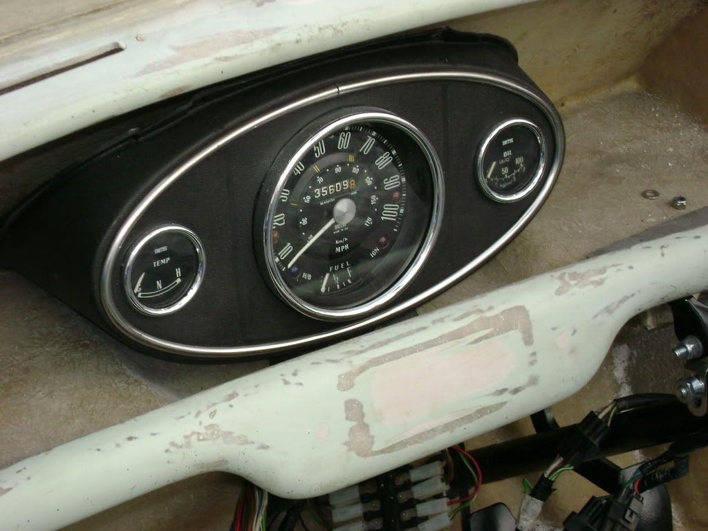

Thats what i want to see aswell, good choice on keeping the binnicle :wub:

Hi, thanks for your comment about the centre speedo, I think it looks rather cool im trying to keep as many mini features as possible, so once again thanks for all of your comments keep them coming.

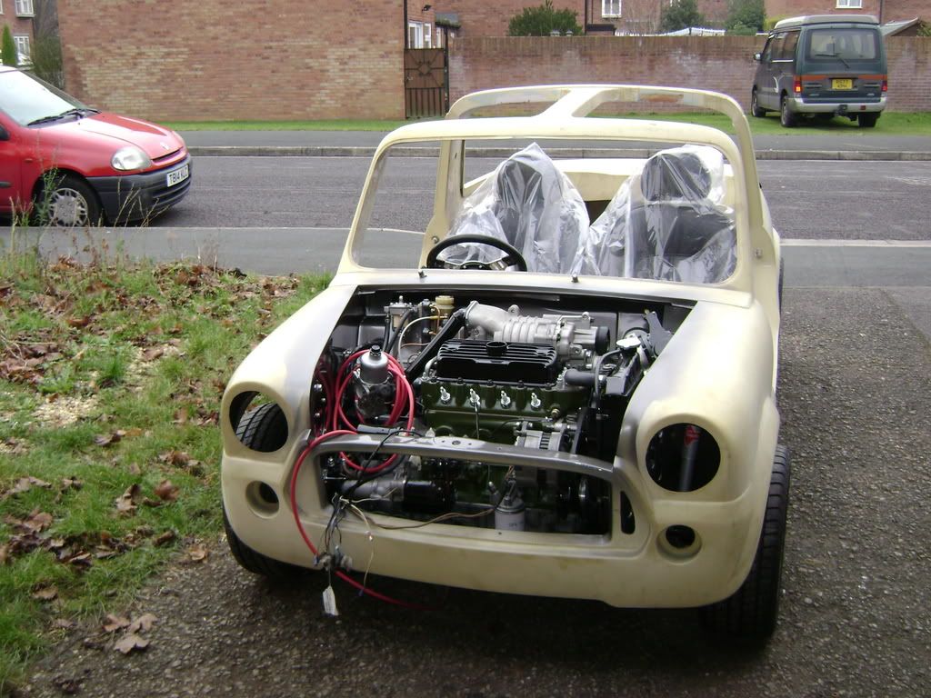

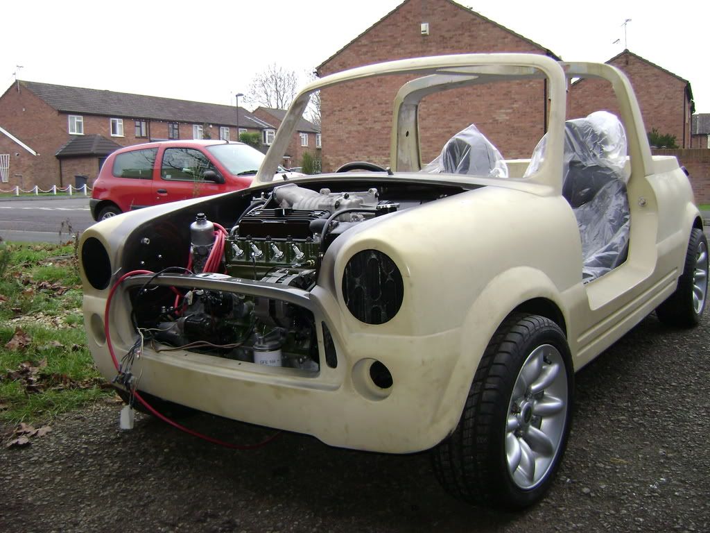

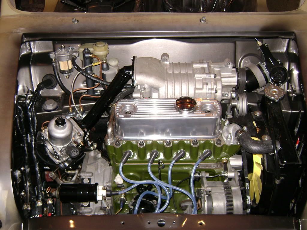

Hi all, first off I would like to wish you all a happy new year. This is just a small update, the engine bay is nearly finished, hopefully have her running in the next few weeks and then off to paint.
Let me know your thoughts.

This is great mate ;)
Looks really good, keep on going it'll be done soon :ermm:

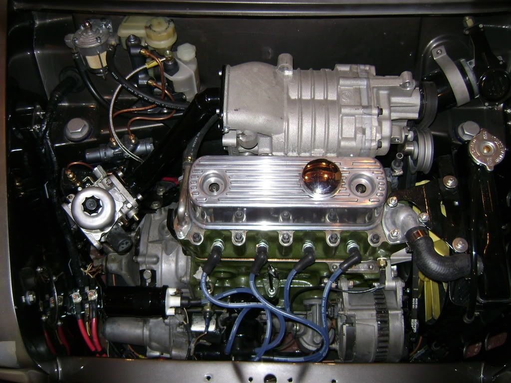

the carb looks like its not vertical which means the folat will cut of the fuel before the bowl is full ,can run a a angle front to back as can change float hight but not side to side, the base should really be paralel to the ground
you have to check the float hight on the kits you can by beause the carbs normally run at a slight angle on a standrad manifold but not when running on a super charger kit
