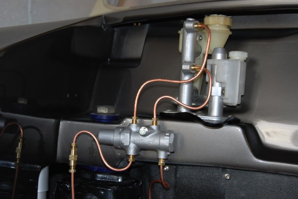

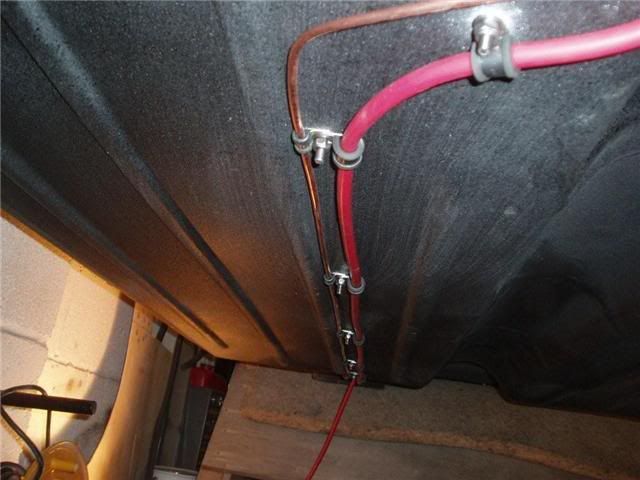

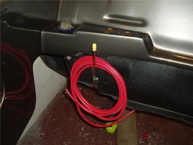

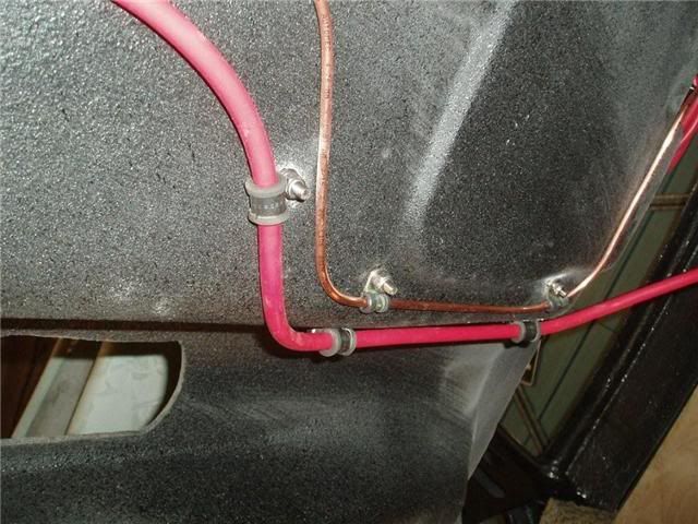

after spending another evening crawling around under the Domino, i have made further progress. the front-to-rear brake line is in and the power cable is also in. i have taken some pictures to show you all how things are coming along...
tomorrow night my mate Si is coming over and with his help I hope to get both the subframes back in and bolted up. then the shell will be rolling again!! watch this space!!

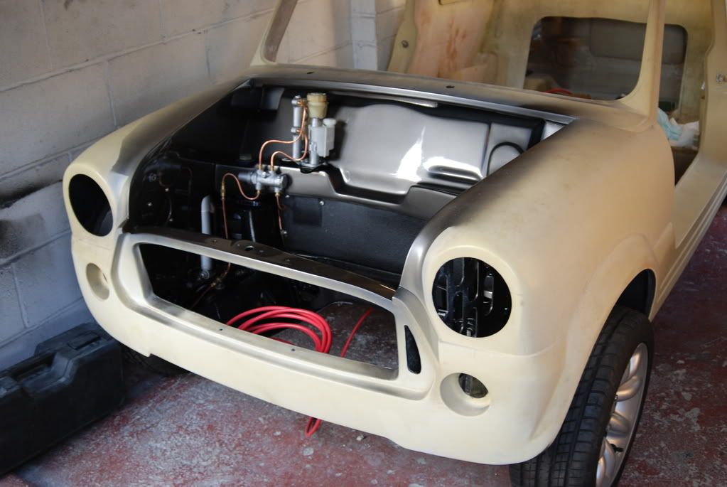

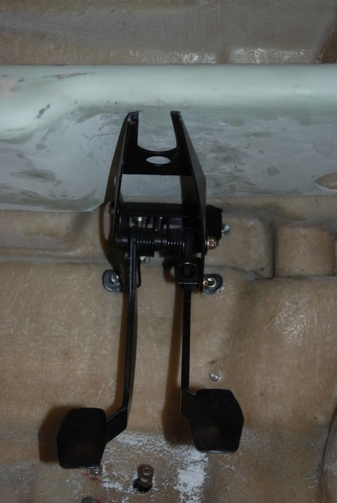

things have come on nicely today and I feel that we have made some major headway with the build. we have installed the brake master cylinder and clutch master cylinder after stripping them down, cleaning, painting and then re-assembling them. we have also stripped, cleaned, painted and re-assembled the pedal box before installing into the car. all of the brake lines for the front end of the car have also been connected.
now for some piccies...

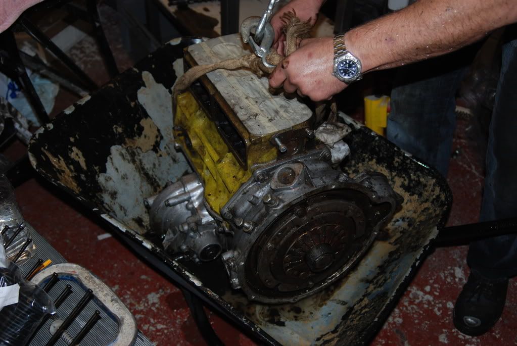

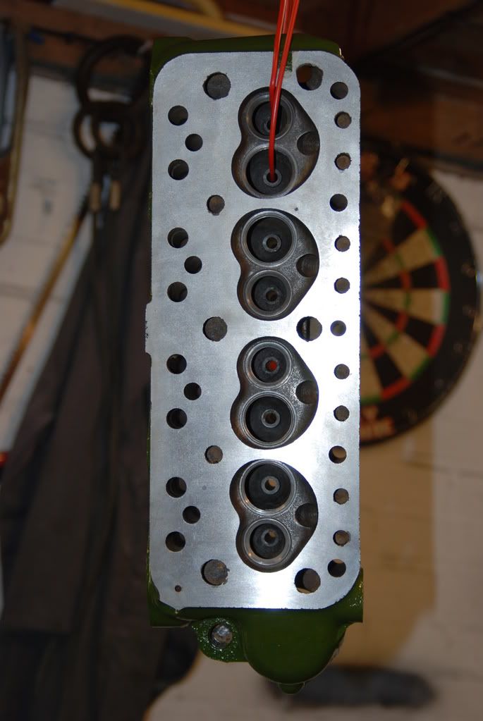

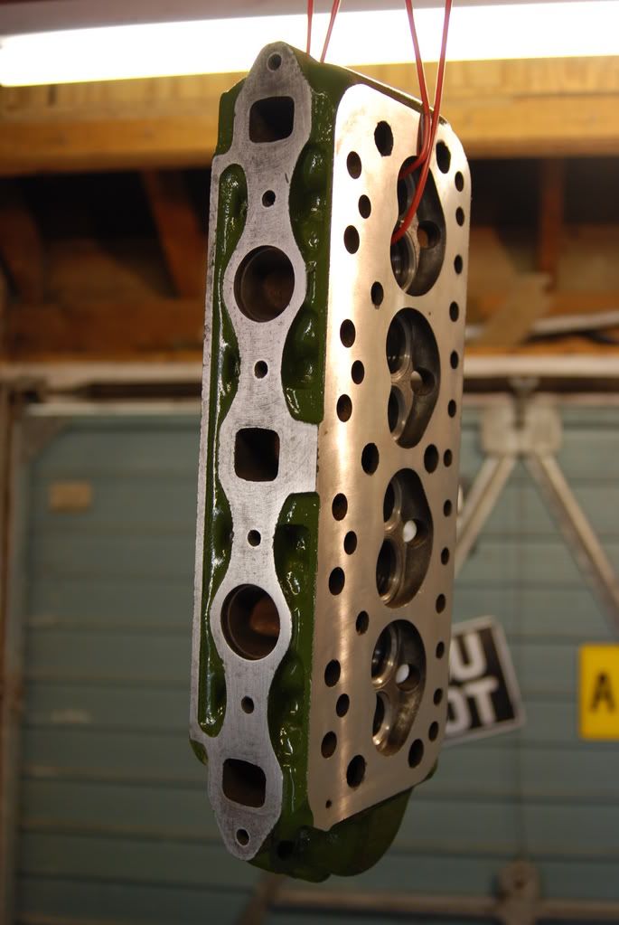

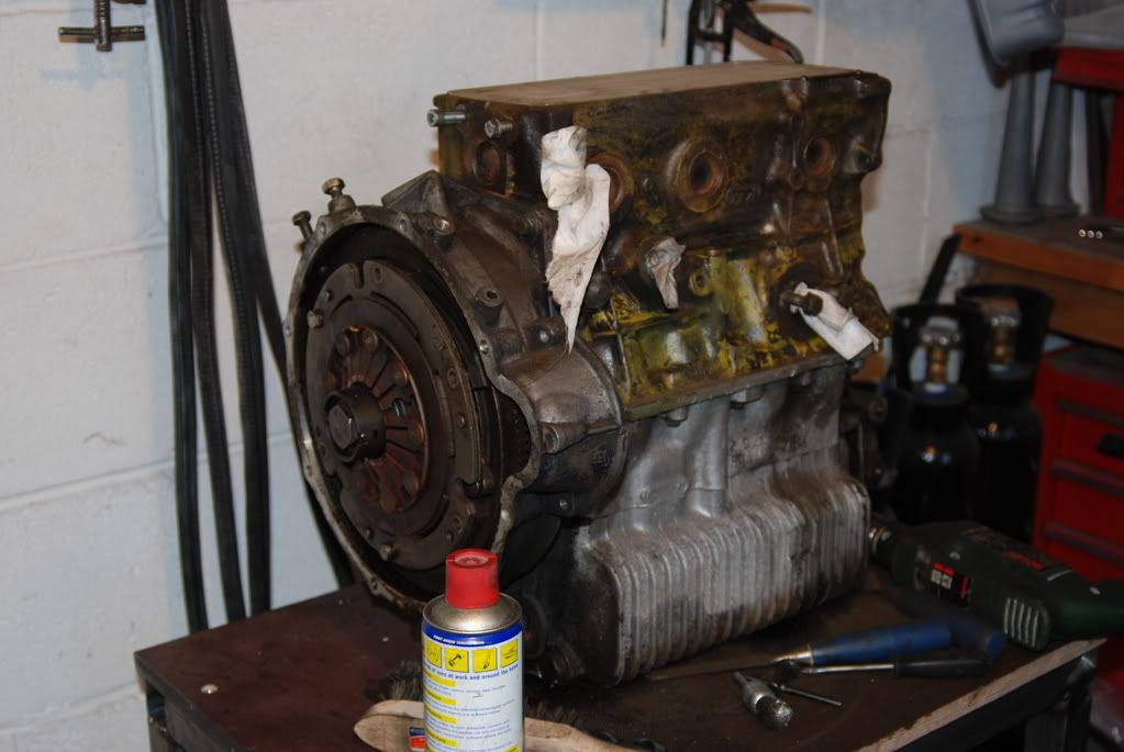

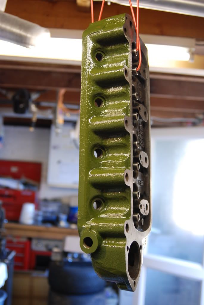

a few things have been happening recently. lets start with this week (because its fresh in my mind, and i dont need to do much thinking...). the domino shell went off to be stored in andy's brother's garage, to make room to build my subframes (thats another story for another post...). andy has also started taking apart the 998 that will go in the domino. a new 276 cam has been ordered, to suit the eaton supercharger (make her blow a bit harder!). andy has also started cleaning the engine and gearbox.
also, big news! the 12g295 head has come back from the engineers and has had all new valve guides, valves, unleaded valve seats and a skim. andy has cleaned it up this afternoon and given it a nice coat of bmc green engine paint.
finally, the material to do andy's interior panels arrived :techsupport:)
now for some pics for you all to "enjoy"...!! :thumbsup:
oh and this is andy and me being complete retarded idiots this afternoon wheeling the engine around in a wheelbarrow. there was a point to this - clean it!

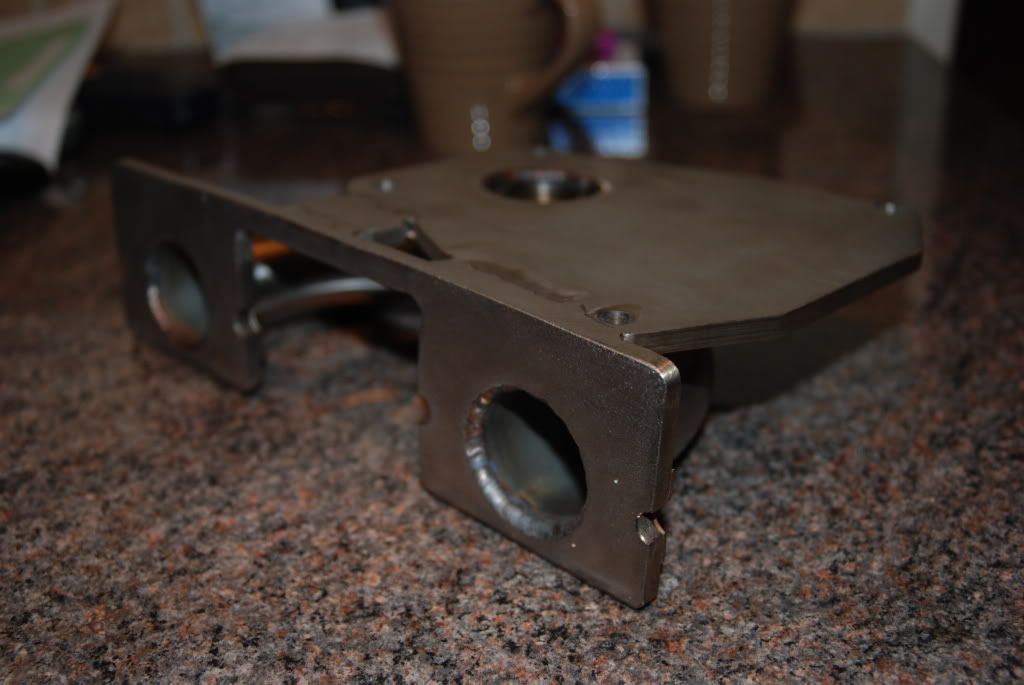

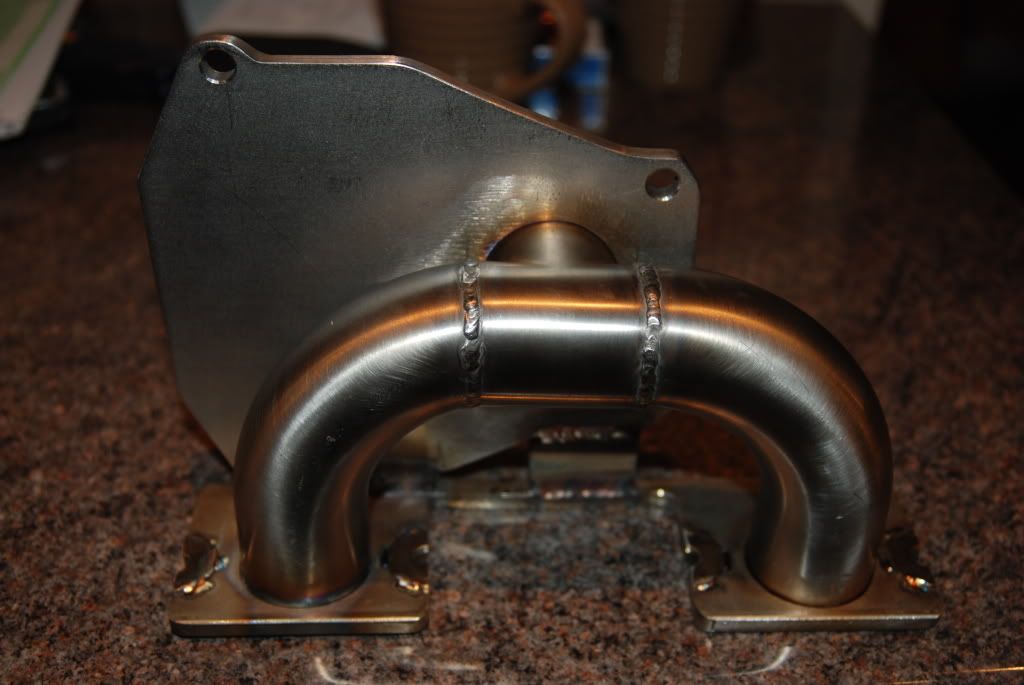

today has been a good day - its been foreigner thursday!! i had been down to rs components to get some tubes to make my supercharger inlet manifold which i took into work with me today. they have been cut, welded, bent, cut and welded some more to produce the finished item......
and here it is....!!!
total cost - the massive sum of £55.... :D
