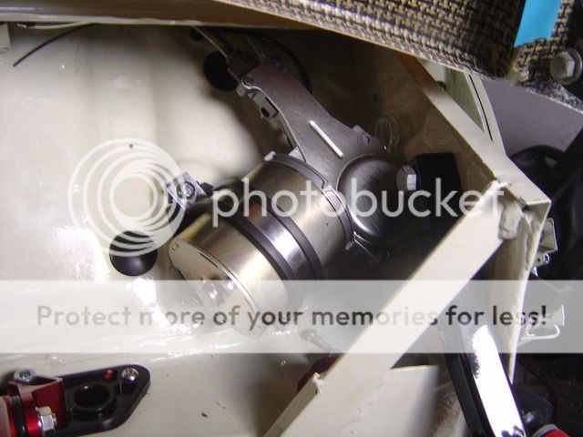

First off the gf last weekend finished her little project of refurbing and fitting the wiper motor, splendid job has been done as well

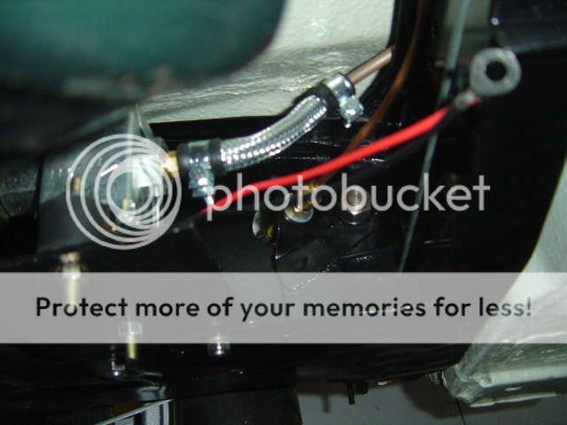

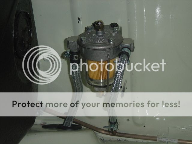

One pig of a job was connecting up the fuel regulator which is now fitted finally after much fuel pipe wrestling! (Although this may need to be revised after Steve's visit today)

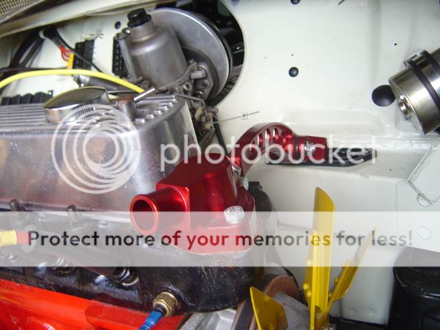

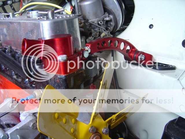

Then also properly fitted the engine steady by DSN Classics. Revised this when I went to Bingley and got a black bulkhead plate as opposed to Smiffy Bits stainless one. I think it was a good call although I had to drill the mounting holes bigger to accept their engine steady bracket.

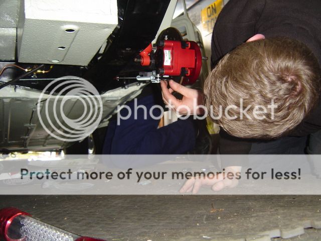

Another royally painful job was adjusting the KAD rear disc brakes with the handbrake, think I've sorted it but time will tell really as the passenger side isn't running quite as free as I would have liked really

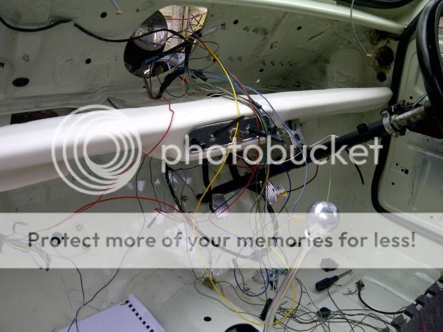

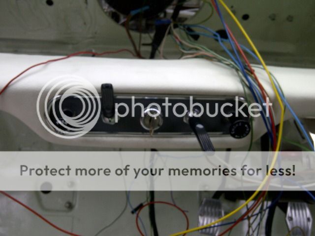

Now as I said previously the choke cable is fitted which obviously means the dash rail is fitted :D Looks very tasty in my opinion although needs a clean after a few dirty hands have been handling it >_<
Switches are also connected up :D Because of handy man Stevede I've got 2 speed wipers with self park :lol:

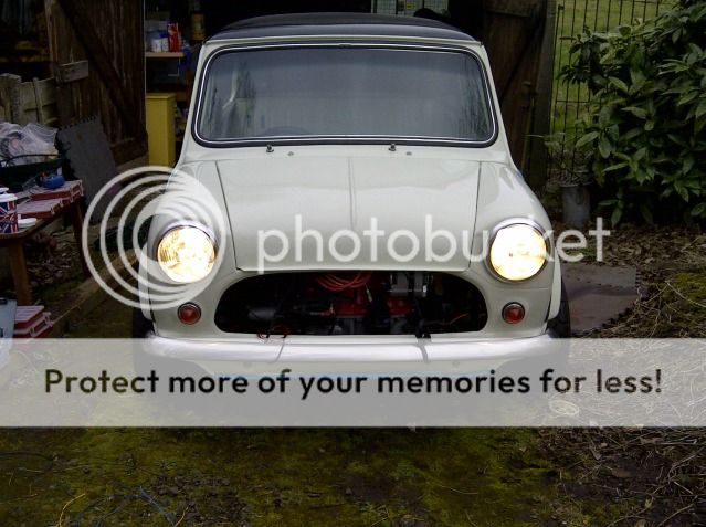

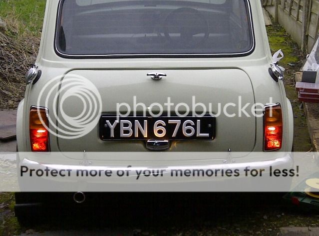

And finally another HUGE milestone met because of Steve is the lights work! (Barr the indicators)
And my favourite photo :kiss:
Nicely fitted with the alloy headlight rings :shades:

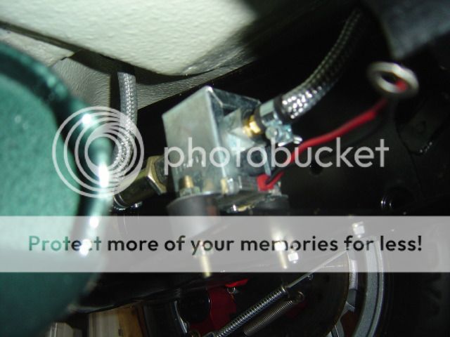

Then I made the final attachment of the main run fuel pipe to the pump :D

Ok got an issue with the fuel regulator being in the boot :sneaky:
Basically I need to have the fuel regulator ahead of the pump or it's next to useless pretty much, so best correcting it now obviously. So where to fit?
Was going to fit a D-shaped washer bottle to the bulkhead so I'm struggling for ideas as to where it can go. Anybody got an solutions?
Cheers
