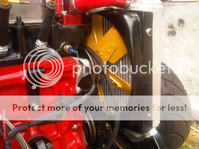

This task wasn't so easy with bracket not being able to flex enough to fit on to the thermostat housing, which I reckon it was a combo of the DSN thermostat housing and it being an aftermarket radiator the cowling was fixed to. Then the blades get snagging the cowling on trial fit and then when that was fixed the blades snagged the radiator itself!!!!! Lots of filing, bending and modifiying later and it all fitted easy as pie, happy days :D

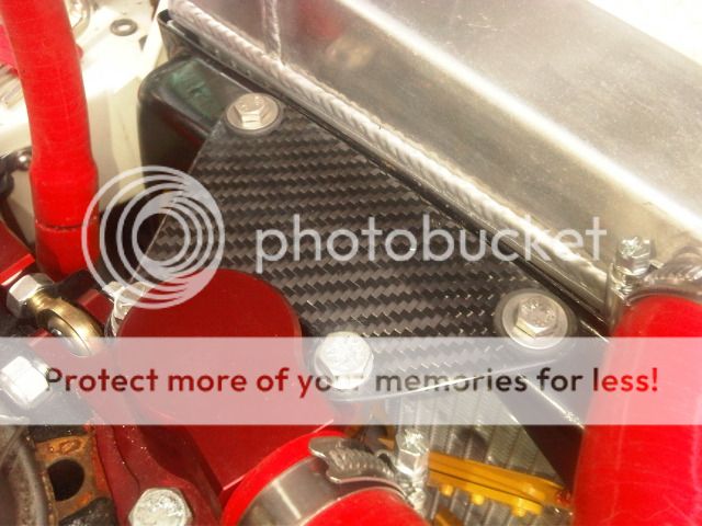

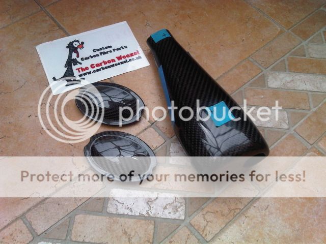

It's also very noteworthy that Ben at Carbon Weezel when I placed an order with him a couple of months ago noticed that it was my birthday the week he sent some stuff to me and chucked this in as 21st birthday present to me;
Was well chuffed!!!!! Thank you Ben :mrcool:

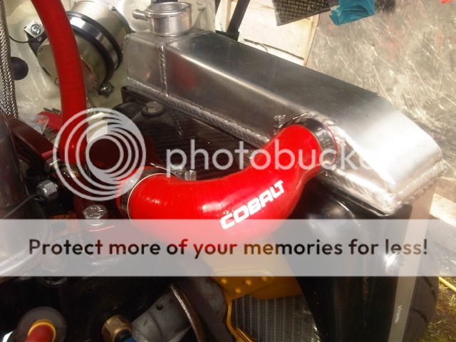

Also got the first proper silicone pipe on which looks quite tasty I reckon, although would have preferred it I could get them less the company logo of who produced them.

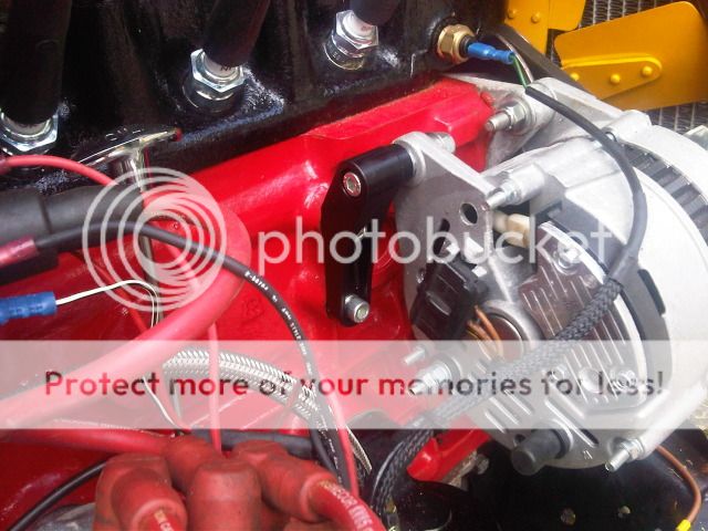

And for those with eagle eyes would have noticed the DSN classics alternator bracket in the first pic, brilliant bit of kit :wub:

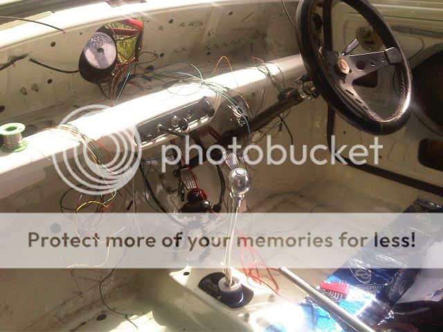

Steve managed to do a bit more on the wiring, of which I've not a clue what it was, so here's a general pic of the interior instead haha!

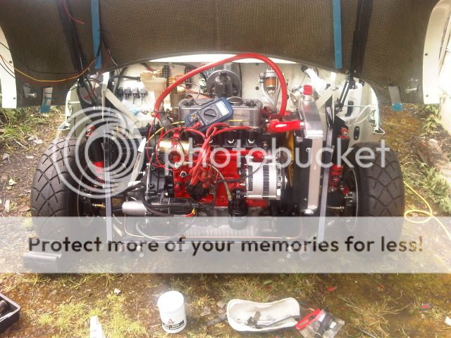

How we left the mini today pretty much;
So next weekend the aim is to have the clutch and brake lines plumbed, fit the manifold, carb and exhaust which should essentially mean the mini can be driven!!!!!! :wub: Very happy days if we get round to this!!!!

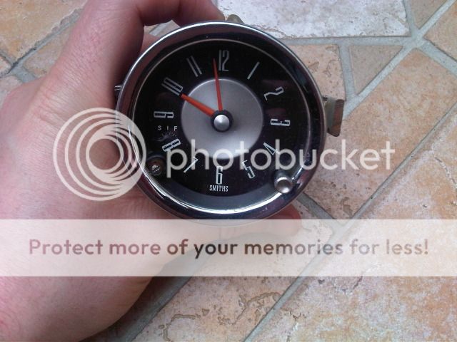

The clock which I waited near enough 6 weeks for!!!!! Looks very good though :-)

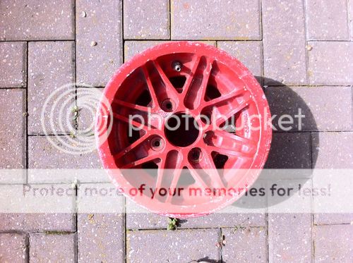

I also had to buy another Cosmic alloy wheel as one in the set I bought didn't match the others, basically in my set I had a mk1 one as opposed to the rest being mk2, not best pleased but managed to strike lucky on ebay and find another mk2 after about 3 weeks of searching everyday for one haha!
Gonna get them acid dipped and refurbish them :thumbsup:
