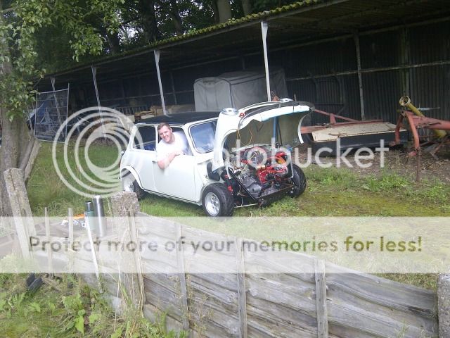

So we had some issues as previously mentioned with a fairly large oil leak coming from the crank/gearbox cover which worried me somewhat. Are first we suspected the gasket just placed incorrectly (which in hindsight didn't make sense with the amount that was coming out, literally gushing!), so we replaced that and needless to say it made little difference and was a waste of time considering how long it takes. Then Steve took a closer look as we stripped it apart for the second time and we found that bolts were going through and pushing on to the gearbox casing. So we cut down the bolts, put it all back together, started it up and problem solved! So may have taken 3 gaskets to get it right but it's sorted now :)
Then we move on to exhaust which I've spoken about previously. Basically that's fitted and fitted like a dream as it being a maniflow, highly recommend them and don't plan on changing for something else any time soon.
Finally got brakes all bled through which was a monster achievement I thought, having functioning brakes. This did involve a bit of trial and error though as the rear brakes didn't seem to want to make a solid seal and let loose of some of the £30 a bottle Automec brake fluid! Fingers crossed though over my 2 months absence from the mini it hasn't leaked a drop, the same with the fuel (we think).
Now the good stuff....
All the above was primary to getting the car running in that the noise didn't annoy any neighbours, it didn't spew anything as I drove along and obviously that I could stop when required! So after 3 attempts (if I recall) we had this...
...running like a bag of nails. Expecting the worst with the previous history of this engine with head related issues, Steve set about looking for plausible explanations as to why. After looking at the spark plugs cylinders 2 and 3 weren't firing up so after checking the distributor it turned out the leads had been put in clockwise as opposed to anti-clockwise (I blame the electrician Steve :shifty: ). Tried again and we had this....
Brilliant! Not perfect but close to the best we are going to get without a tuning session I reckon.

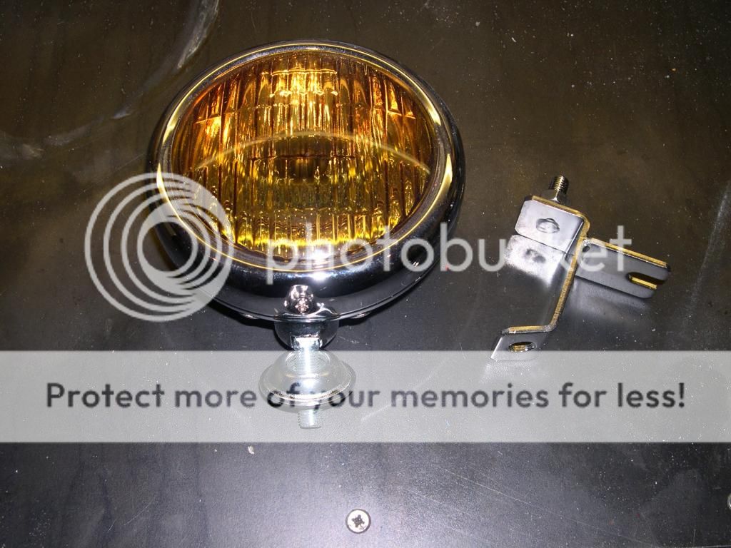

In the absence of Chris posting any updates recently, I thought I may have a bash and let you, (and him) know what I have been up to.

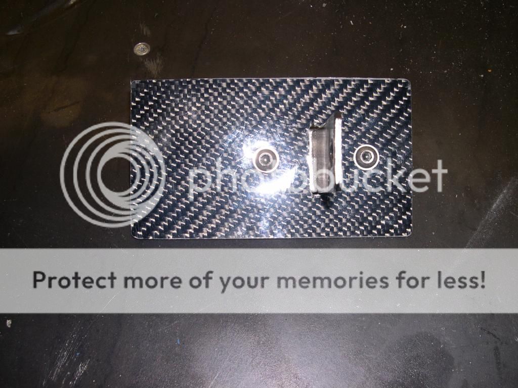

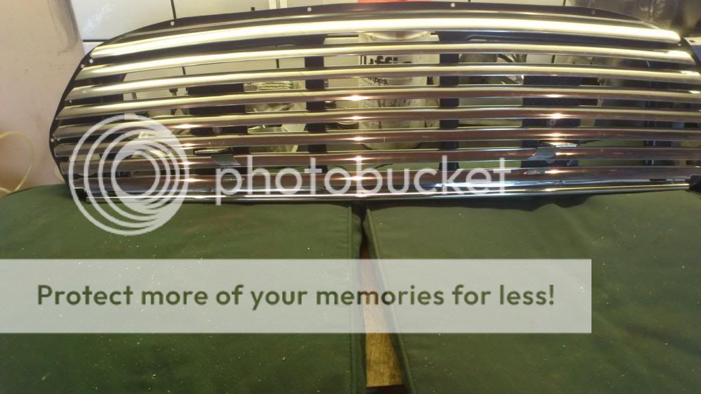

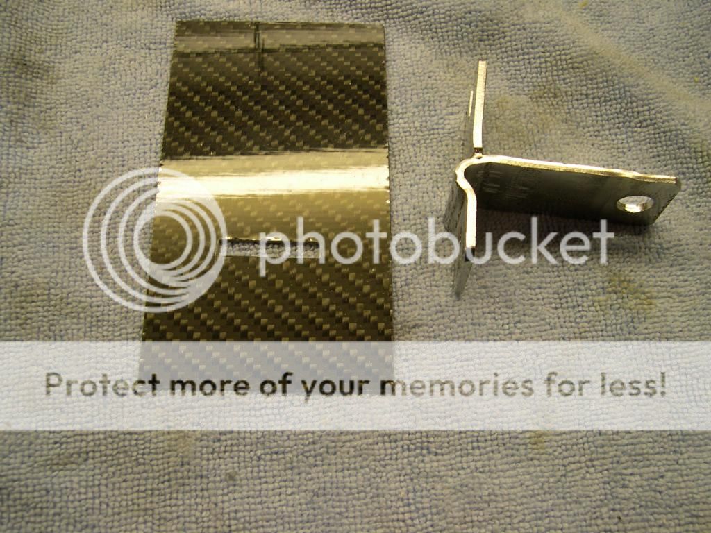

What seems like ages ago, I collected the grill & spot lamps from Chris, as I had an idea on how we could mount them neatly. 2 small yellow lamps, with a requirement for discrete and neat.

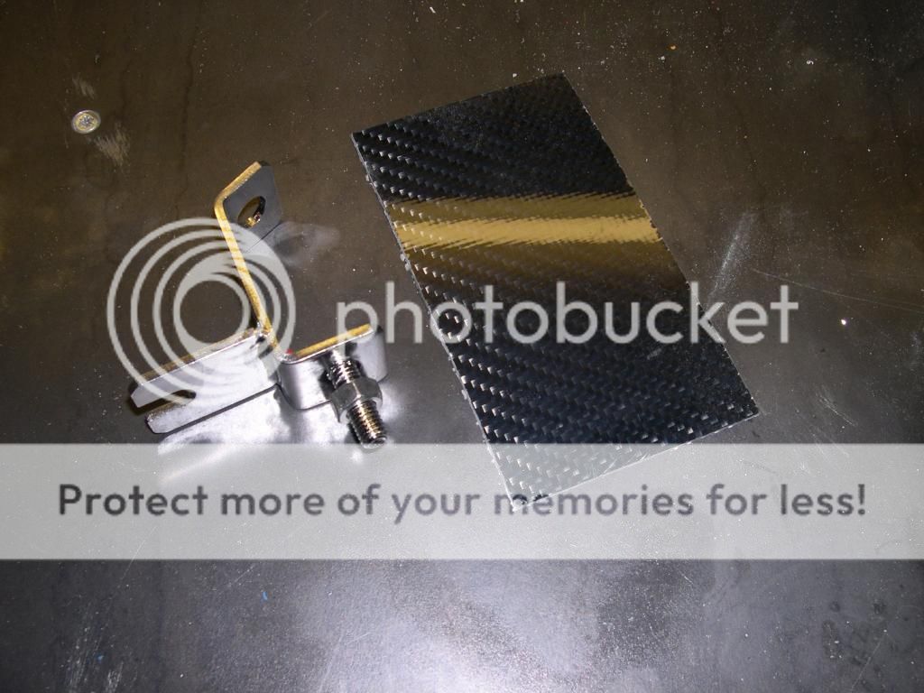

A few ideas & trials before I thought I could use the mounts Chris had bought, along with some spare Carbon Fibre I had. (You know how he loves CF) :-)

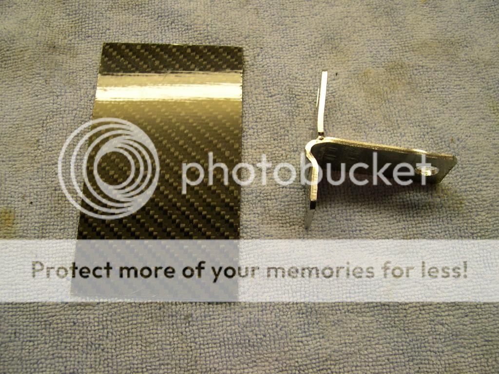

A little bit of "adjustment" on the brackets
A slot cut in the CF board

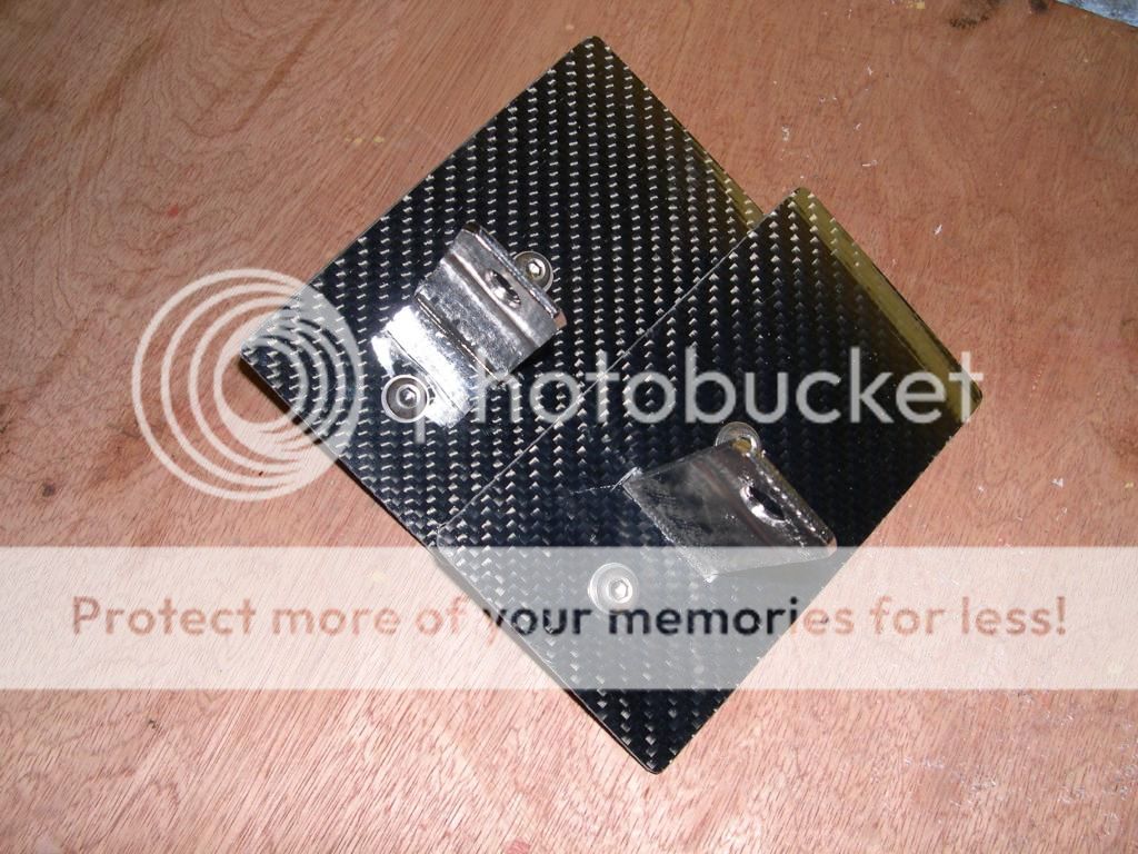

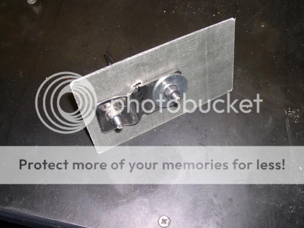

Couple of bolts & washers, the idea being to rivet the boards to the backs of the grille slats.
And Robert's your mothers brother.
Now if you're reading this Chris, I need some 3mm dia x 6mm long pop rivets, (20 should do it) so I can drill some nice holes in your shiny new grille :-) and get the brackets attached.

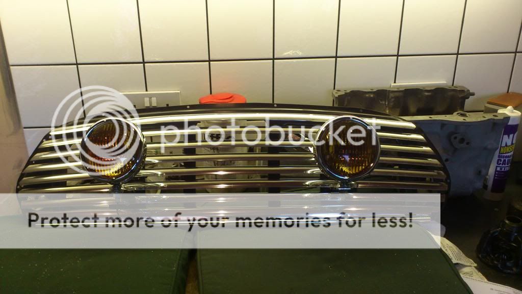

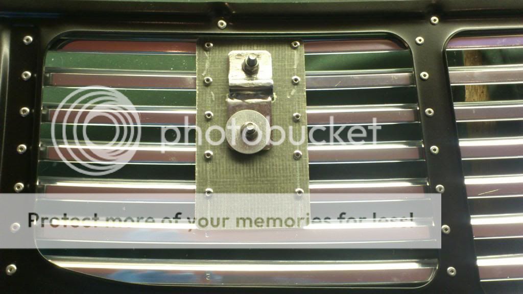

Essentially Steve has come with a brilliant way for me to mount my spotlights on the grille rather than having ugly (imo) brackets on the front panel.
Can you see it?
Brackets :shades:
Put into actions :D
Ta very much Steve! Very pleased, just need to get around to picking it up now!
