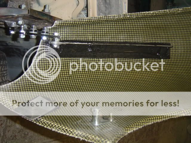

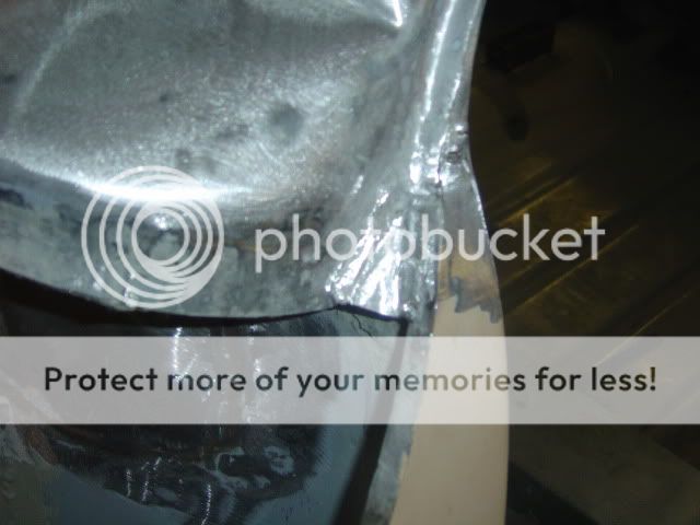

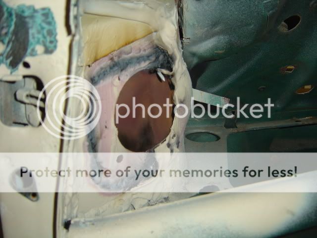

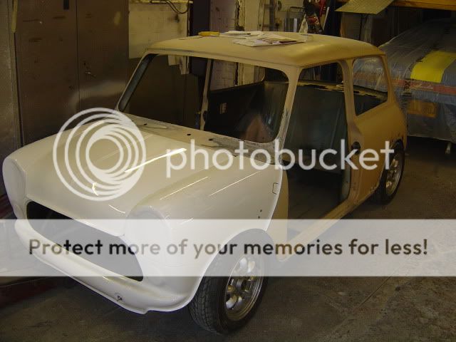

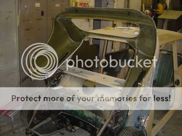

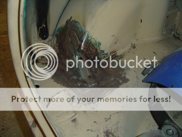

Right well went down to the sprayshop this afternoon and I was very impressed with what they've done. First off though there was another mini in there who apparently heard of them off here, so who is it!? Was a very nice blue mini though, owner called Mike?
Back to the project, as I said I was very impressed with the work and they are really thinking through what they are doing and the attention to detail was immense, was buzzing when I left! Some pictures for you all;
Frontend on!!!!!!!!
Frontend flipped!!!!!!!!
Boot floor repaired and aligned
Airvents welded up
Latches setup
Frontend brackets bonded on
Reinforcement between the A-panel and scuttle
They have also cut the hole for the Right-Hand tank. They have had to bend the brace bars to the inside on the inner arch as they wouldnt fit very well to the outer as they obstruct the frontend brackets. Next job is to fit the bonnet in which it will have to show fixings on the outside but thats unavoidable, same as the locking catch that had to be bolted on so it was strong but they will put some sort of cap over the top and spray it the same colour. So pleased I went to them though, gonna be a minter when it comes back :)

I'm going to order my bonnet catches soon :thumbsup:
It looks cool, front flips back really far! understand the gas struts aren't on yet, but I'd love it to actually flip that far backwards.

Yeh the catches are awesome, got the idea off Oz (Matrix), nice setup and keeps the exposed fixings to a minimum.
Would be nice if the front would go that far back (without touching the body) as it would allow more head clearance but I don't think the struts are going to allow much but we'll see.
