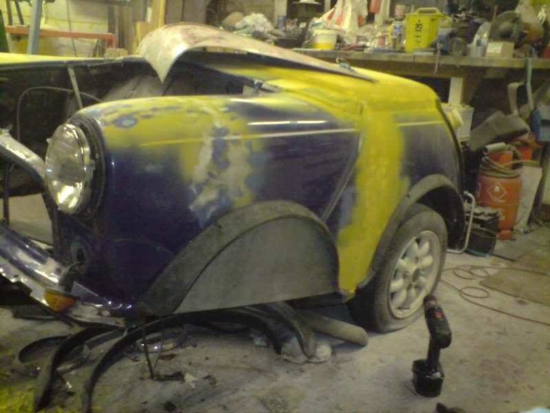

after my last post I went to my local trailer dealer/hire/parts centre and had a chat. I showed him some pictures and explained what I wanted to do. He said that it would be too dangerous to do such a thing with such a short wheel base, he explained that every time I wanted to turn I would be putting strain or friction on the front wheels, tow bar, and tow hitch. This could result in two things - 1) A wheel falls off the trailer 2) The tow bar/hitch snaps. Thus allowing the trailer to come free from the car and cause a nasty accident! If the trailer was longer it would not be a problem as the pivot point would be further away, such as on lorry trailers. His only suggested solution was a 'turning bar' (thats not what he called it, but its the only way I can describe it at the moment!) Basically the wheels would be attached to an axle which can turn with the car. The only problem with this is reversing, when reversing the turning bar would try to go 360 degrees, through the arches! so reversing would be out of the question. The price was also high at £170! (He said they don't sell many!)

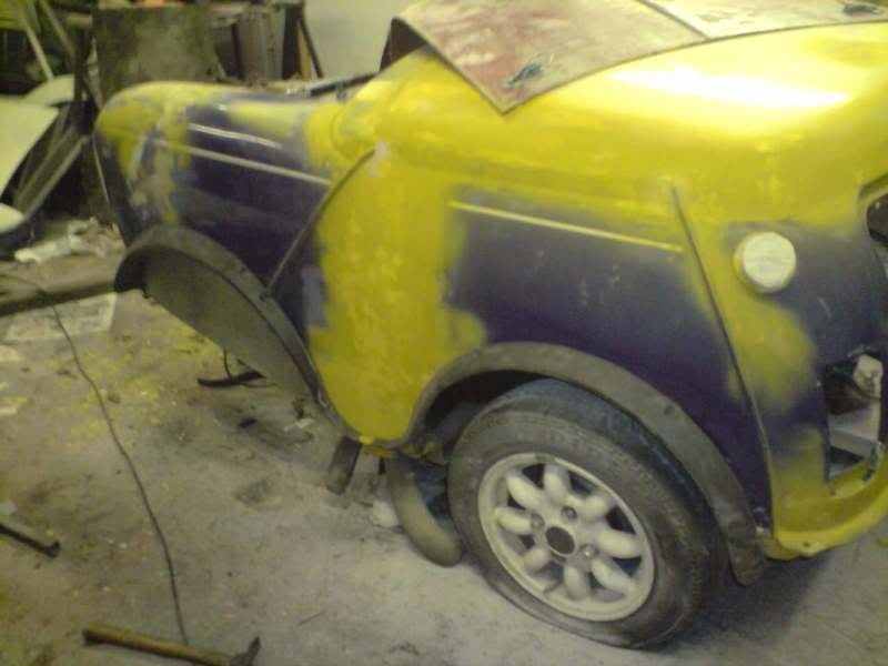

So im back to square one. I had a quick play before going to work and riveted a sheet into the gap, could be the solution maybe? If theres no other ideas?
Im not sure I like it yet, from the front it looks ok, but not from the back. On the plus side I can paint a wheel on! I need to start painting tommorrow really so I have a bad feeling this is how its going to be. I can always change it at a later date, its only riveted on!

How about making it follow the shape, take the arch and a-panel seams out, and shape a piece of metal to follow the curve of the body, essentially removing the arch completely, make sure the bottom of it aligns with the sill seam and then just curve it up at the front to meet the front valance?
I see what you mean, and that could look very smart. Its going to have to go one the back burner for now I will have to do it once its painted. I lose the garage space on sunday so its got to be finished!

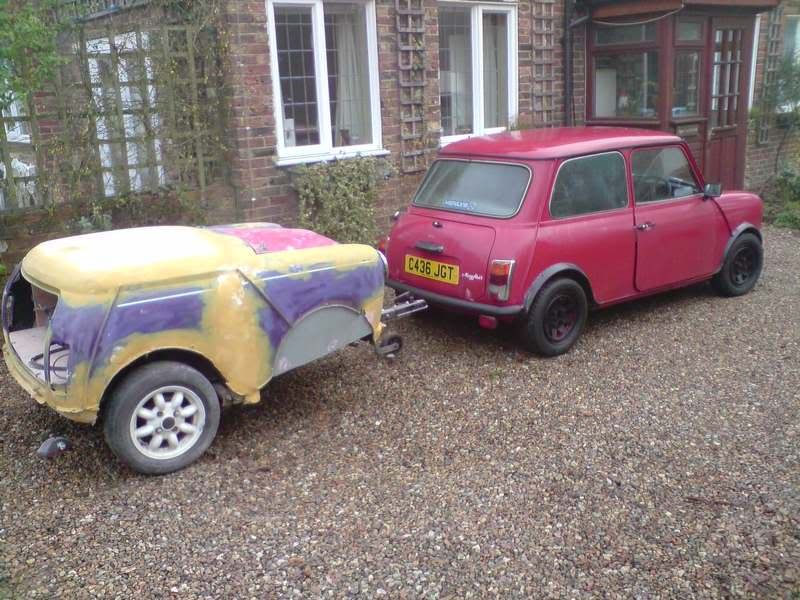

Heres another quick update.

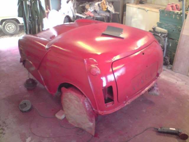

So this morning I finished blanking off the other wheel arch - still not happy with them but for now they will do.
I then cleared the garage of all the scrap metal, wood, dust etc etc, that took 2 hours! Then I rolled the trailer out before giving a final sweep and clean ready for painting.

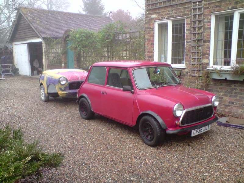

Whilst I had it out i positioned it behind my mini so you can all see how it will look. You just have to imagine its red for now!

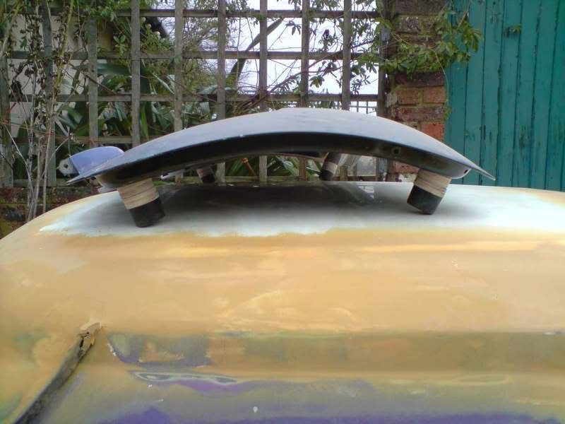

I also gave the boot some little feet so that it can be rested on the roof without scratching the paint. I did this with door stops and some wood. Looks quite smart and should save the paint as they are rubber.
Now im going to have lunch before putting dust sheets up, doing some masking, mixing some paint and getting the first coat on ;D

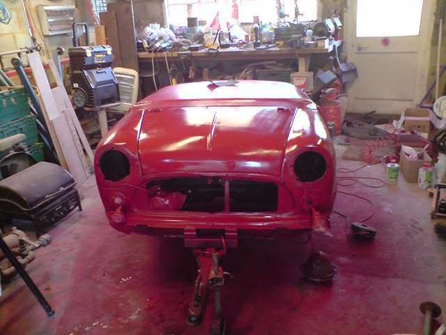

A sneak preview: -
More or less finished, just got to let it dry properly and then flat it back and polish. Do that next weekend.

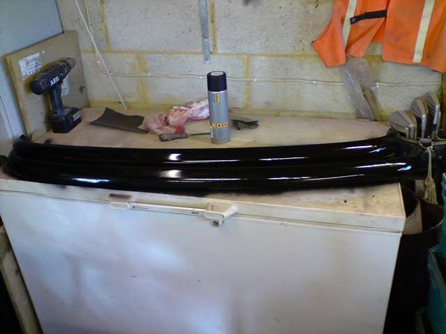

Also sprayed the bumpers
Just got to put it all back together now :D Mini Fair here I come!
Now, off to fit that towbar....
