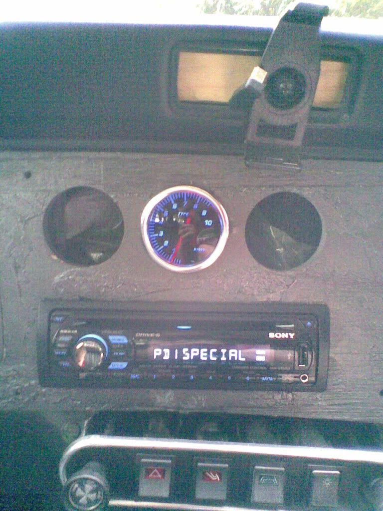

then my mum turned up with my new type 8 rev meter :D
i was a happy bunny tested in the coil first and worked great so i took the dash out ran the wire to the coil, redid the dash board as the last attempt was pooooo
I then refittted the dash with new rev meter and gave the car a lil clean and took for a spi

well i just went to admire my new dials in the dark and ended up driving to whallet over the tops >_<
i love it
#125 Retro_10s
Retro_10s
    Moderator
  • 10,178 posts
  • Location: Worcs
Posted 27 May 2009 - 08:39 PM
does it change colour all the time or is it dependent on revs?

Posted 27 May 2009 - 08:42 PM
im unsure to be honest only seems to go red when i do over 5krpm but could just be me hahahaha
so pressumably just changes with time i love it goes black and mirror like with no keys in >_<
its purdy and for £12 posted u cant complain

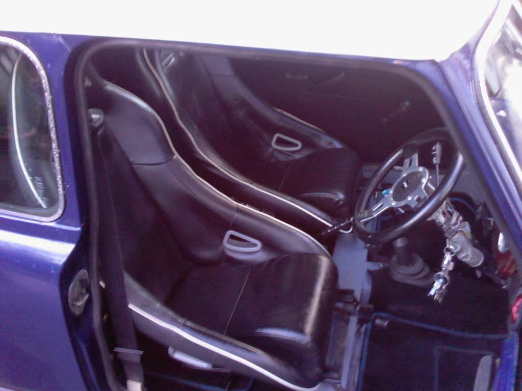

Hi nice project and a lovely car :D
I dnt suppose yu could post a pic for me could you showing what thoose seats lok like in the car could you?
-Same ones as iam planning o for my car-

Posted 24 June 2009 - 04:40 PM
the seats ive got are mayfair seats that have beeen retrimmed in black leatherette oldskol hahaha
the cobras were sold
but heres the pics

Posted 24 June 2009 - 04:43 PM
Nice one cheers. They look great, why did you sell them?!?! lol
What was the fit like then? was they hard to get in and out of due to the sides? and comfort?
