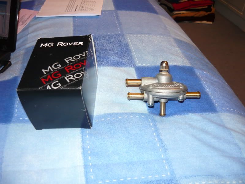

Posted Image The fuel return goes from the bottom pipe back to the tank :P
Going to try and find a proper turbo carb as rebuilding mine to turbo spec seems like too much hassle

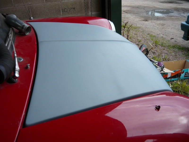

I'm off work for 3 days, so today I had a really good tidy up, chucked out loads of bits that arent needed anymore and tidied the place up.
Then got started on the mini. Finished off sanding down the bonnet, then filler primed, lightly sanded, then another 2 coats of primer and its looking good!
Going to take the hole saw to it tomorrow and make some nice big holes for the intercooler.

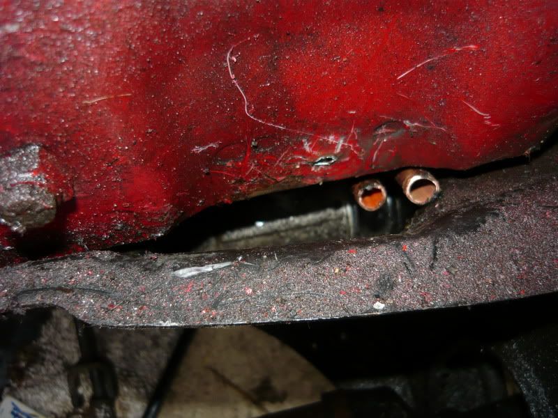

Then got started on the fuel pipes. Not a very nice job laying on the floor under the car making up pipes. Got most of it done, did both the feed and return from the tank to the front of the car, then ran out of rubber pipe and jubilee clips :errr:
Anyway here are the pics:
Just need to get some clips to attach the pipes to the floor as the original clips are for small pipe and this pipe wont fit in the clips :genius:
Then bent the pipes up and they just peek up behind the subframe. Hopefully when they are tight up against the floor they will be a bit longer so I can get a clip on them :thumbsup:

Thanks for the link, the middle ones look the best, but that would mean screwing through the floor, I'd prefer to use some clips that will attach to the screws that are already there, where the original fuel pipe clips were?
Or I could get some of the middle clips and find some little nuts that will screw onto the original screws?
