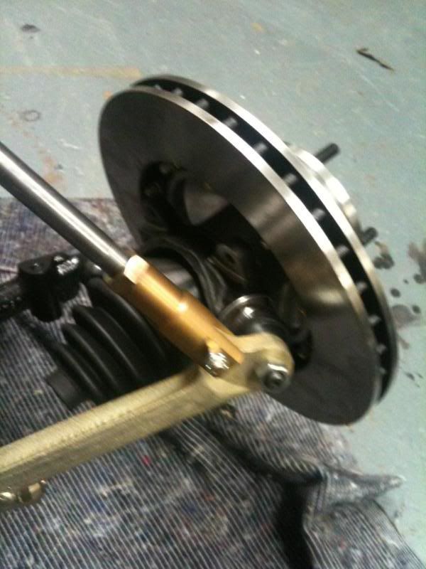

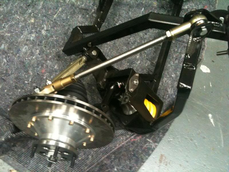

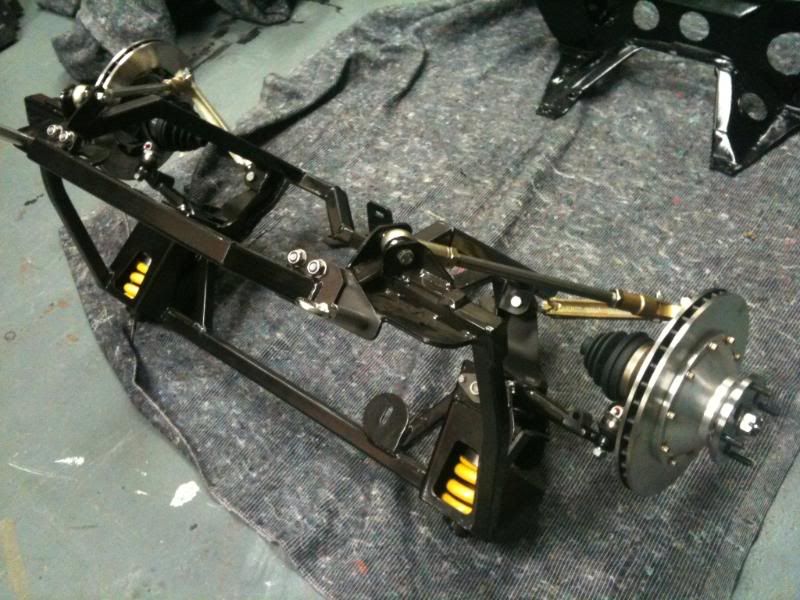

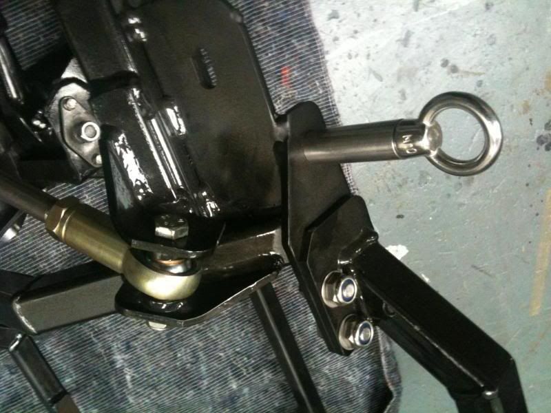

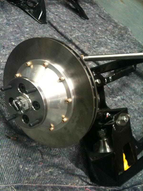

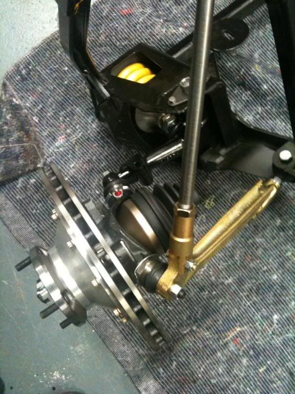

subframes back :) with mahoosive disks and 100mm PCD flanges :(
please excuse the stains - I was rather excited :(
calipers in due course, Martin wants to fit them once we finished with mounting the frame, sorting bodywork, installing engine, and he can then do a 4 wheel laser alignment.

Good God, those discs look huge!!
#156 roofless
roofless
    Sticker Pimp
  • 7,216 posts
  • Local Club: central minis
Posted 05 April 2010 - 01:20 PM
285mm of vented pig-iron :(

well, all being well, sub frame is going on tomorrow, it'll stand on its wheels for the first time, and calipers are coming for installation on Tuesday :( big fat and nasty six pots compliments of MRA minis that will hopefully make it stand on its nose :thumbsup:

with an estimated 300bhp, we're going to need it - hence the chunkiness of everything going into the front end, and also why we're going full steel front - we need as much strength as possible.
The turbo brake rig on the cabriolet is OK, but at 160-ish WBHP its just about on the limits of its capabilities, so I wanted this to be as good as it could be, so we've gone for the maximum size we feasiblly can what with the 14" wheels, and MRA were the only firm that could supply a rig of this nature - Even KAD's 6 pot type B conversion couldnt give us what we wanted, but this solution from martin looks as though it will be just perfect. :thumbsup:

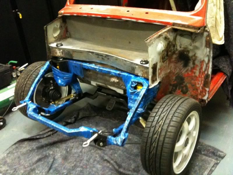

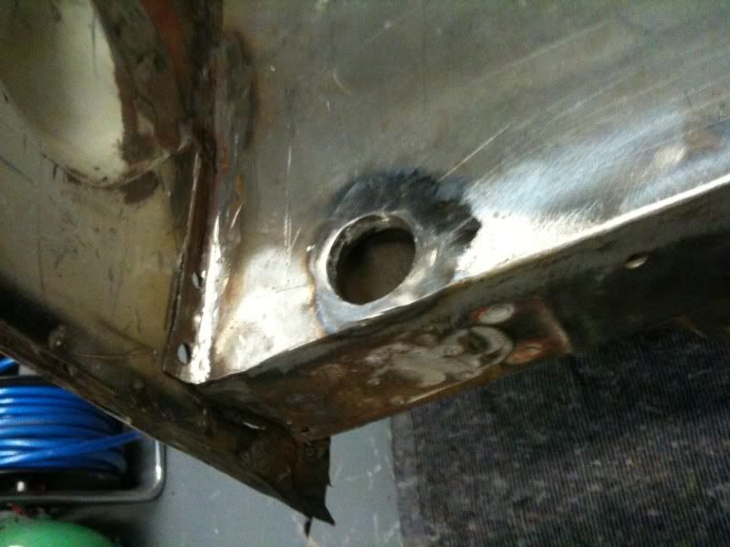

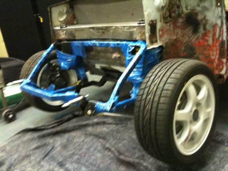

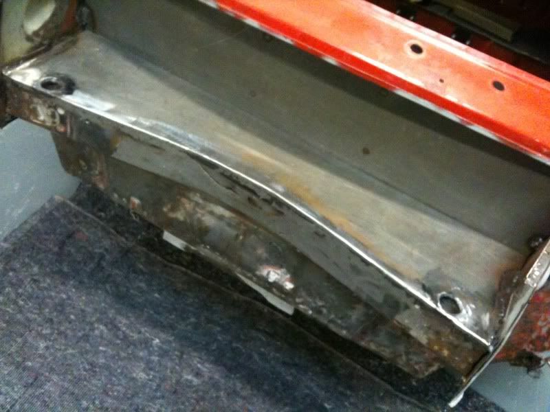

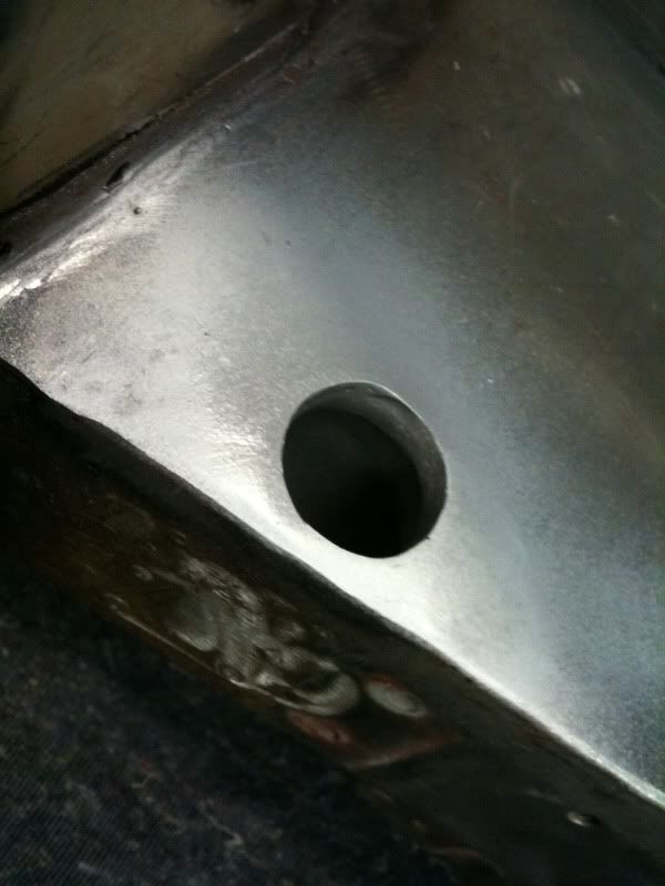

little bit of bulkhead fettling, welding, grinding and general hole making compliments of resident welder cookie :ermm: and the subframe is on :dontgetit:
front wheels dont appear to protrude quite enough, may look better tomorrow once its not floating, but already suspecting we need another 30mm on each side :ermm:
