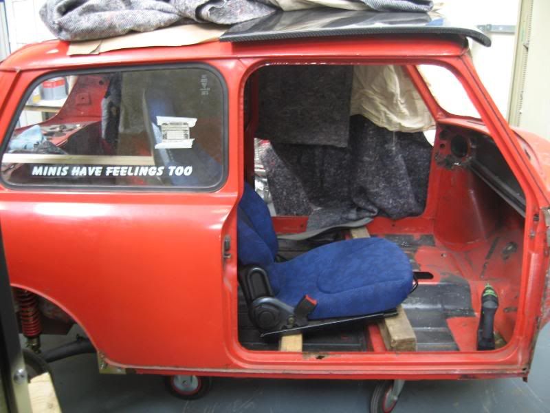

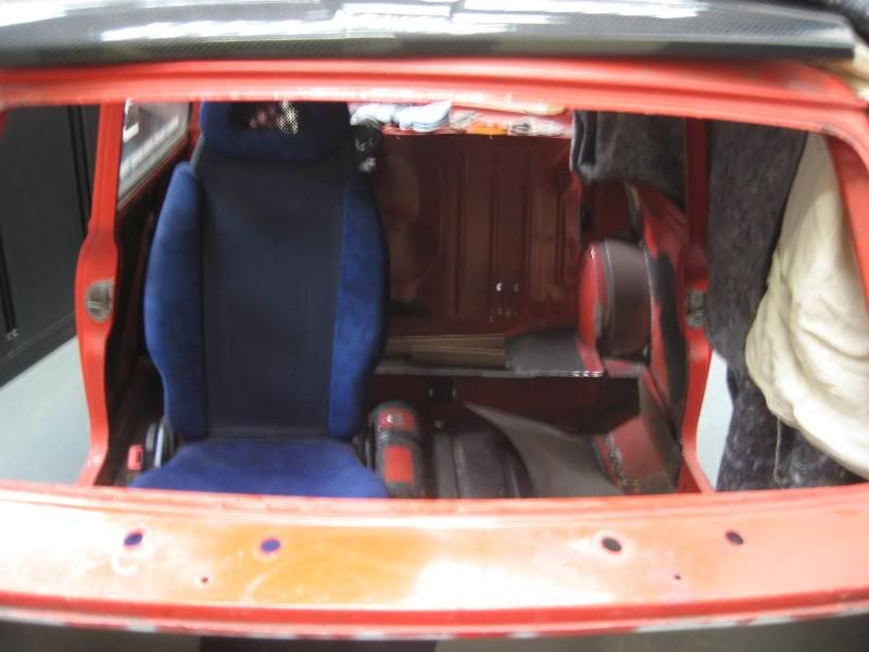

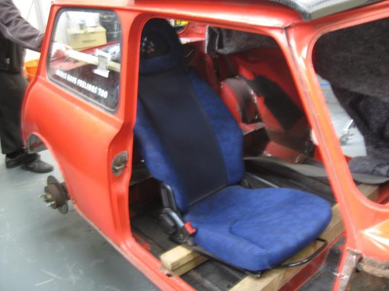

so what can I do while I wait for front subframe and engine bits......... :)
I know - start the interior :)
the dash needs to wait till some for of rollcage is decided upon, as does the rear sections, but I can work on the seats.......first stage then, get some tall fat bloke to get a comfy position for the seats, and make sure they fit

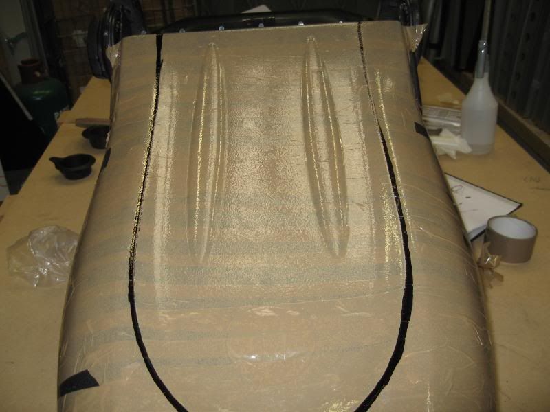

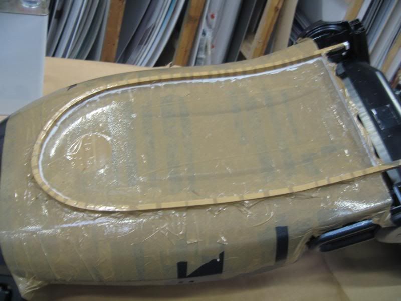

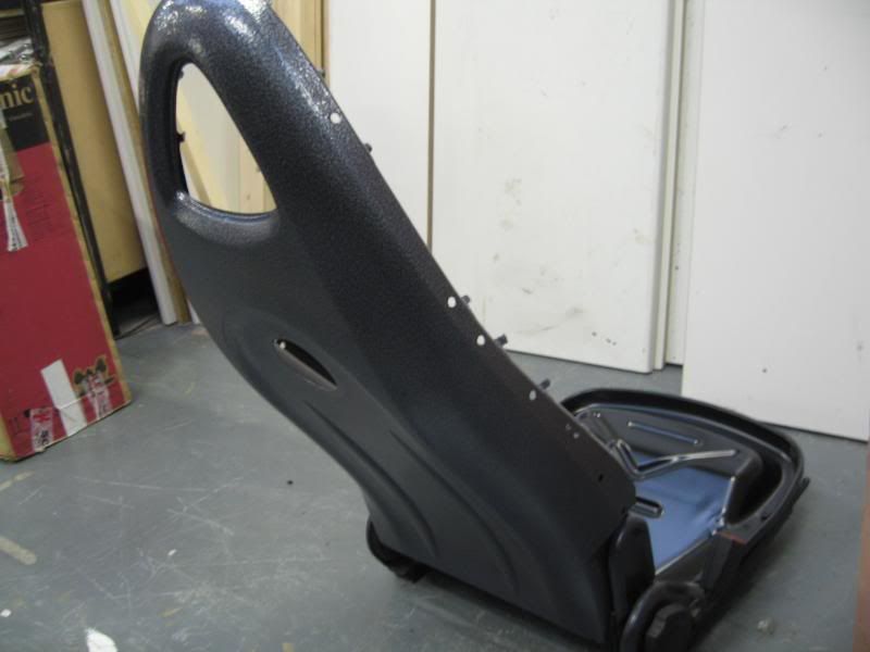

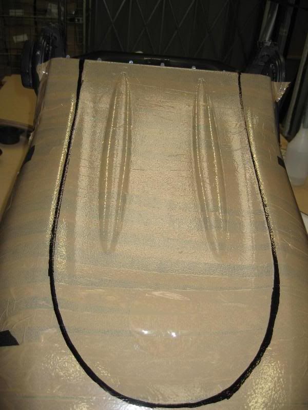

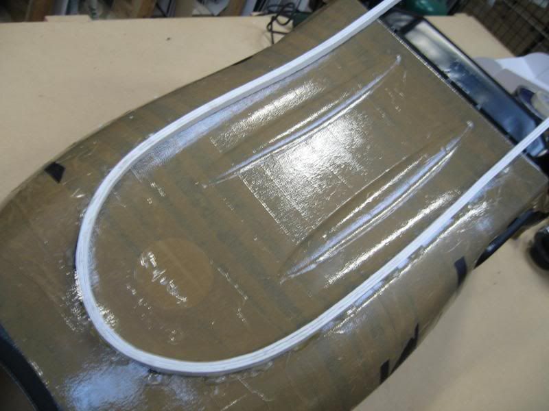

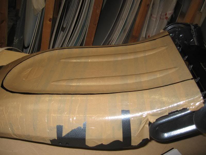

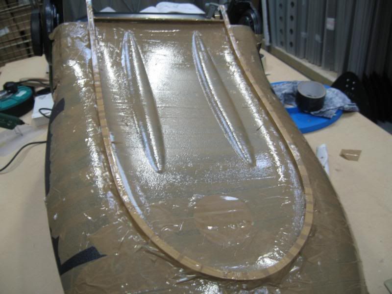

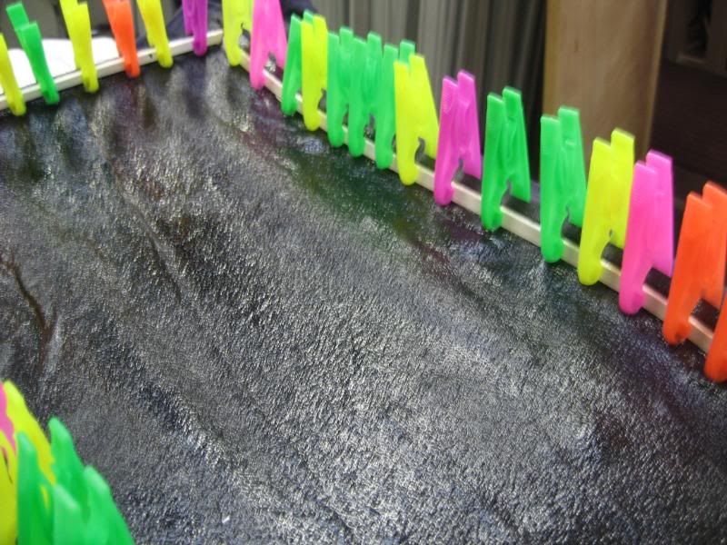

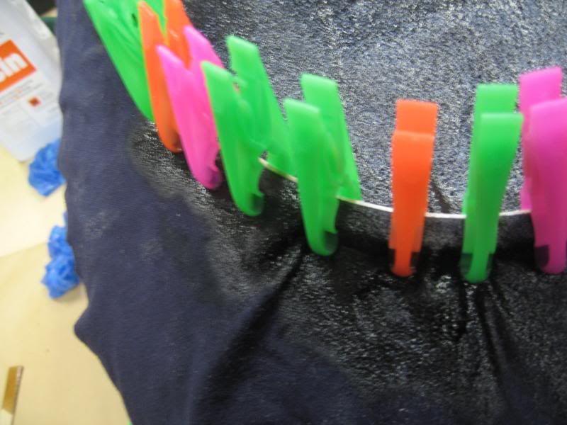

Posted 11 February 2010 - 03:54 PM
strip the seats of upholstery
brown tape the rear so no resin sticks to it and mark out the shape you want
build up the 'negative' of a shoulder detail for flexible LED strip to be applied to once its finished, and then brown tape that also
then resin in some material to form a positive back section, reinforce the edges with plastic strip so nice shape is formed, and peg till stiff ( fnarr fnarr )
this will give me a shape, that fits perfectly into the rear of the seat, that I can now start to build up speaker positions / mounts
TBC. :)
#141 mighty mini jack
mighty mini jack
    Mighty Before a Pint
  • 5,095 posts
Posted 11 February 2010 - 05:31 PM
Did the wife mind you stealing all her pegs martin?
Looking goooooood!
