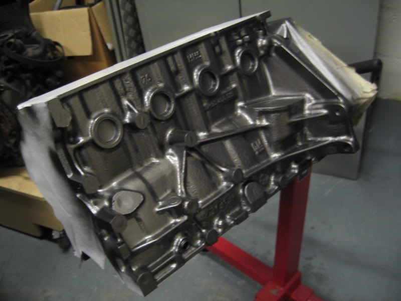

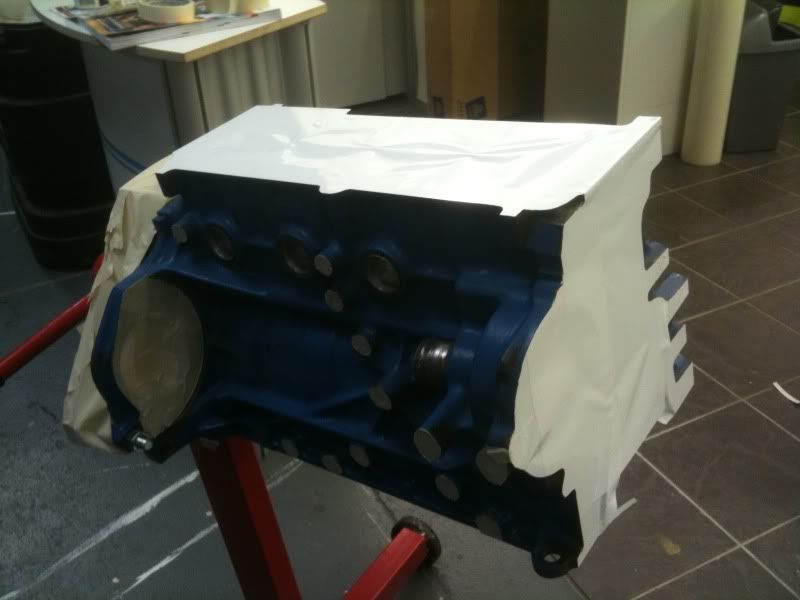

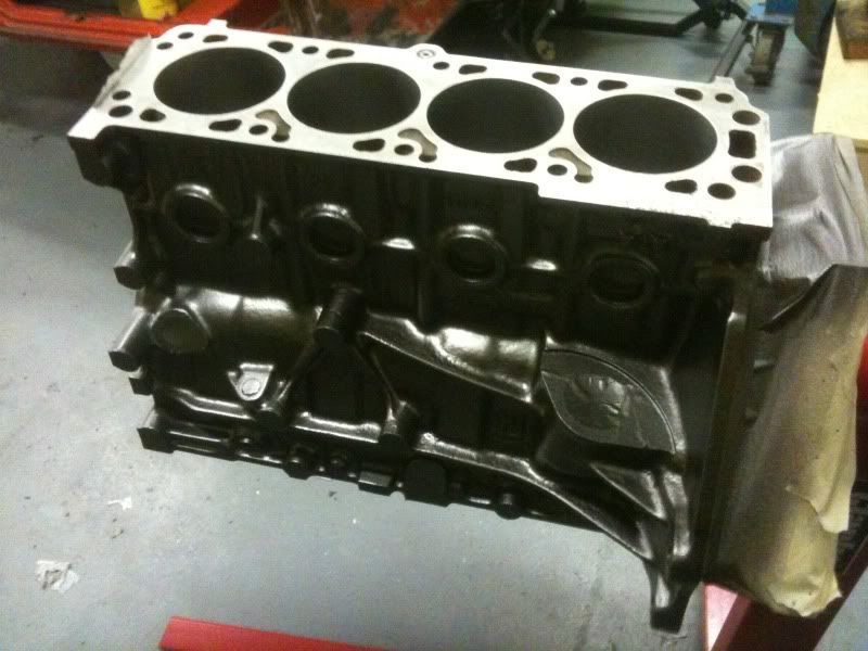

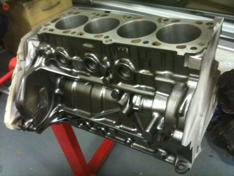

blocks painted !
blue is before - gun-metal is afterwards :)
heat resistamnt clear coat to go on in about a week or so - used black high temp as a base colour, (enamel based ) gun metal metallic as a very thin ghost coat over the top ( also enamel based ) and the final high temp clear should hold it all in place.
high temp clear has a small pigmentation to it, but ti shouldnt show up on dark colour liike this.
bit of an experiment, but my paint Guru ( KEV at NRP ) reckons its fine.
offcuts of sign makers vinyl makes perfect masking agent :P

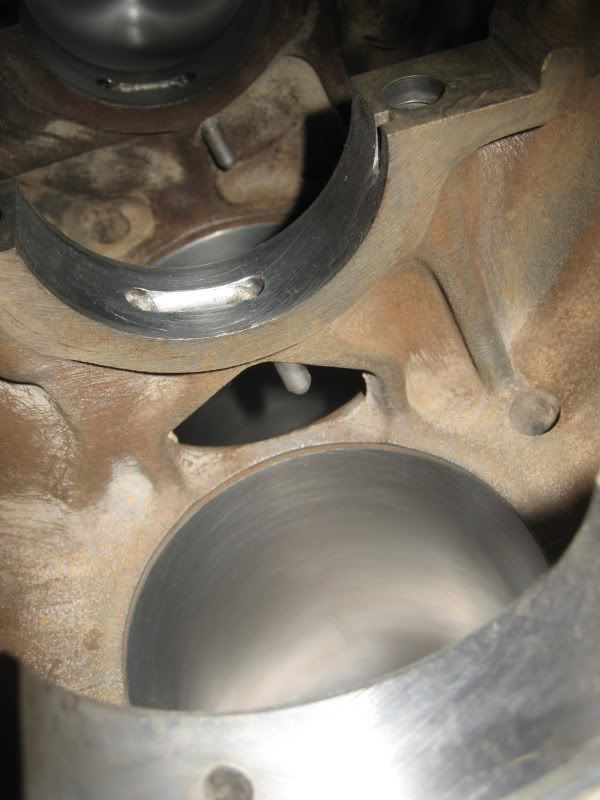

the blocks been bored and honed to 87mm with ball bearing sprung under crown oil squirters which will trigger at around 30psi. Also been dipped and parafin washed.
just need to sort out the flywheel then its a balancing act, and we can strap together the bottom end.

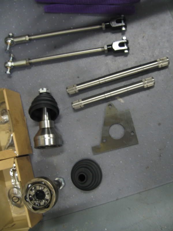

more alspeed parts have arrived - bottom arms, tie bars, HD outer CV's, dizzy blanking plate.

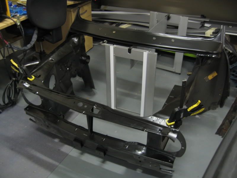

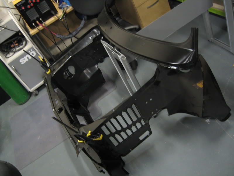

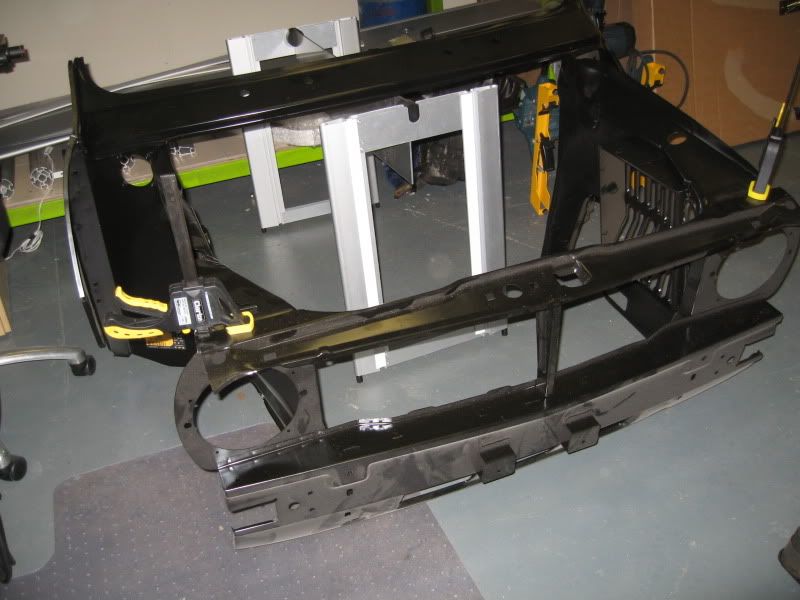

played with new panels, and suddenly its a clubman front end !!
all heritage, and seem to fit together very neatly - hope it stays that way when they come to get welded in :D
ground and painted bottom arms - I hate the look of cast steel so cookie helped by cleaning them up a little - barely an meat removed but now smooth and nice - top arms need the same now really, will do that tomorrow

consensus of opinion - now including Alspeed - fixed front, no flippy flappy-ness.

Would love some more info on the oil squirters, and some pictures if you get the chance :shifty:. I'm not likely to do them, just interested :(

Alex crosse is technical director of engine strap-together-ness, he'll explain a whole lot better - heres a couple of up-skirt shots :shifty:

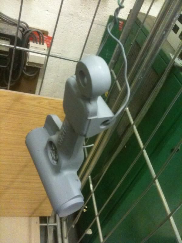

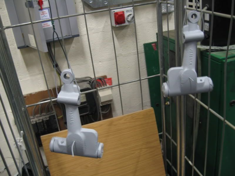

in between graphic moon sillyness and other stuff today, good old cookie got on the black and decker sanding wand, and the flap wheel and dressed down the top arms.
again, no real meat removed, just smoothed out and made a shed load neater. New top arms when they come nowadays are very rough castings with a lot of rough edge detail left on them.
think these will be in the gun metal finish, or maybe gloss black to match the allspeed frame.
