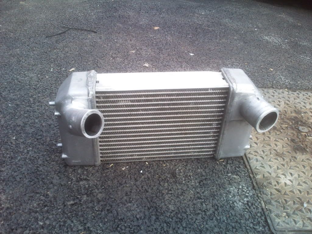

got my new intercooler off a landrover freelander. £10 bargain!
Edited by rick.spi, 13 March 2010 - 05:13 PM.

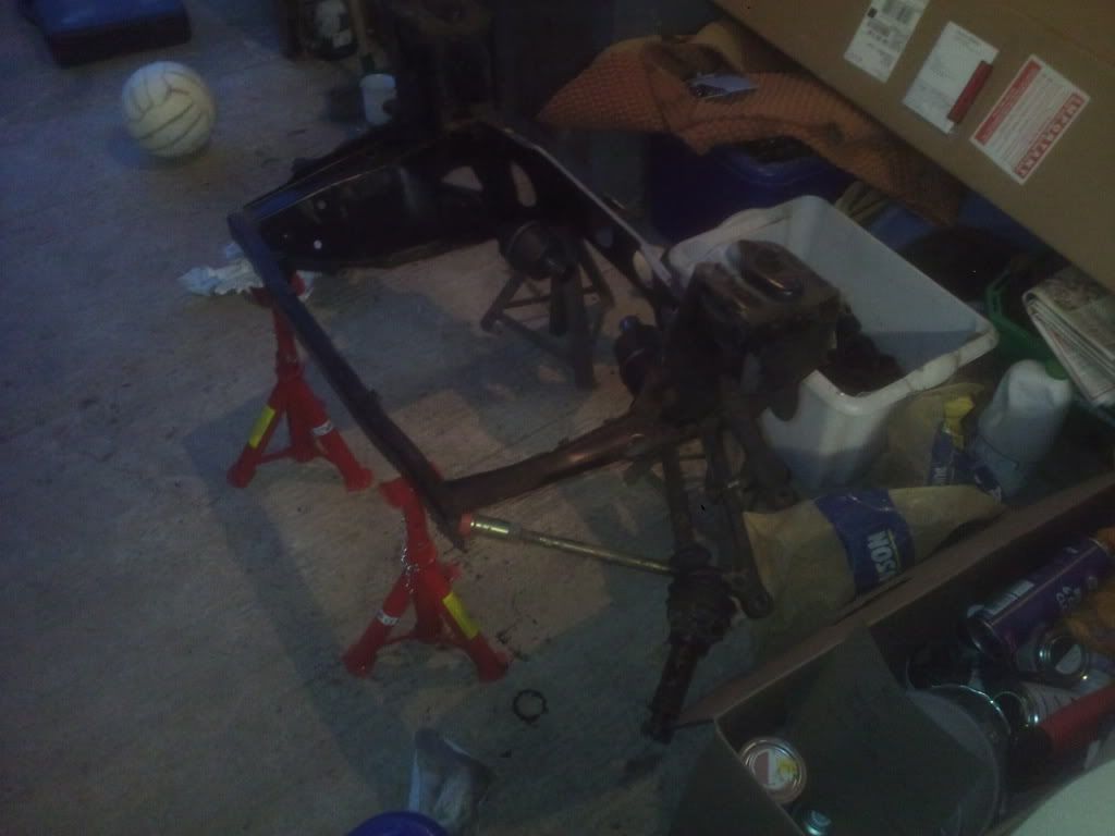

well ive stripped the subby today, and degreased it:

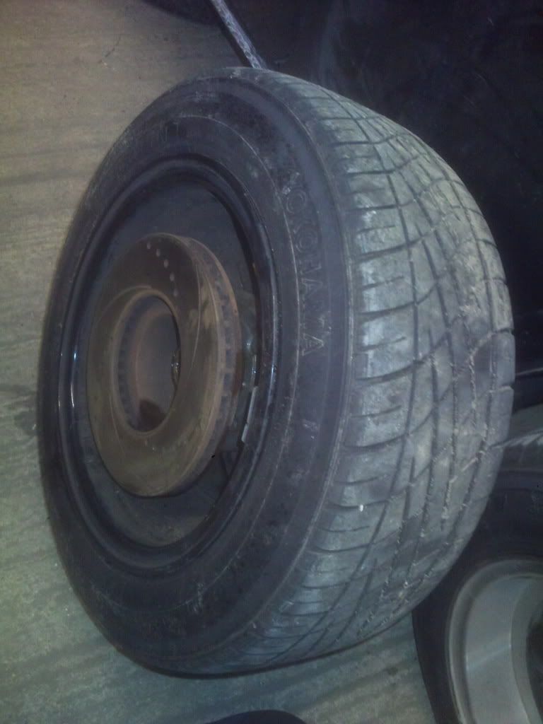

its having all new ball joints, new wheel bearings, and my new hetro turbo flanges and disks on top. the hubs themselves are off and i am going to try and get them bead blasted before refitting them.
put the flages on the wheels for now for ease of storage, it also stops me loosing my wheel nuts :cry: BEEFY :
