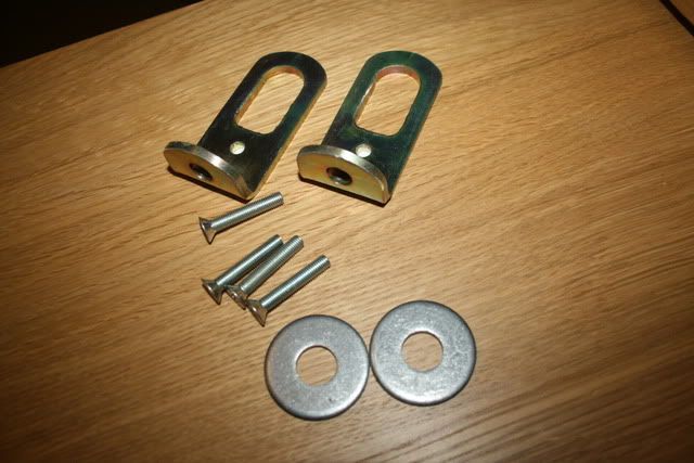

So.. my latest £20 order got me these disappointing boring looking items, I suppose I could have saved them for the next time I was placing a huge order to save postage.. but.. I'm fed up of not having my rear subframe finished! I've popped home again from Uni, so I've got all of today and Sunday to work on her.
