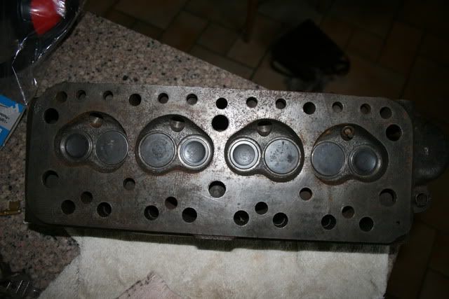

Just got back from Stoke, picked up my new head :)
Lovely bloke, had two automatics parked on his driveway & two estates out back, all in very nice condition. He said the Mini Mine shop was a few streets away, but we couldn't find it >_< probably a good job as I would've only gone and spent a few more quid.
I'll give it a nice lick of BMC green and polish the surfaces, then it's good to get bolted on :ermm:

Posted 19 June 2010 - 02:10 PM
Looking at the gasket surface (don't know whether it's just the photo or not) but it might need a skim bud. It might not seal properly.

Posted 19 June 2010 - 02:18 PM
It's just the photo, I think when my lens is on the wide angle it adds a bit of fisheye to the photo. It's in good shape >_<

Posted 19 June 2010 - 02:19 PM
Ah nice one. Didn't want to see you have to rip the head off to get it skimmed after 10 minutes on the road.

Posted 20 June 2010 - 08:33 PM
may pay you to get it skimmed just to be on the safe side

Posted 20 June 2010 - 08:45 PM
How much is skimming normally? anywhere local you'd recommend mate? never looked into it before.

Posted 20 June 2010 - 10:11 PM
Just a couple of thou should do it mate. Any local motor factors should do it. They'll know how much to take off aswell.

Posted 20 June 2010 - 10:31 PM
Yellow pages look for local machine shops to you

Posted 20 June 2010 - 10:33 PM
At my work costs us £20 for a decent skim from a work shop down road used to be £10 but the place that did it for that got bught by some new guy.

Posted 20 June 2010 - 10:45 PM
Or more than likely just needs a quick once over with some fine we'n'dry rapped round a sanding block and some wd40.
By all means get it check to see if the head face is flat, but if it doesn’t need doing, I wouldn’t bother.
