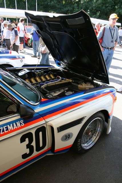

Went down Friday night, stayed in a hotel and went there for the day on Saturday. Absolutely incredible, so many different cars there! all sorts of things.
Few of my highlights..

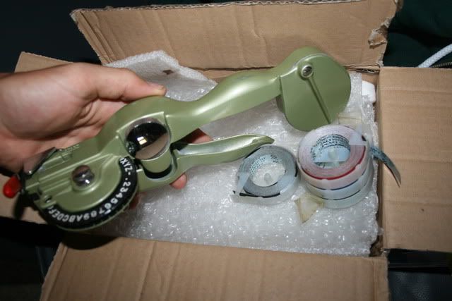

And this came in the post :)
Very early Dymo label printer, with lots of spare tape >_<

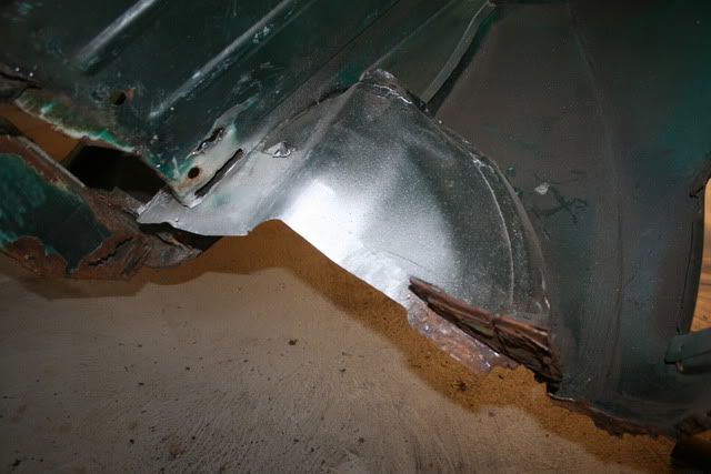

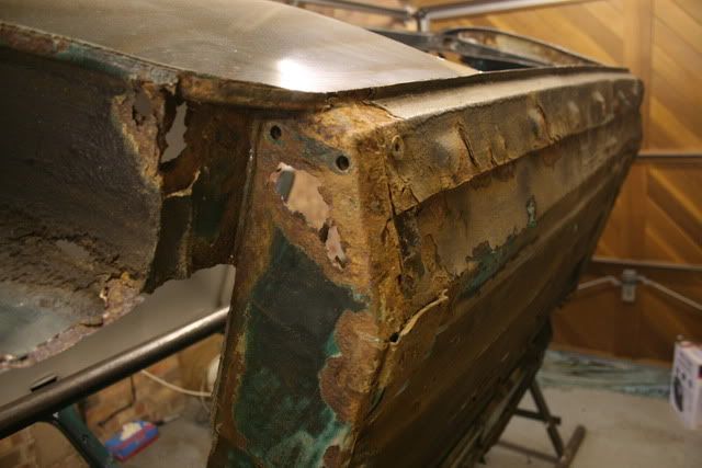

Did a quick hour or two last night after work.
I'm sorry! but I tried! I just couldn't be gentle with it, I tried to grind away the seam welds, but it just wouldn't come out in 1 piece, so it came out in a few. I'll order 2 new ones and weld those.
Could do with picking up some sheet steel as well, what thickness do I need?

ive got one of those dymo label makers, same as yours except mine is a chrome finish, also got a littlle plastic yellow one from the 60s or 70s i think

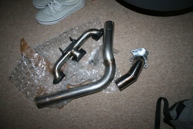

You want 1.0/0.8mm Luke :withstupid:.
Is that a Mirage manifold you're eyeing for your turbo?
I've been up far too late thinking about 998 turboage!
#488 analogue_radio
analogue_radio
  • 4,897 posts
Posted 09 July 2010 - 05:15 PM
You mean this one?
:teehee:
Just paid for my Plenum as well from a member on Turbo Minis, just need a carb and an intercooler now.. plus pipework.

Luke stop it! You're making me want.
I'm wondering how well the standard 998 internals will hold up to the turbo.

I was wondering that.. I've spoken to Wil H, one of the two brothers who own the fastest 998 turbo.. and they said it will cope, obviously I won't give it beans the whole time and I will go gentle. But after she's on the road, up and running, I'll upgrade the internals as I go along to get more out of it.

That's interesting to know. I might have to look in to doing a turbo conversion later then. I just didn't want any bulkhead mods but I didn't realise until recently that the mirage manifold meant you could do it without. I was sat fantasizing about making my own manifold that would put the turbo where the servo would be on some cars.
I believe I read you can get about 90BHP from a 998 with a T2? That could be pretty tasty.

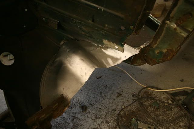

Did a bit more after work today, got the other side out and cleaned up.
Out, cleaned, primed.
These are the next bits to tackle!
I'm in touch with a fabrication place now, will try and get hold of some sheet steel soon and then I can start making patches and get some welding done.

Be carful how much metal you chop out before you start putting metal back in Luke!
If I were you I'd be thinking about putting the boot floor back in to meet the old heel board before I put the new heelboard in.
I just wonder how much strength the rear of the car will have with no floor and no heel board. I could be wrong, someone more experienced should be able to confirm for you :).
