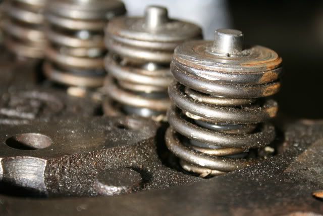

Noticed it has got double valve springs though.. I can only assume they are a bonus.. or are they fitted as standard to 12g295 heads?

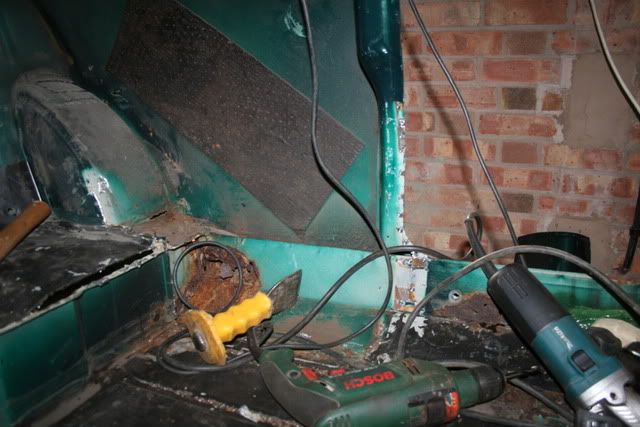

Took the remains of the other companion bin out.
& took that whole strip off to reveal a nice tidy lip.

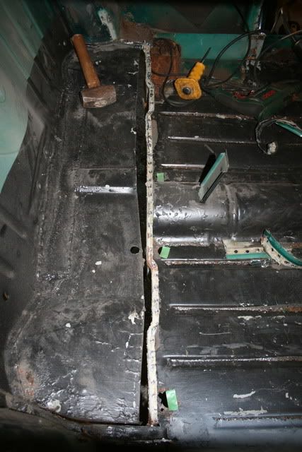

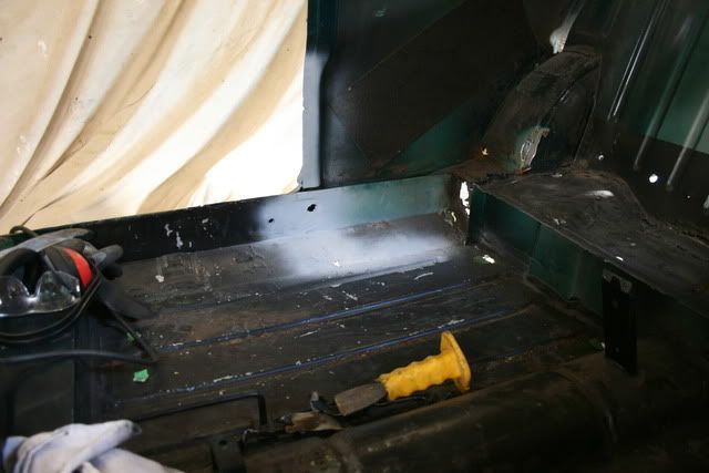

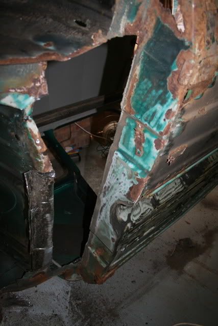

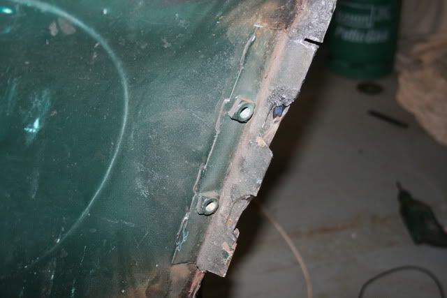

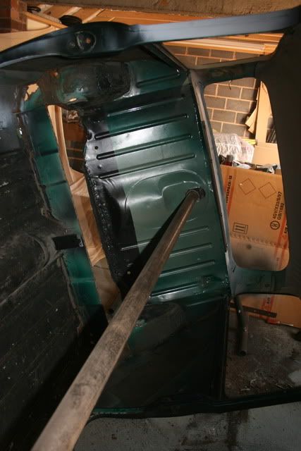

Removing the floor is almost there, bar from a few tricky bits..
Not 100% sure what to do with these bits.. do I leave them in and cut around them?

Yep, double valve springs are standard on the 295 head. What cam are you thinking in using in your turbo engine?

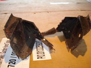

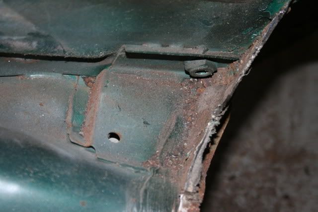

The bits you are not sure what to do with are the bump stops and the rear seat belt mount which are welded together. I took the one off on Project Erm and replaced the rusty bump stops. It all had to come off anyway as the bulkhead in that area was rotten and had to be re fabricated.
Old one
Off
New on
If its not rusty then leave them on and weld to the new arch.

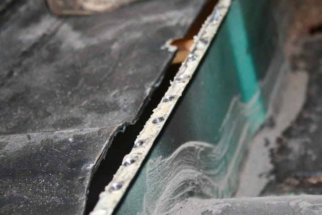

The problem I'm having is removing seam welds.. I'll do a search and see if it brings anything up.

That's a task for some careful grinding I'm affraid Luke ;).

Careful? hasn't really come into my vocabulary lately :thumbsup: I guess I'll have to try and be gentle.
You can see in this photo where someone has welded in a patch towards the back of the rear seat, where the lip is. Which makes it hard for me :cry: I'll need some careful cutting to try and salvage a level lip the whole way along. Just ordered a pack of ten 1mm cutting discs, should help me be more precise.

yep, the 1mm discs are a must, makes life so much easier but they do wear out quick!
