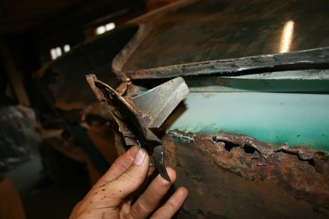

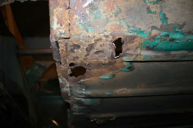

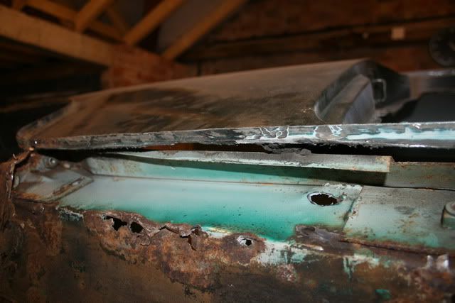

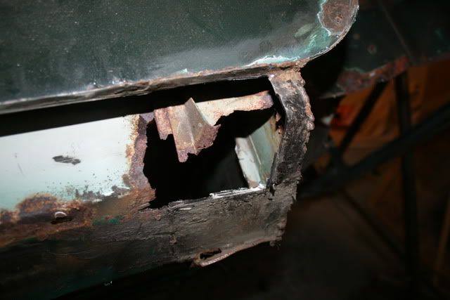

A section of the outersill removed so I can see the underneath. It looks good! Does need a few patches here and there, but I was surprised to see the majority to be solid.
Is this needed? I think it is just a support piece for the jacking point.. which I've removed, and won't be replacing. I don't use it, and it's only a rust spot.

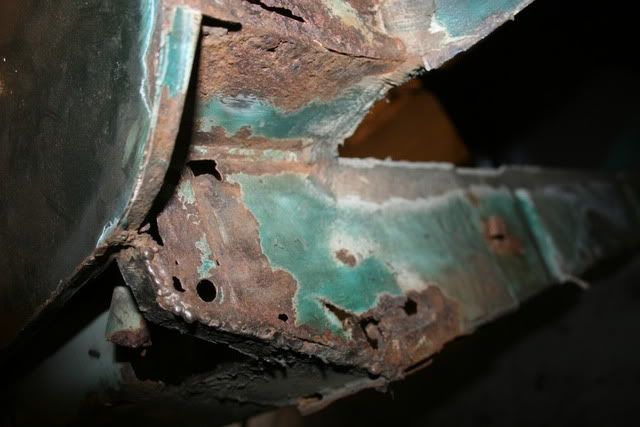

Where the jacking point was.. again, few tears from the spotwelds, but no real rust. I will just cut out a big square shape and weld a new one in.

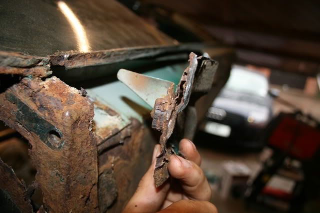

I then spun the car round so the otherside was high, and rinsed and repeated what I did on the drivers side. This side is in a bit more of a sorry state, as you can see from the seatbelt mounting point, but again.. nothing serious.
A previous owner has patched this corner before, I decided to cut the whole lot out to be sure and I'll do it myself.

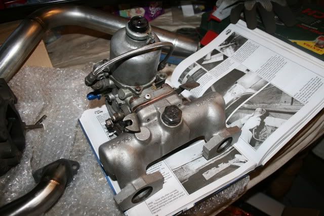

And then yesterday I put a wanted thread on Turbo Minis, and today, this turns up :thumbsup: Hand delivered to my door as well!

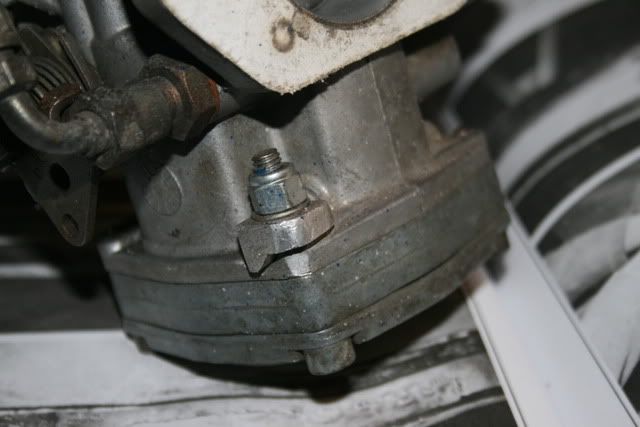

It's a Gen Challenge carb, bit more fancier than the standard turbo carbs. Very clean and tidy!
Almost there with the main turbo bits.. getting there!

Those brackets you've found at the end of the inner sill, no you don't need them, they were used on the production line :w00t:. You'll find another 2 at the front too.

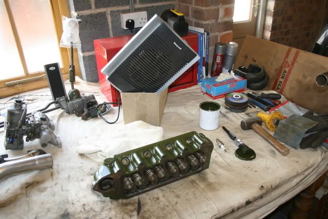

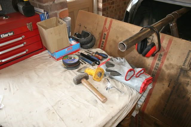

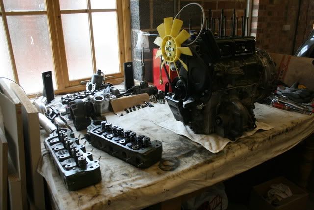

Started today with a well needed tidy!
All my turbo bits, minus the bulkhead box.
Tidy tidy! workbench didn't stay tidy for long :P

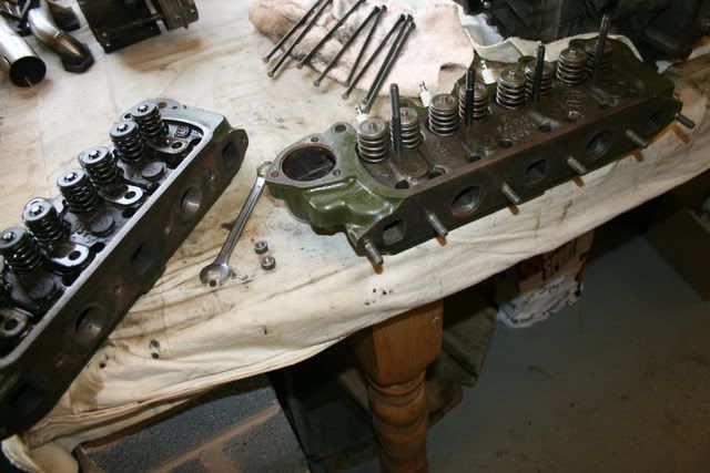

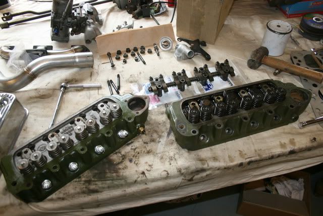

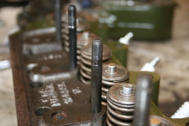

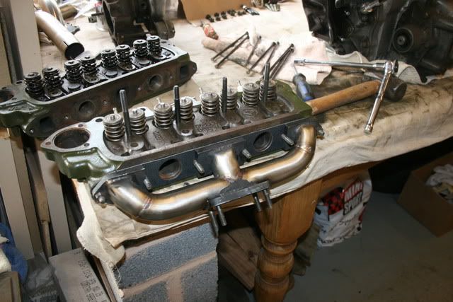

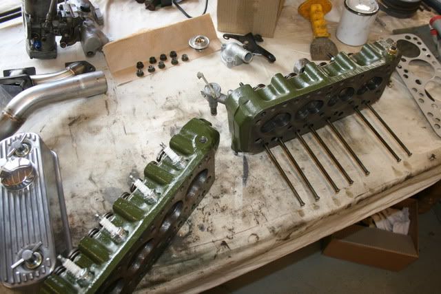

Gave the new head a lick of paint, and transferred the bits across.
Studs out of the old and into the new one.
Then Dad and I lifted the engine up onto the table, but then I realised I didn't have a head gasket, only a cheapo one.. so I'll invest in a good one before putting the head back on.
Took the exhaust studs out of the old head and put them into the new.
Done!

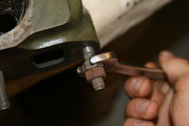

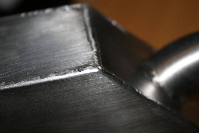

Trying my mirage manifold on for size.

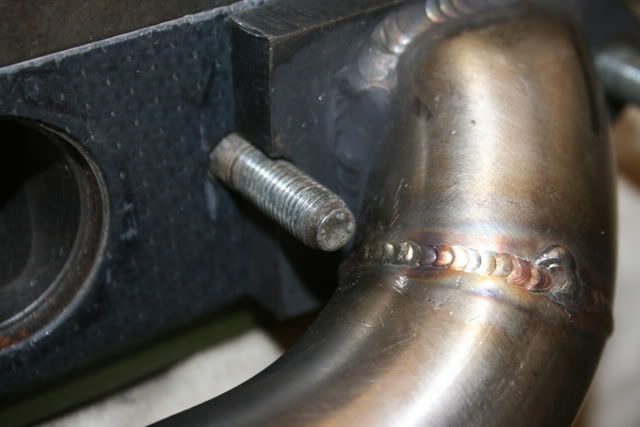

Can't get these nuts on because they foul, I don't want to file into the weld obviously.. so I'll cut a few rings of the thread to give me just enough to get the nut on.

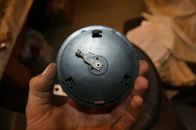

Horn push too :ermm:

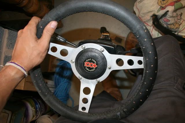

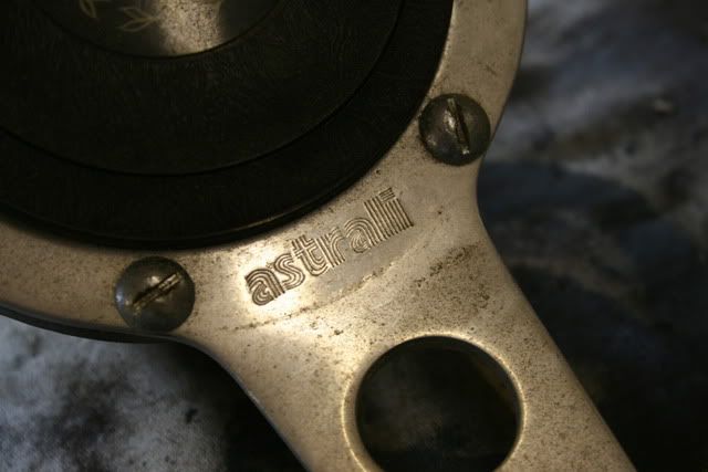

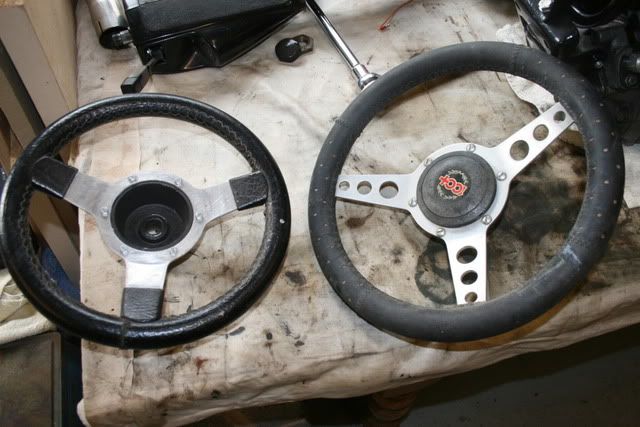

So then I remembered that I wanted to use Dads old steering wheel from his rally days, he said he used this one in a MK1 cortina! I tried to see if it would fit just after I'd gotten my mini, but the spline was different.. I didn't realise at the time I could swap the bosses over!
So I did just that! :)
Can't you just pull the manifold half off the stud and put the nut on with the manifold not seated and move it in as the nut goes down the stud? Just saves you cutting the threads that's all.
#506 GreaseMonkey
GreaseMonkey
    Has Ratchet, Will Make Noises
  • 3,663 posts
Posted 18 July 2010 - 07:11 PM
Look into K nuts from Mirage :ermm: Should sort it

Good idea Andrew :ermm:

Correction: Dad's steering wheel was from a MK1 Escort not a Cortina :lol:
