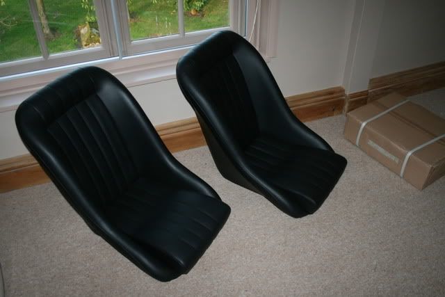

My brand spanking new lovely soft black cobra classics, with the subframes to match. They fit me a treat, can't wait to get these installed. They seem to be very comfy and quite supportive!

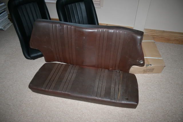

I also picked up a second hand rear seat, looks to me to be around the 70s era.. I picked these up for £15, so I'll get them professionally reupholstered to match the front.

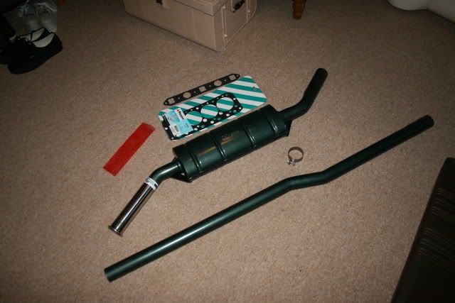

Annnnnd lastly, my maniflow exhaust system :P and a headgasket and exhaust manifold too.

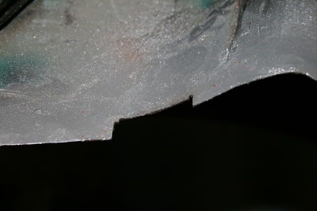

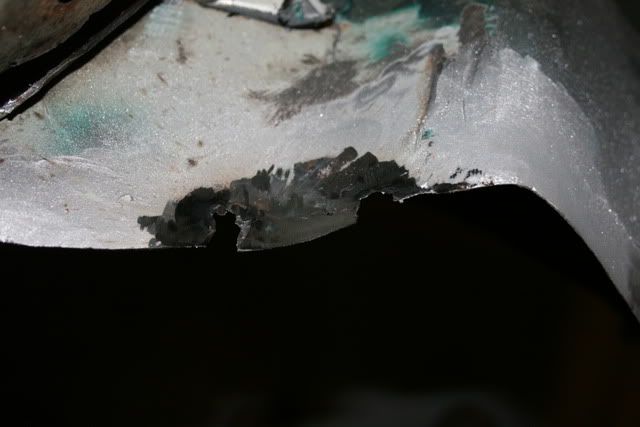

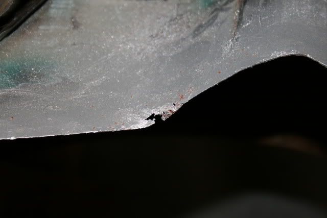

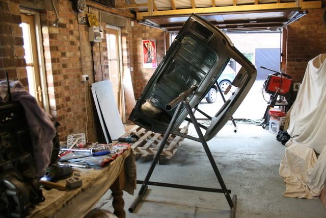

I got my mini back up on the spit..
And I tried some welding!
This is the patch I had a go at welding.. it's quite small and out the way so I wasn't afraid of making mistakes.
Cut the area out, made a template out of cardboard, cut the shape out of my sheet steel and then wire brushed down the surrounding area.
And then after welding it in and grinding it down..
Um :) the patch is in but the metal around has just been eaten away..
The welder is on its lowest setting.. but I think it might improve if I was using argon and not the CO2.. and also if I was doing bigger patches so I could get a run of weld rather than trying to spot here and there and making a mess.
It is a good strong weld though, the patch is held in there well.
Help please TMF :wub:

Posted 18 August 2010 - 08:14 PM
looks quite thin there luke, all you can do is build up the weld by doing little bursts of welding until
it builds up some thickness or if you have some copper , you could clamp that behind where you
are welding and this will help as a heat sink
Edited by camp freddy, 18 August 2010 - 08:17 PM.

Posted 19 August 2010 - 12:40 PM
It looks to me like you might have dressed that down too far Luke.
You'll find that the weld will sometimes sink a little so you can't dress it completely flat without some hammer and dolly action first.

Cheers you two, I'll give it another go tomorrow :) quite excited to get the hang of it all!

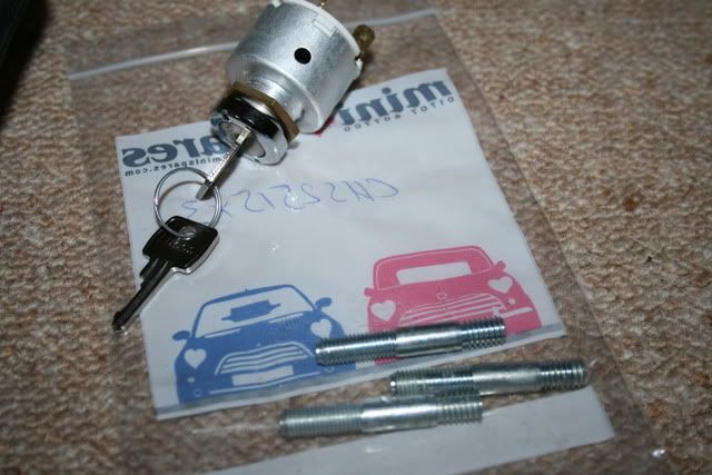

Mk3 rear lights :ermm: I did think about buying a second hand pair from a show, but I figured they are the most prominent feature on the rear end. So spent a bit extra and bought a new set, which in my opinion, was a worthy spend!
Exhaust gasket as well.. better than the one I bought at the show, as its got metal ringlets.. to prevent heat spread, or so I'm told.
Centre ignition barrel and keys, been playing with this :) can't wait for it to actually do something when it's wired up :P
& studs for my thermostat, so I can finish getting the cooling system on.

Posted 22 August 2010 - 05:35 PM
Looking good Luke. Good to see progress with the bodywork.
Aren't those mk2 rear lights?
