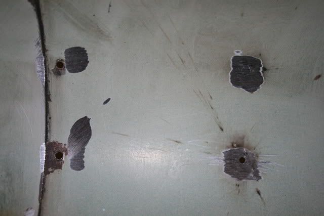

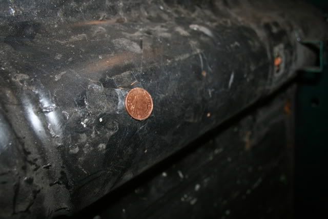

Wanted to get these welded up as they are now useless.. they held the rivets that held the ashtray in the rear.
2 pence piece behind the hole, blob of weld the other side and grind flat.. job done!
All 4 done.
Gave the bare metal a coat of Ku-rust.
And then a dusting of etch :wub:

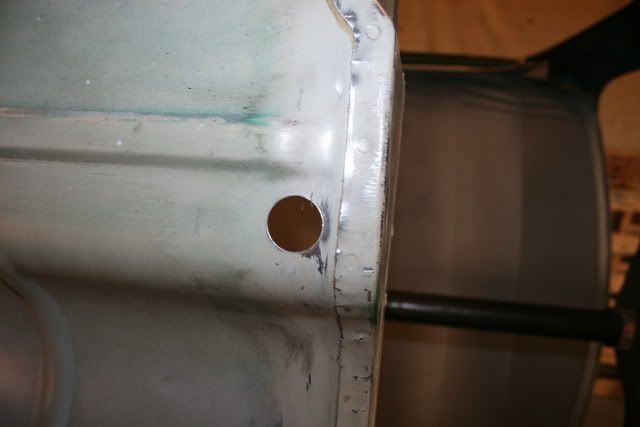

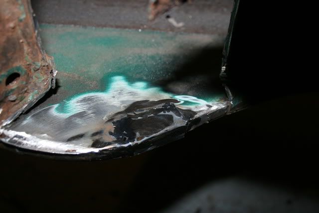

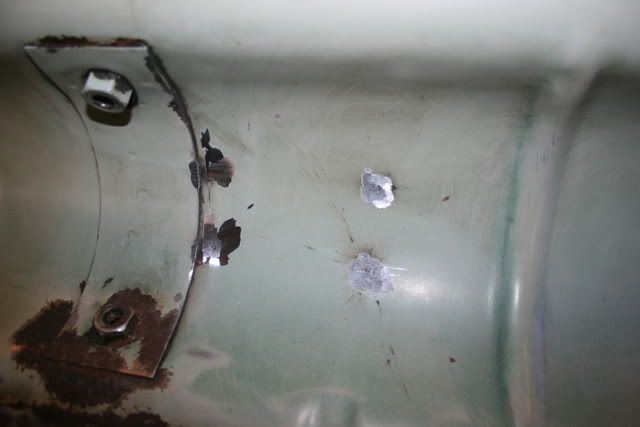

Next drainage hole to fill.

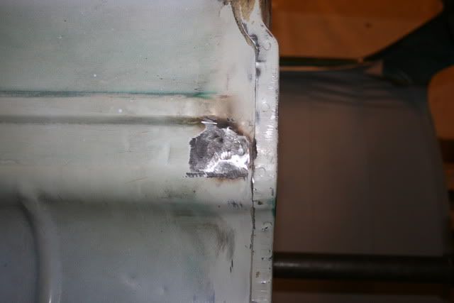

After welding, went a lot better this time! left more of a gap between the hole and the patch.. meaning the weld sunk and it went in nicer.
Etched, looks a bit heavy but it was only a dusting!

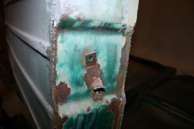

Another bit of the heelboard in the middle that needed some attention, was identical the other side.
Both of the metal tabs removed, all the rust ground down and then a coat of Ku-rust.

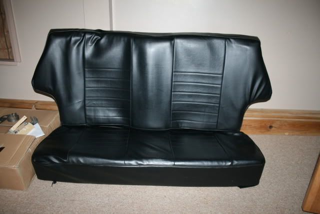

& so did my rear seats!
So now I have two sets :) this is because my idea of buying a cheap pair for a tenner and getting them reupholstered would prove wayyy to expensive. I won this black set for under £30 quid, they do match very well.. although they look very shiny because of the flash. They are a tad compared to my cobra classics.. can you dull this stuff somehow? but it won't be noticeable when they are in place.
& a cool thing is that the horizontal lines match the vertical lines on my front seats! so look like a set :D which some plain black doors cards it'll all work a treat.

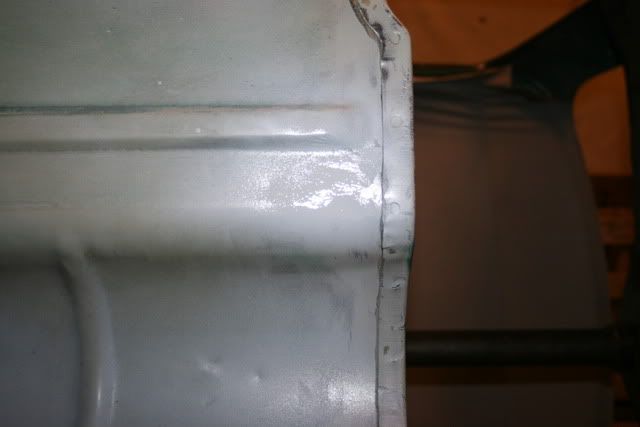

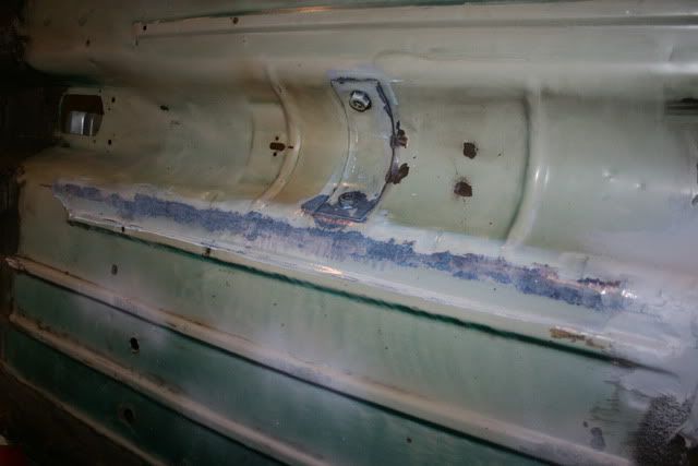

Picked up some seam sealer today from Halfrauds.

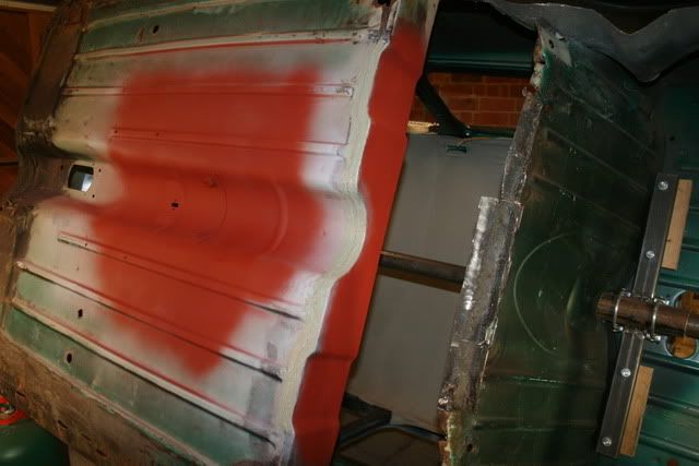

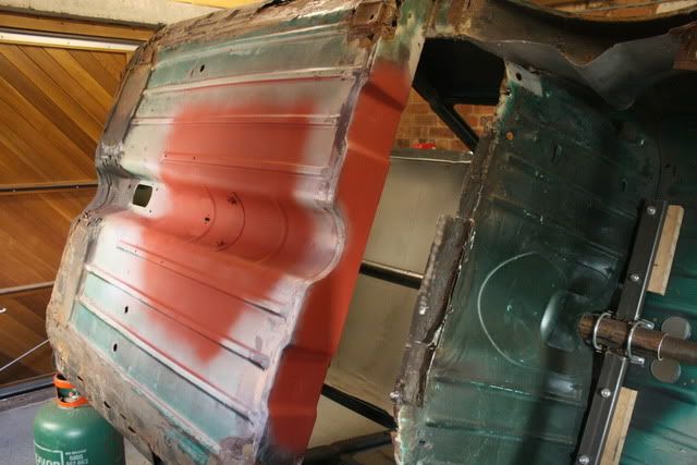

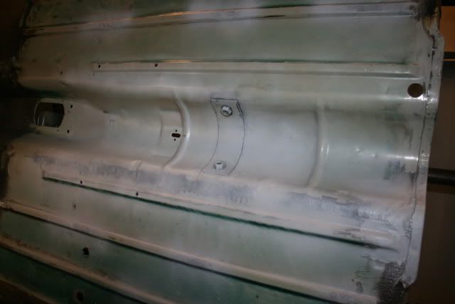

Centre of the floor red oxided.

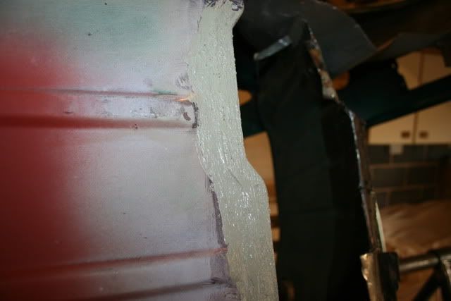

Then the lip seam sealed, it looks hella ugly.. but it will do the job nicely! and as it's out of view it doesn't matter.
Left for an hour whilst I did the bodywork and then covered in red oxide.

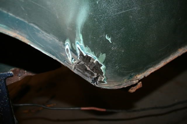

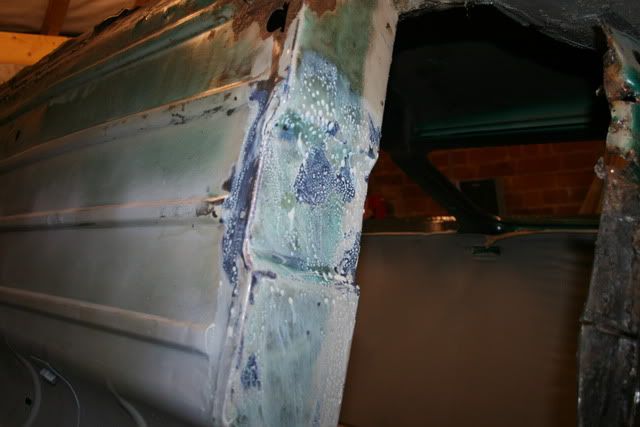

This is the corner I am dealing with first.. will repeat on the other side as well.

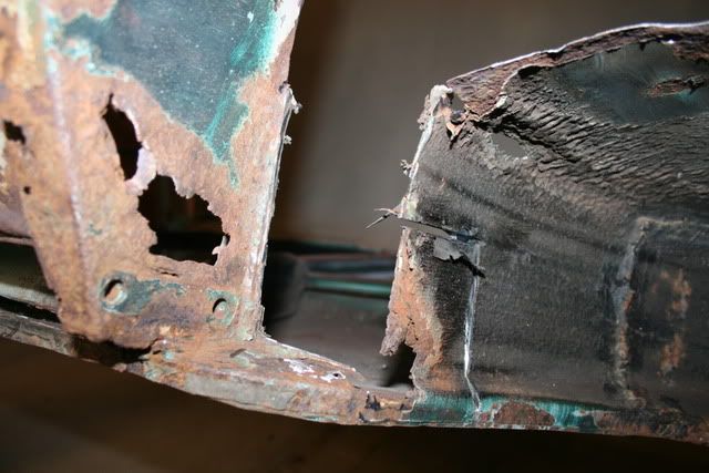

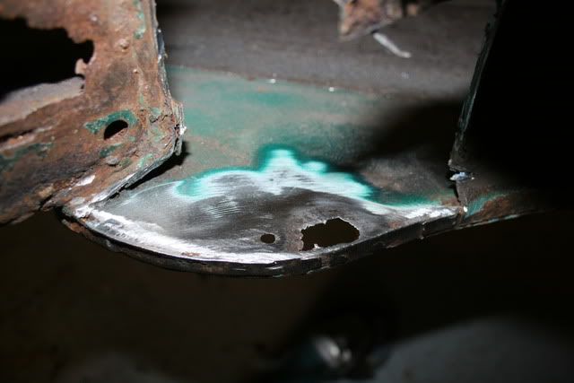

Closing plate cut out, got two on order.
After cleaning it all up it didn't look as bad.
So I got that cut out, patch made and started to weld it in.. but it's getting late and I need to be up for 4.40 tomorrow morning :thumbsup: so called it a night.

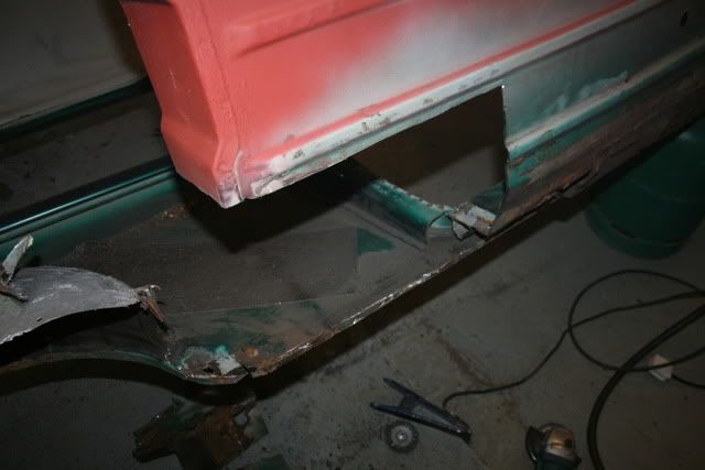

#563 analogue_radio
analogue_radio
  • 4,897 posts
Posted 31 August 2010 - 07:43 PM
Can you see where I'm going with it..? it's all looking very puzzling at the moment!

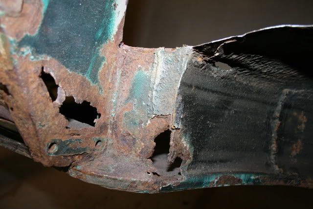

I've got the most emptiest unmotivated feeling in my stomach at the moment.. :)
That is how tonight ended. It does feel good to have all the rusty metal cut out because now it's out of sight and I can start to rebuild it all.. but christ it looks difficult..
I need to repair this section first, then I can put the section of the floor back in.. after repairing a few tears from the spot welds.
& once the floor is built back up I can then overlay the heelboard end and get that welded in, then tidy up the end of the arch and then get the closing panel in between them in!
I'll take it little by little :dontgetit:
