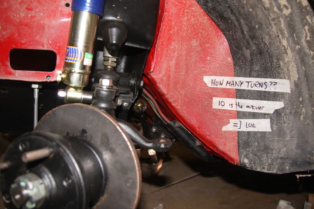

for now, heres a shot of the suspension, yes I really do write with smiley faces and abbreviations :D lol.

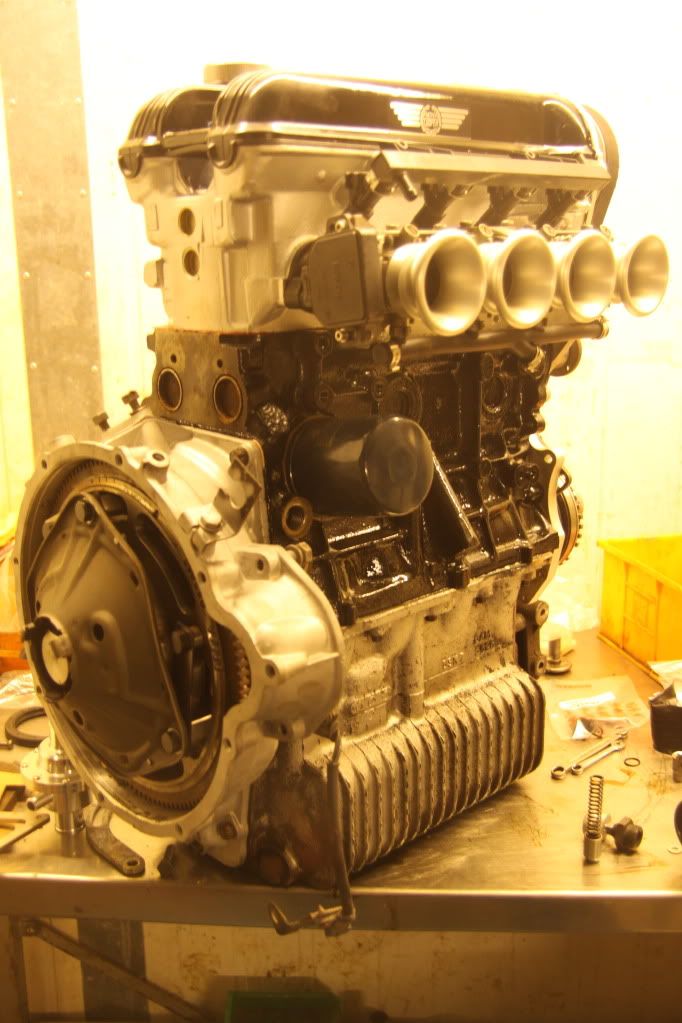

Thanks ;) it's a 1293cc, LT cams(for now :o ) Stage 3 ported head, MED bottom end is lightened and balanced, Ultralite flywheel.
Yes!! It will, but only just - thats why I've used a F/G bonnet, because you need to remove the X brace from the steel one.
Watch this space, because I'll put some pics up over the weekend of how tight everything is :w00t:

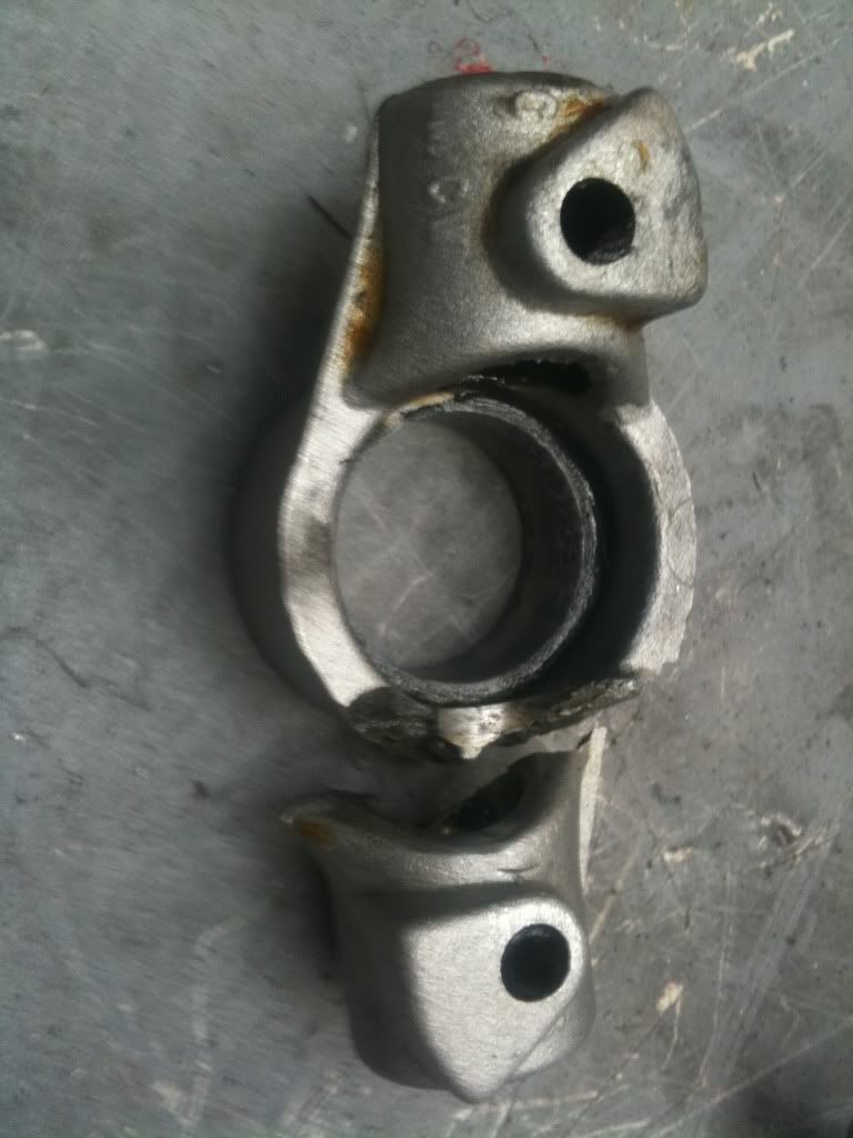

I took the gear change into clean it up, took the base plate off to wash all the grease out and found this -
Broken :( not quiet sure how, so now I've got to buy one of them :ermm:

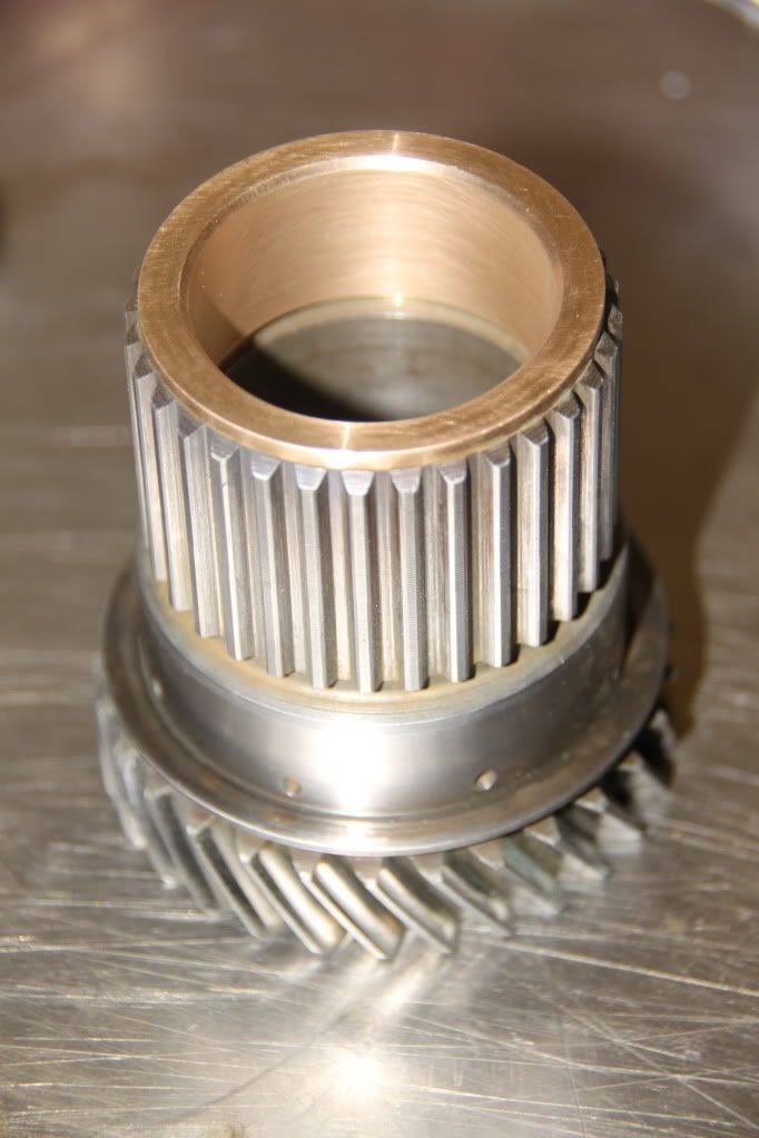

Success!! Well nearly, the primary gear has been machined, and fitted. :D As you can see in the photo, it just needs the clutch cover fitting, I'm painting a clutch arm and waiting for the thrust bearing to turn up tomorrow and then its going in on Saturday!! I hope, lol. Then the headache of fitting the cooling system and other ancillary bits can start ;D
