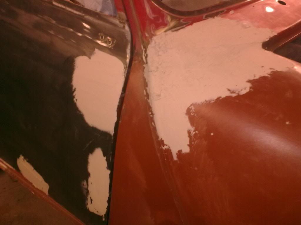

just rubbed down the filler on the rear quarters and re filled :roll: bored!!! they are both really near to being perfect tho :) - this fill will take out all the inperfections on the filler that is already there

rubbed down the rear quarters again...... 95% there.......
then ran the sander over the doors and filled in a few bits and bobs......
got the boot all sorted ready for primer - the inside needs prepping yet....

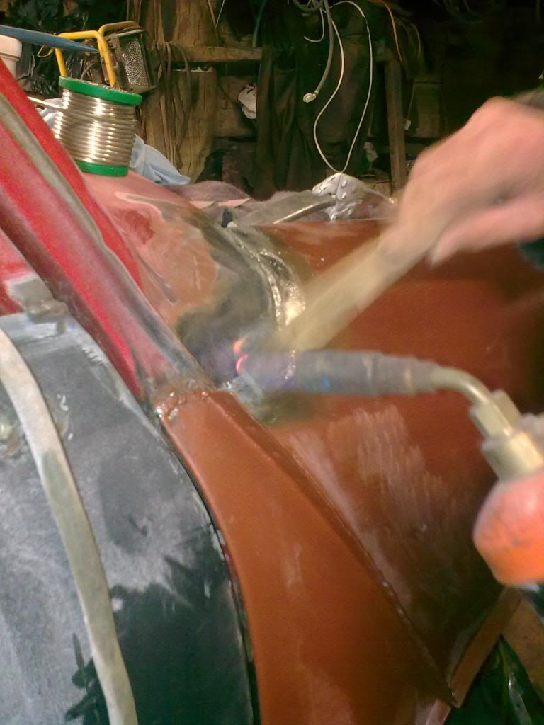

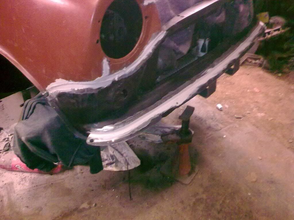

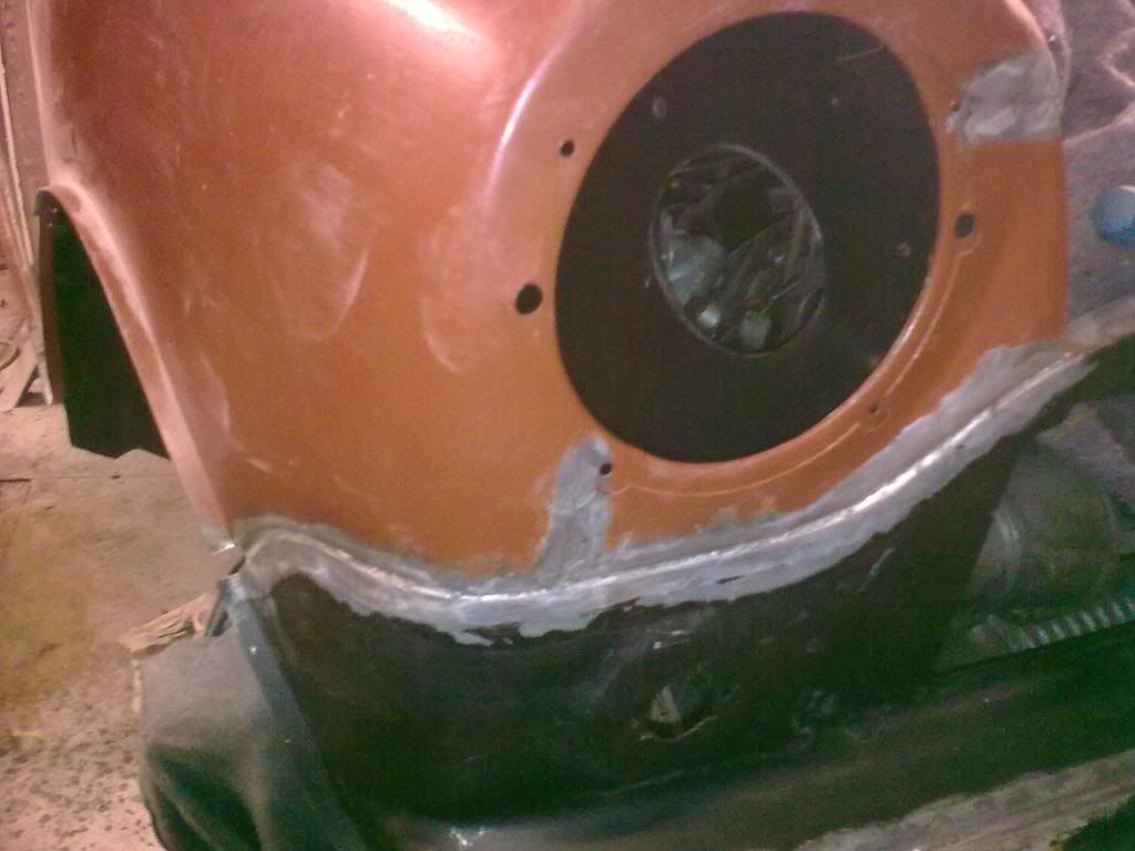

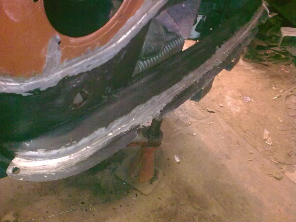

and fonzy with the delivery for the solder paint ;) lead loaded both the scuttle joins and the wing to front panel joins :) - he has still got to do the 2 seams around the headlight and the bumper lip seam......
then i went around filing back all the seams...
well chuffed with how it turned out!!!

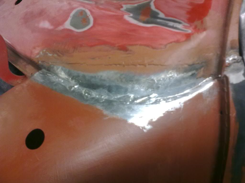

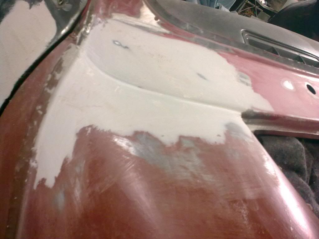

drivers front seam
and drivers scuttle filled!!!!
there is rather a lot of filler there - but i'm not 100% happy with the line up of the panels/the scuttle repair.... - but because of the lead the joint won't flex so will be fine ;)

scuttle join 95% sorted on the drivers side....
i'm really happy with the end seam it looks really good!!!
still working on the passenger side....

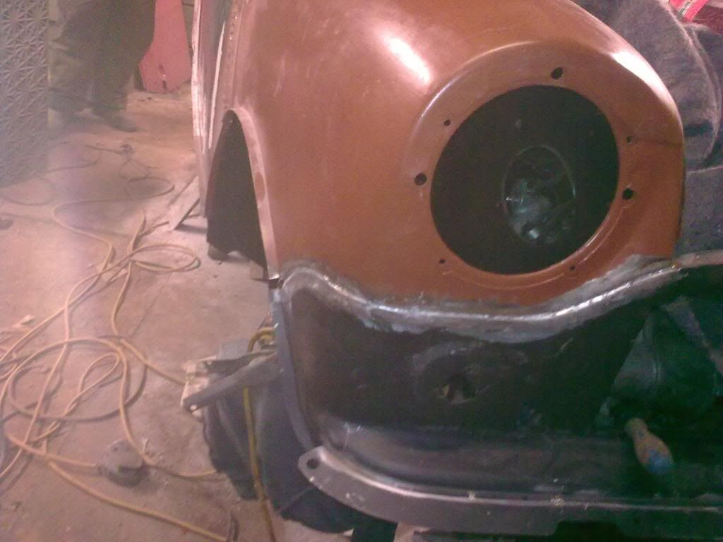

Fonzy finished the leading on the front end
then i filed all the seam down and ran a quick bead of filler over then

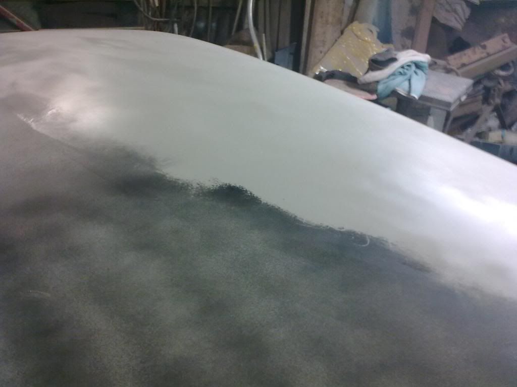

and the roof
half done!!! - i did a quarter of it the other day so that bit won't take long to rub that over qucikly again and then do the other quarter...
