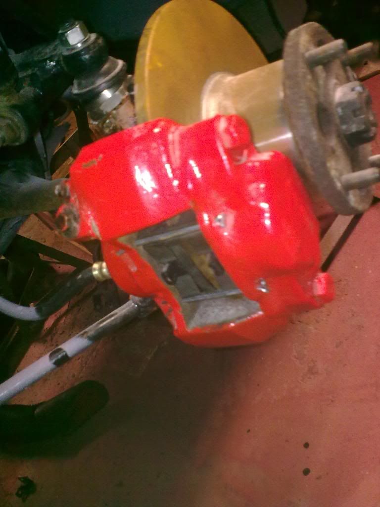

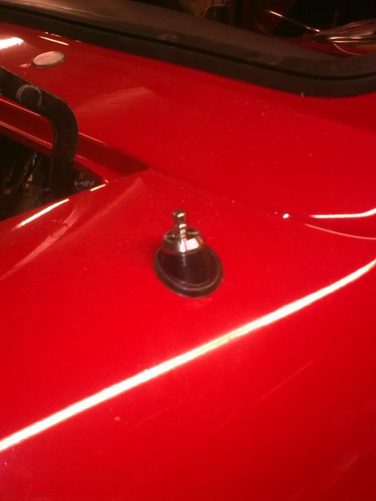

Day 60 - 8 days to the MOT..........
fitted the wiper motor braket inplace, then the aerial
its stupidly long.....
then the front brake fixing kit
then the handbrake cable
and fonzy fitted the gearlinkage and CV boot clips....
it went through all the gears fine..... so thats a good sign.....
then i stuck the rear wheels on to adjust up the brakes - they need a good clean!!!

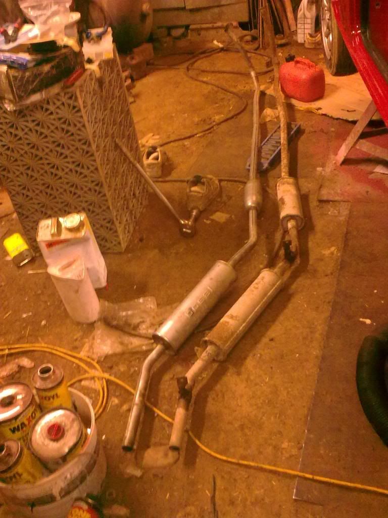

and dug out the exhuast to go on it and a old one with some fitting on
the exhuast to go on it came free from our club members who helps as pick it up with the trailer - the exhuast is like new!!!
then once i have swapped the fitting over - the exhuast connected to the 2 back mounts and lined up at the front to fit on the manifold....

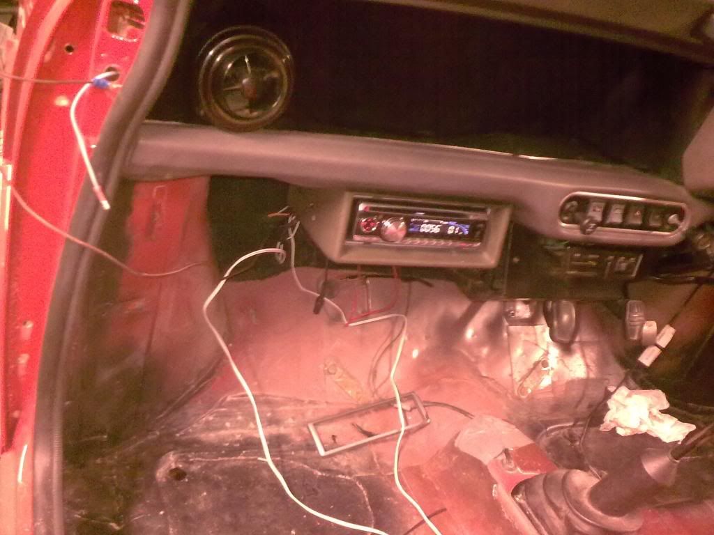

Day 61..... 7 days to the MOT
MOT is offically booked!!!!

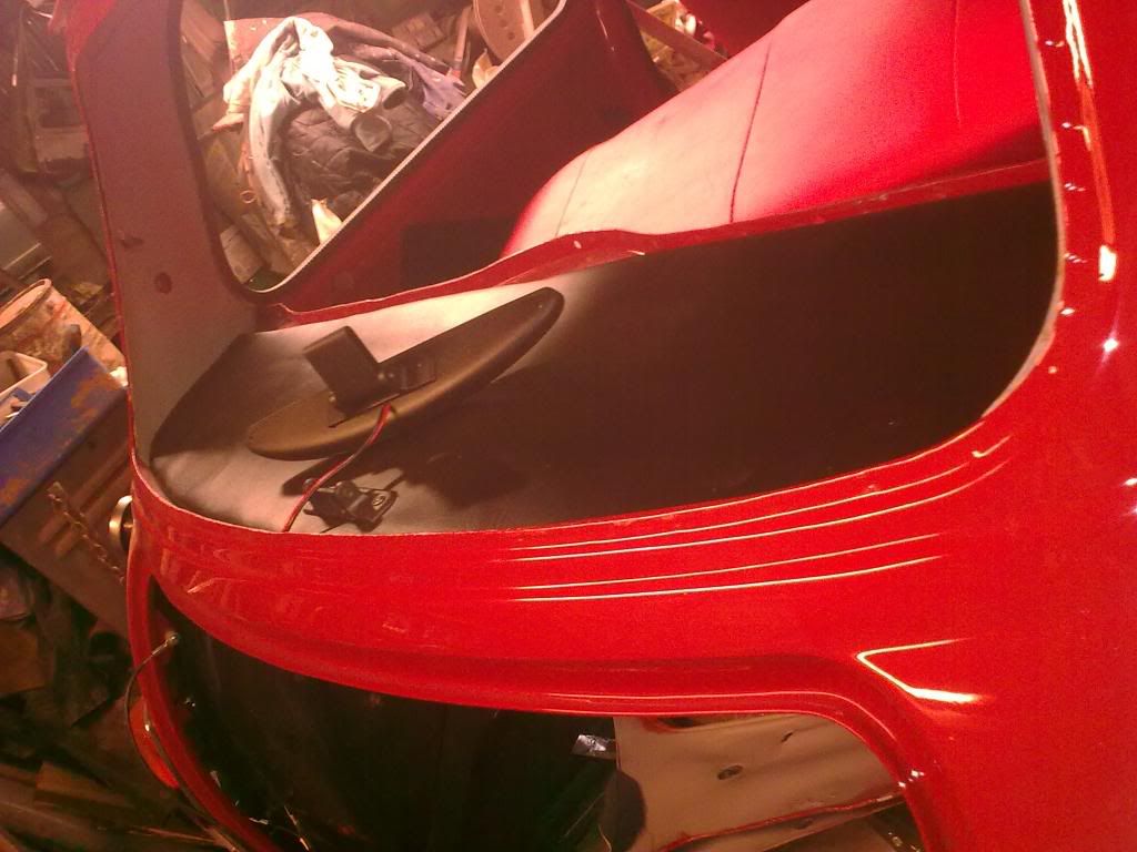

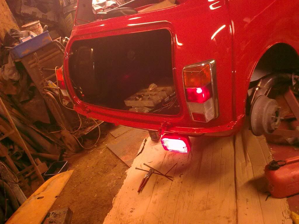

went up tonight covered the rear parcel shelf in black vinyl and reglued put of the rear seat

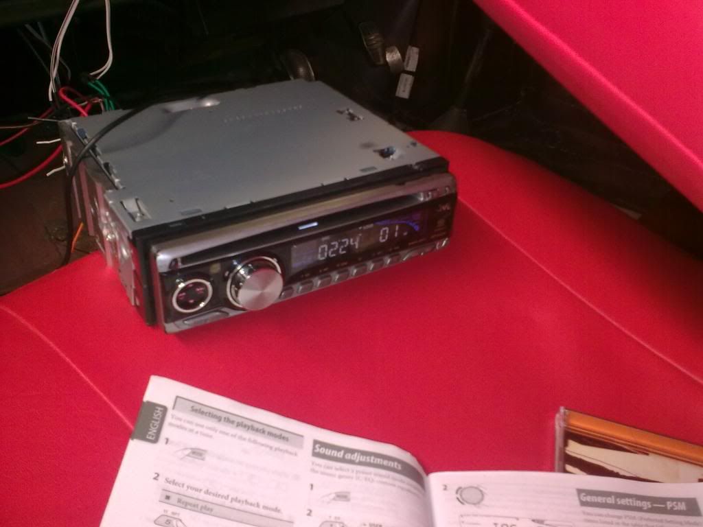

then dad had taken the stereo to be checked and it was fine, so plugged it in and
it works whoop whoop

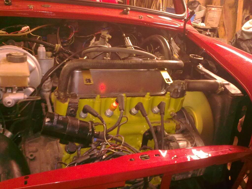

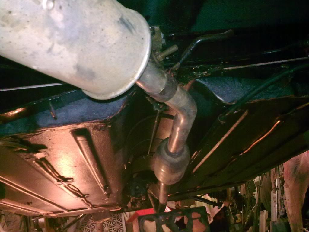

then i fitted the exhust to the manifold - i'm very well practiced at this after the sky went through a phrase of only lasting a few days before it started blowing again !!!
so with that fitted, we chucked some water and petrol in it, then after a minor water leak from the temp sender and a minor fuel leak from the pump to carb/fuel filter pipe:::
it runs :(
with a healthly spark :ph34r: - the tappets need reseting but apart from that its fine
we also tested the clutch, went through all the gears alright again, and we ran it in first and second :) - while sat on the floor LOL - almost went 30mph!! LOL

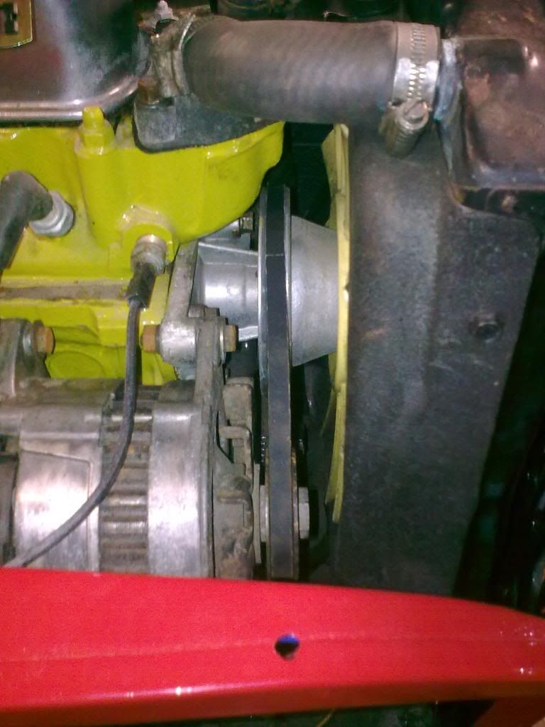

we have to 'alter' the water pump slightly too, we had this problem with the sky and is resulted in the fan belt snapping, then it overheating and eventually a new rad and head gasket.....
the waterpump is pushing the alternator out too far and its not inline with the other pulleys - so i'll have to take the alternator off and get a grinder in there......
also fitted the new parcel shelf and the bracket for the high level light - i'll finish putting it on when the rear screen is in..
and put the Skys old C pillar trims in to replace the red ones.....
and took the front rubber off the car and back on to the screen
god knows what pecks was doing with it!!! FAIL PECKS!!!
then fitted the stereo in the holder
it did decide not to work again then i re-earthed it from the heater screws to the door pin switch hole..... i'll drill i hole under the dash and earth it there.... the main thing is it works - i've just gotta fit the ipod adaptor for tanya now!!!

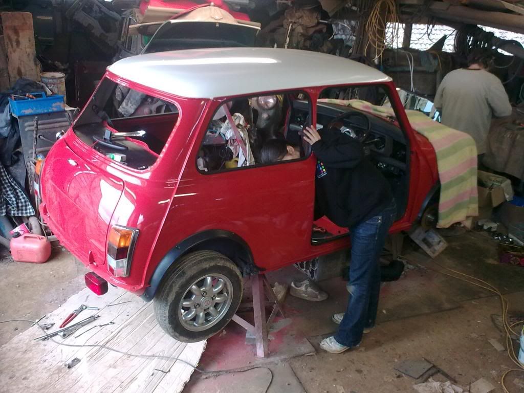

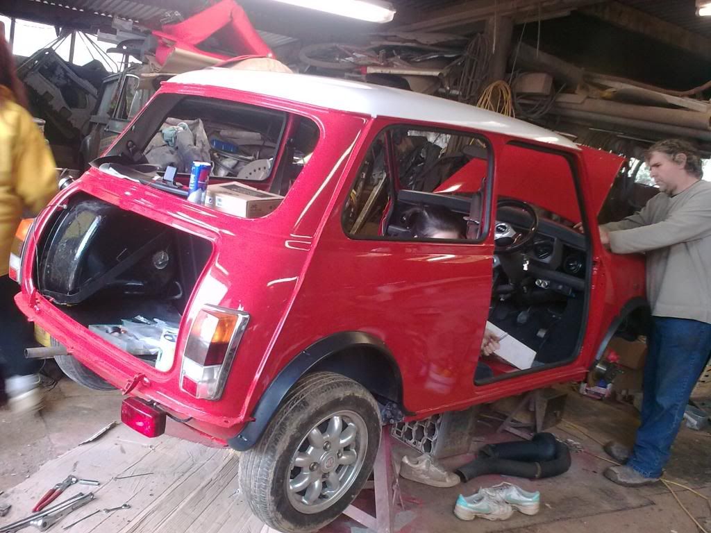

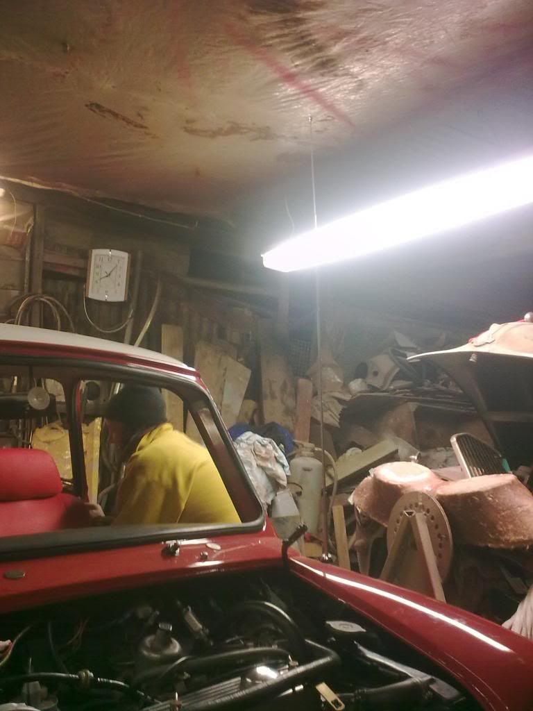

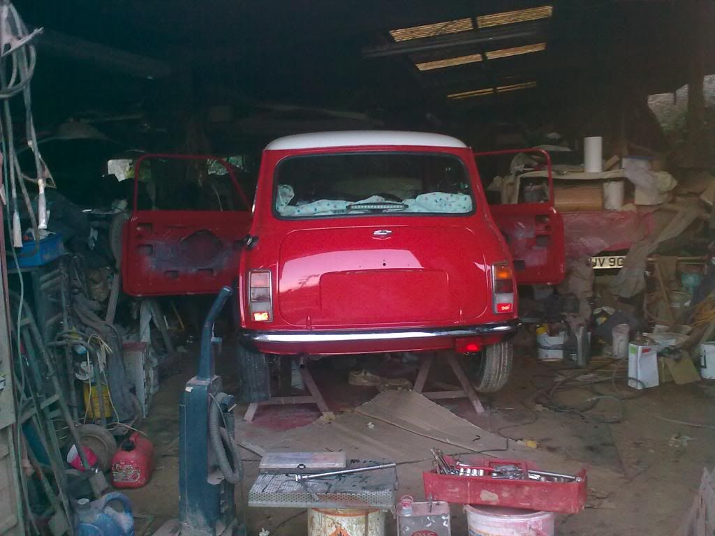

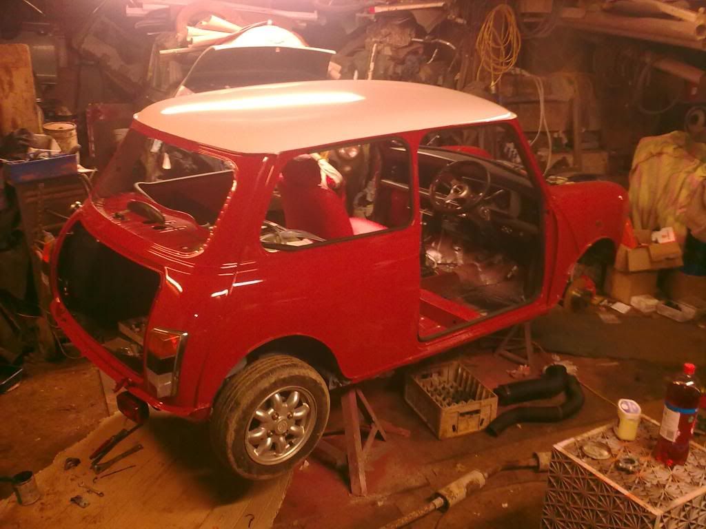

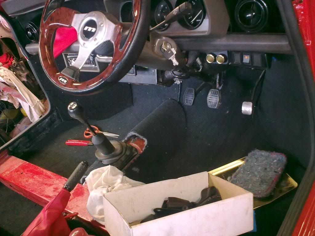

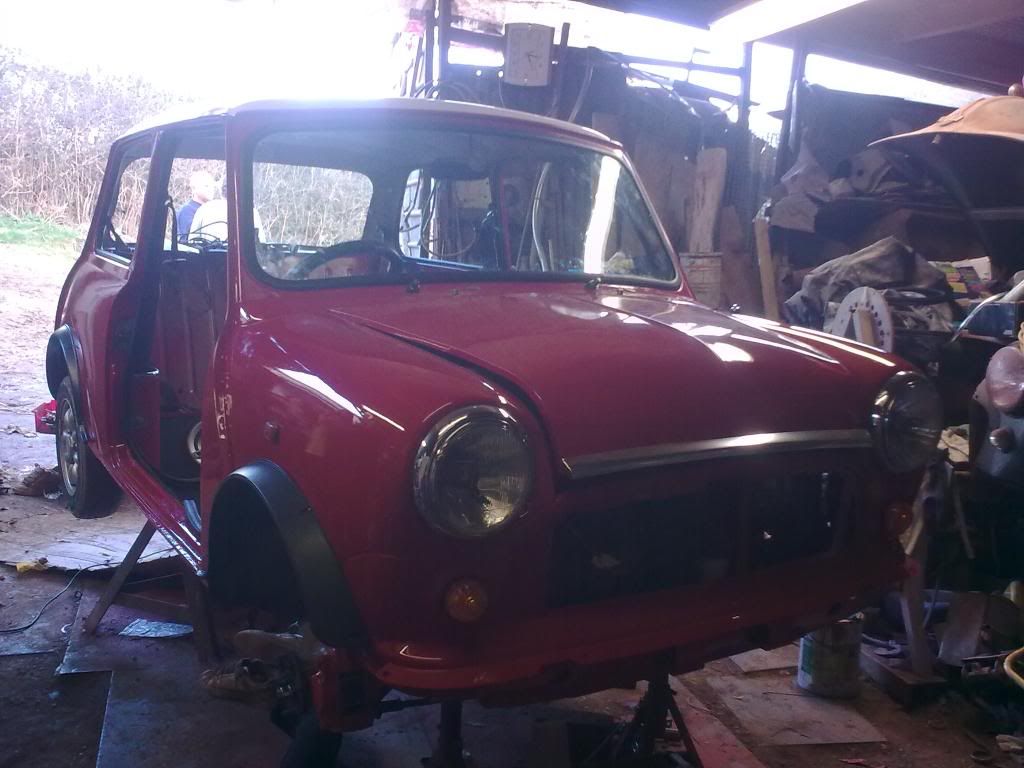

day 63...... 5 days to the mot.....
right we've done LOADS today - probably missed half of what we have done off too
errr. fitted the bonnet - which needed a some extra welding on the hinges as it was flexing on them.... fonzy have to move the hinges when he lined up the front end as there wasn't enough adjustment on it

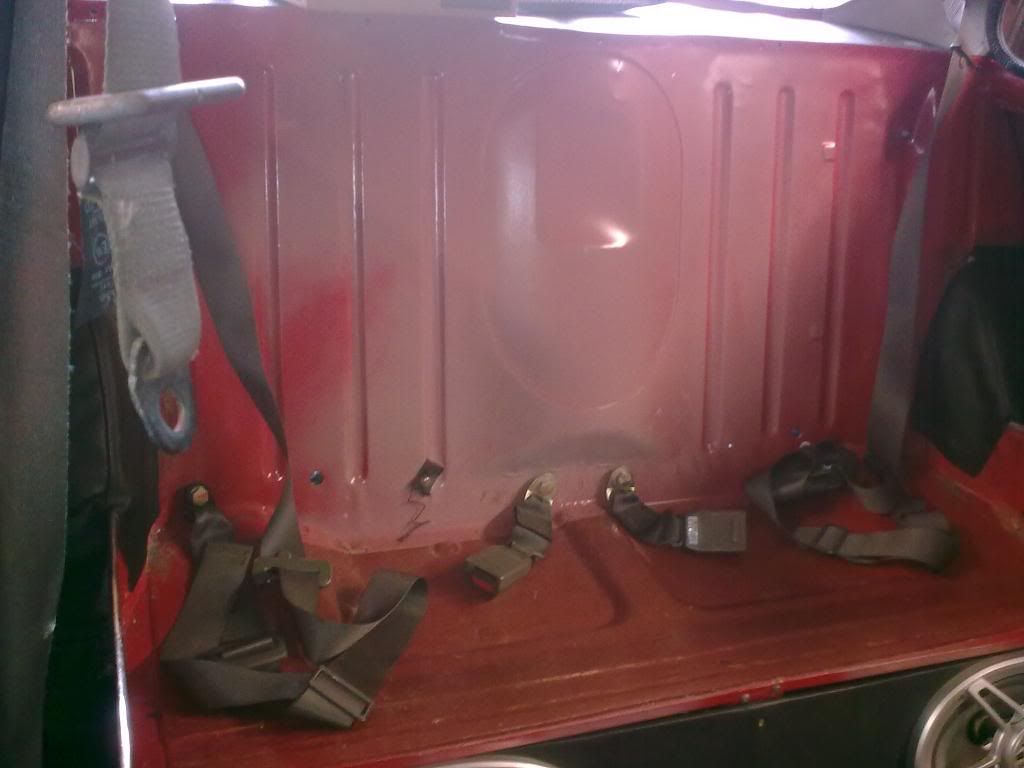

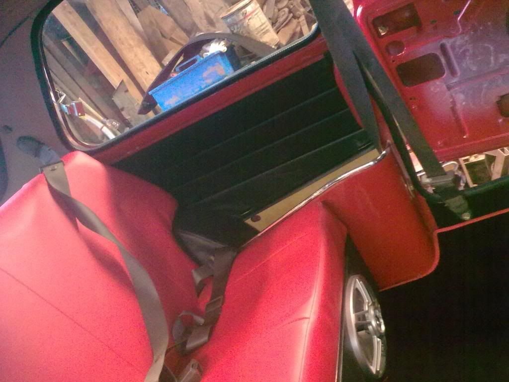

then tanya has been fitting the underlay and seatbelts
ben er played a lot then fell over and cut his knee :P
then the boot went on

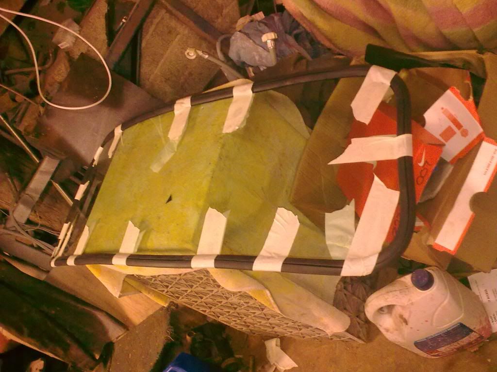

then after a MAJOR struggle the front screen went in
it has got to be the worse screen we have ever fit.... the rubber was slightly too big and kept coming off the screen was we were trying to fit it!!! - my and tanners worth both hoding things in place as dad pulled the rop.... it really wasn't good!!!

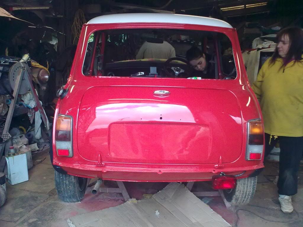

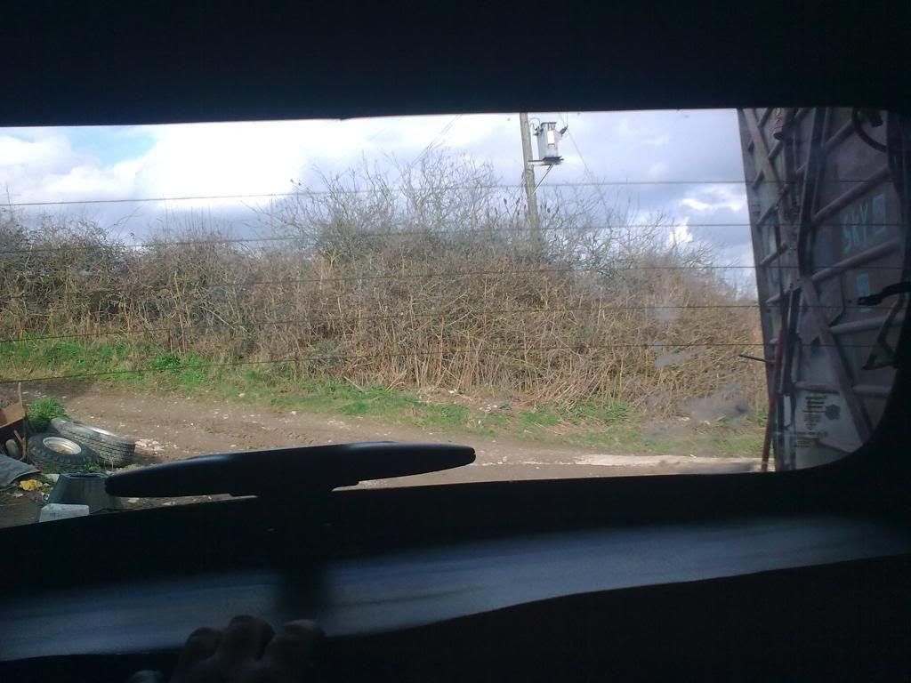

then the back screen went in much better
high level brake light ohhhhhh :(
tanya doing something
oh yeah pecks put the wheel arches on and i put the seam strips on
and we had Tanyas ipod playing throught the stereo

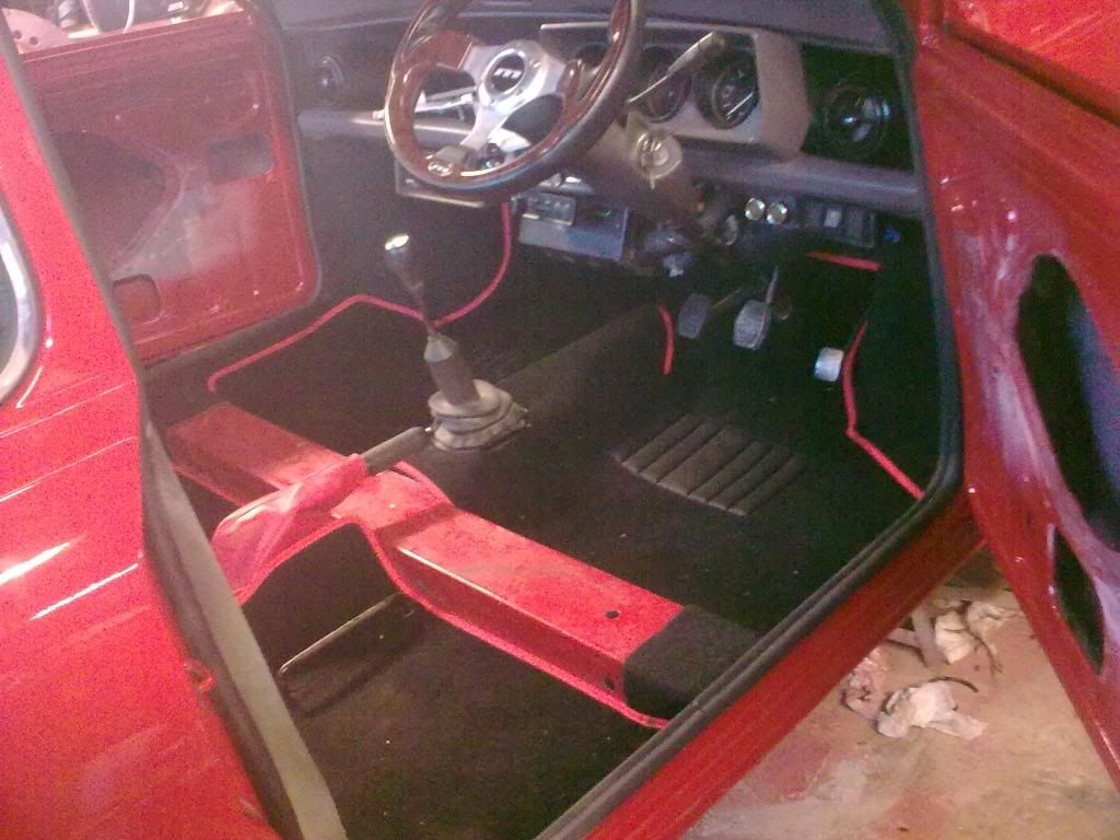

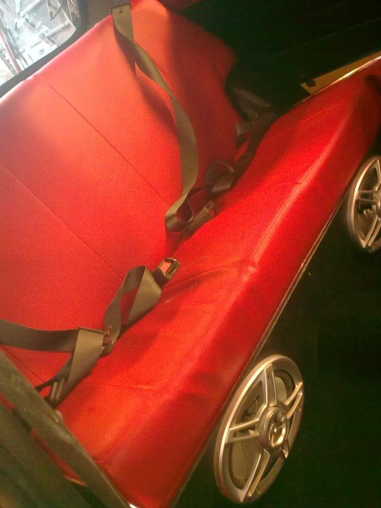

then the back seats and doorcards went in
and tanya got very excited and felt the need to sit in her mini with her seatbelt on....
then the full carpet went in :P
and the doors and front wheels :) - after we tightened the hub nut earlier!!!

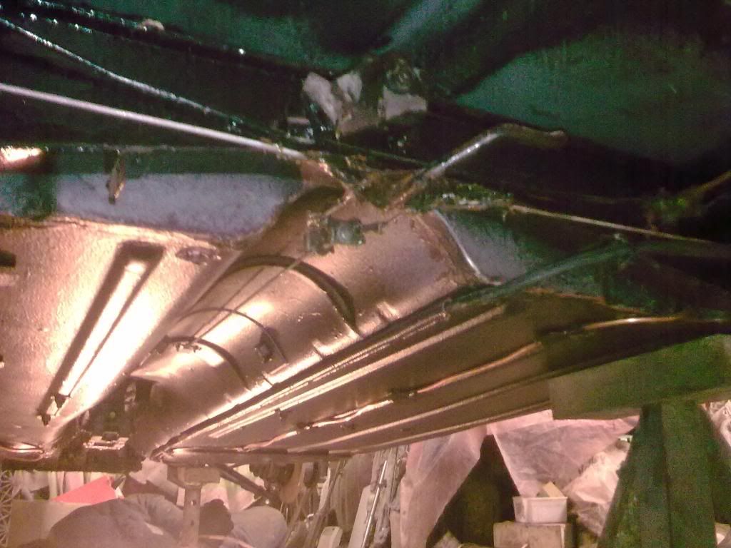

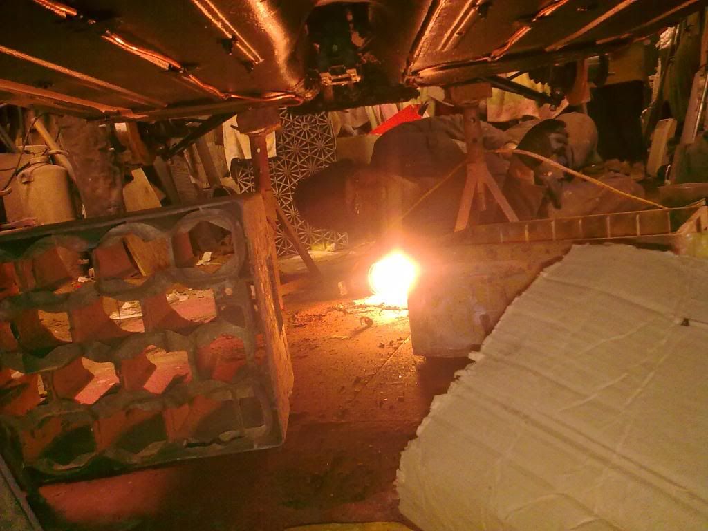

then we thought it would be a good time to waxoil the doors and rear subframe, so the doors are left open dripping of waxoil!!!
very productive day - and off for a test drive tomorrow - just a shame our garage is on a muddy farm ;) - there will be a muddy mini tomorrow.....

oh yeah - both bumpers are on - just none gen ones are completely pants!!!!!
and the rear side windows are half in, then screws at the back aren't done yet as the skys old c piller trims dont have the holes for the opening rear windows and it was the last thing we did - so that will be done tomorrow...
