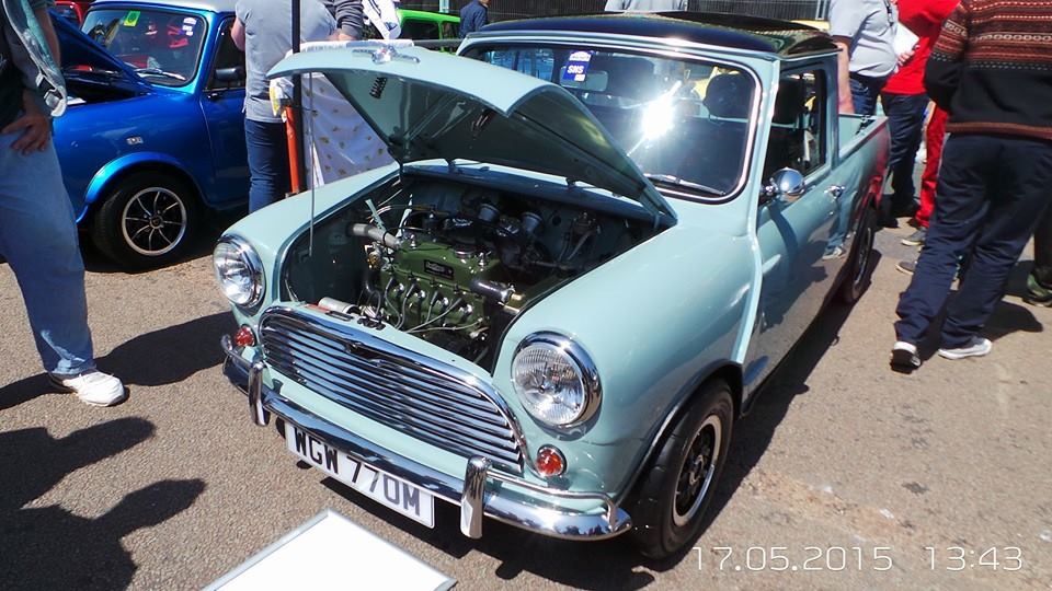

so the mini world action day !!!
what a drama that was, for me to get there was quite a story and a lot of effort.
firstly 2 weeks ago I  put 2 new tyres on my daily Clio 197, 2 continental sport contact 5's, after a stock take at work at around 11pm, I came out to a flat tyre that couldn't be repaired so had to abandon my Clio at work would you believe it I didn't have a tyre in stock to put on my own car.
so I got home and drove the mini to work, went out for my birthday for a really nice meal, and on the way back home, penny decided to spit fuel all over a fed hot manifold !!
I got recovered home the night before the show, I eventually arrived home at 11.30 and started to crack on with fixing the fuelling issue, I eventually, got the carbs sorted so they stopped sticking, now when I had my rolling road one of the float jets was replaced by a metal one and the other was the plastic type. but before I went to bed ready for the 6.30 so checked the wheel bearings and 3 had play, and I mean really quite a lot, so I ended up stripping it down until 3.30 am, I eventually got to bed at 4.30 and up for 6.30,
I arrived at the esso and met Ben in his 1380 beast ! now we set off HOWEVER penny decided to leak fuel again ! managed to fix it and get moving again within 20 mins, and got about 1.5 miles away from the petrol station, and yet again same problem, by this point I had 2 hours sleep and was getting very annoyed to think about driving the 130 miles to castle combe, let alone driving the 3 miles home I nearly gave up however my wing man kept me going, so we asked a lorry driver for a knife at 7.30, he looked very puzzled and explained what needed to be done, I had to shave down the plastic float jet. as 2 of the runners were not level.
now we managed to get to combe, only 3 hours late, and finally arrived at 11am, straight away me and ben got to the Miniworld stand and got straight into the drivers briefing,
gave the mini a quick clean, and set about getting into the pits ready to go on track, just as the session is about to go out, guess what mine started leaking fuel AGAIN !!!
by this point I saw red mist! I got the car back into the pits, and slammed the door shut got my wallet and went to find a trade stand, after buying a rebuild kit for the carb, I managed to find the problem the float needle had a hairline fracture down the length of it which caused it to stay open hense the reason why it was overflowing, after a 30 min swearing fit at the car and fixing the carbs,
once I managed to get this sorted, I went out on the track, firstly on the parade lap, then I went out on a paced session and then out for 3 fast sessions !!! really enjoyed it, however I may have got a bit carried away chasing r53 coopers and bens 1380, however after seeing the water temp getting to 120 degrees I did a cool down lap and went into the pits and hoped I didn't do any damage, whilse I was out panicing about the engine, however this was just the start of the problems, ben came into the pits and looked very worried,  after getting in ben had an oil pressure of 10psi and didn't get higher with revs oil temp was 110,
now bens car has never had a problem with oil getting hot, if anything I would say its the opposite, it struggles to get warm normally and would normally sit around the 50-60 oil temp now we let the car cool down until the temp was nearer 70 degrees and the oil pressure was still really low, so we thought of the oil pressure relief valve, and tried to space it up to increase the pressure, this didn't work, however when we brought the cap off there was a lot of  metal swarf in the cap,
so instant thought was main bearings.......
gutted this killed both mine and bens mood,  rather than ben just driving it home I went over and seeked the assistance of Bill Richards, and he helped up lots, he recommeneded doing an oil change and seeing what was in the oil filter, so we did this exactly and I would also like to thanks Max at mintro aka busamini
unfortuanly after we had done the oil change, we came to the oil filter and luckly had a funnel with a sieve in it, and there was a brassy, coppery looking metal, so either it could have been main bearings, or thrust washers, as when the clutch is dipped his car normally wants to stall, so little bit confusing, I will be investigating this over the winter, as our show season has come to an end, I will upload a video of the track before the battery died, and if you have any photos of the pickup during the day please post as I would love to see them, because I was so pissed off with the car as didn't really get a chance to take any photos
sorry for the long winded update, but **** happens
Robbie

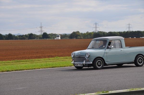

Posted 04 October 2014 - 07:36 PM
Good to see it in the flesh, looked great
#381 crazirob
crazirob
  • 650 posts
Posted 05 October 2014 - 12:43 PM
thanks alex great picture !!!!

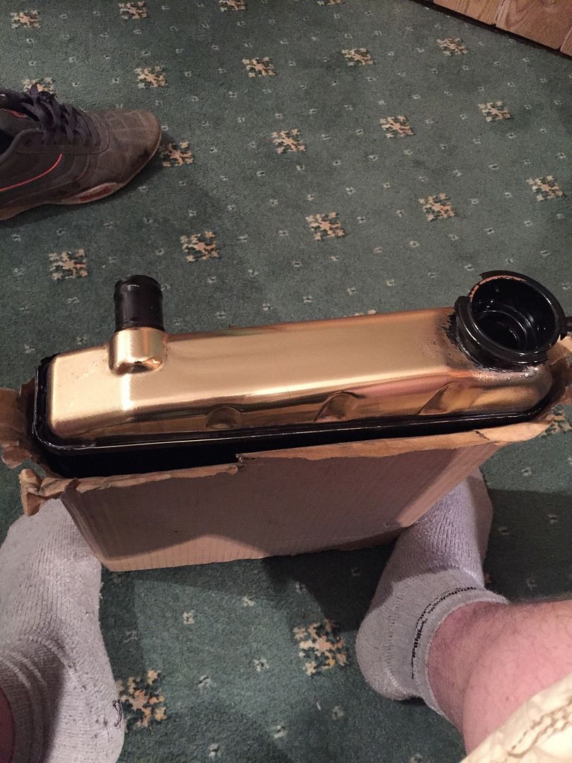

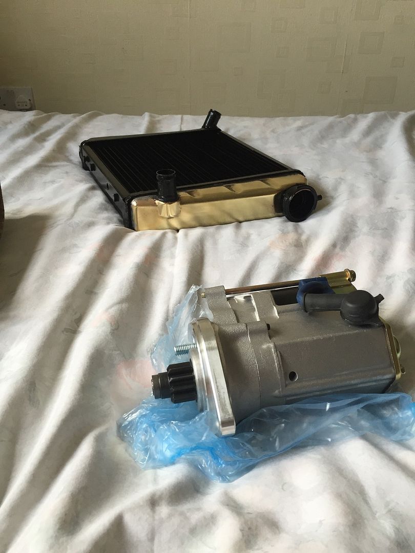

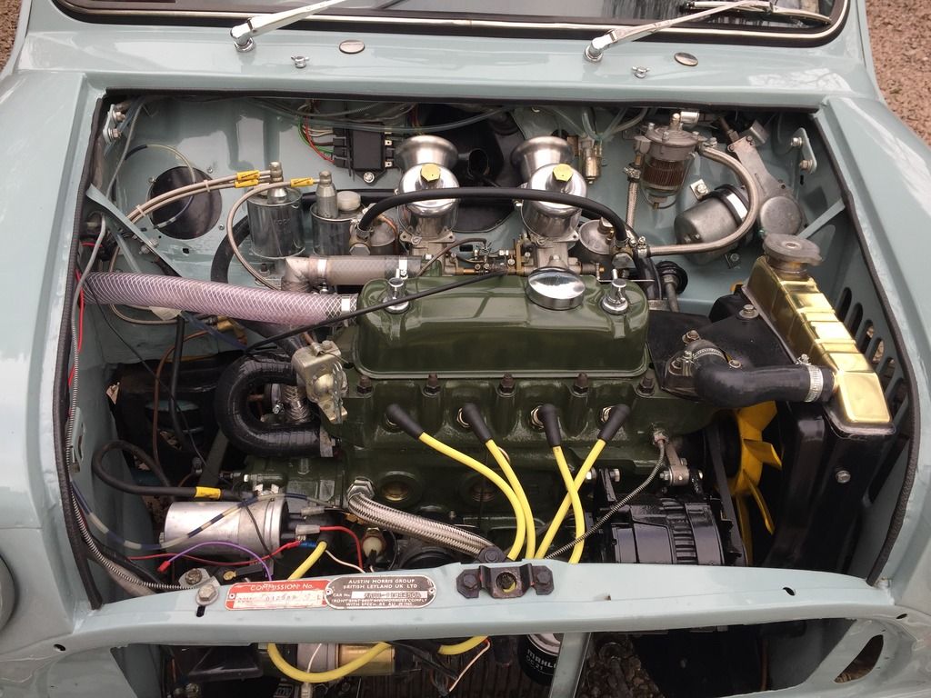

firstly I have had to change the started motor which was on my previous jobs list as I was sick of tired of going to start the car and it going tick....... tick..... tick......

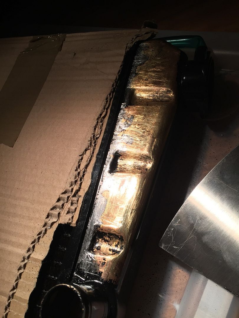

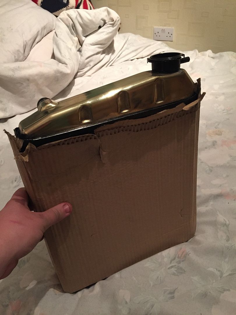

so a MED lightweight alternator was ordered and fitted, I also had a cooling problem, where when driving the car in normal conditions it would conterminously sit about the 105 degree mark which I needed to rectify with the started, at the time of ordering the starter I also ordered, a performance 2 core rad.
now this did not go with out problems, firstly I ordered and got all excited and spent 2 hours carefully removing all the paint, polishing up the top of the rad so I had a shiny brass finish similar to the previous rad, however upon installation, on of the riv-nuts, that is built into the casing, came free and was just spinning, needless to say I was annoyed, however because I had scrapped off the paint I had invalidated any type of warranty, so I was fuming, however after sourcing a riv-nut kit I fixed it and installed all correct, and now it doesn't really creep above 80 degrees which is pukka ! only when we going to London to Brighton I had to turn it off and we hit allot of traffic for about 20-30 mins on the A22 by Crawley so i purchased a kenlow fan, which will be fitted on my arrival back in the uk
scraping off the paint
brillo wire brush (coarse to get all the stubbon paint off)
nearly there
finished!!!! at last !!

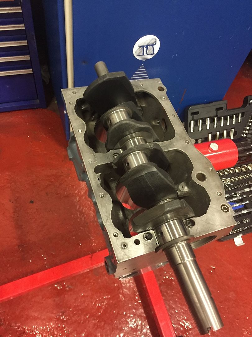

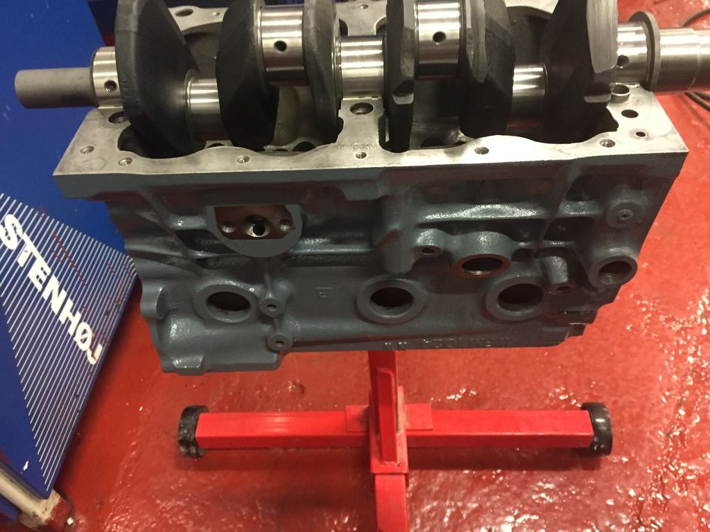

over the winter months, we stripped down and rebuilt Bens engine, if you don't follow him on instagram its jordben however some of the regular show goers will agree that it is a stunner ! metro blue with a 1380 and he reall looks after his car,
73580E5A-3587-42C1-B1D1-C7C1E7ED9901_zps
here it is at stanford hall last year
upon stipping down, we found the cause, it was one of the centre thrust washers, had munched into the crank, removing most of the metal untill the washer as about 1.5 mm thick, obviously this wrote off the crank, the block and pisons were all shagged too so we sourced a new engine, and started the bigger and better rebuild, now previously his engine the pistons sat about 1.5-2mm down the bore, lowering the compression ration to about 8/8.5:1 and it still produced 98bhp and torque firges to match on an ac dodd cam RS+, needless to say we have rebuilt, you would have seen it we now have made it with a compression ration of 10.5:1 and we are hoping to see an increase in power and also in torque, our aim is 110 bhp however it is running in and i wil update you in due course once it is fully rung in and dyno'd, again another exciting situation.

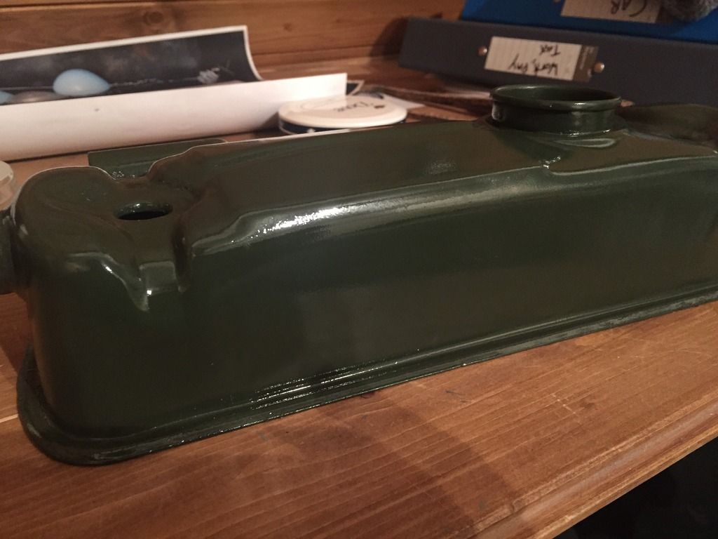

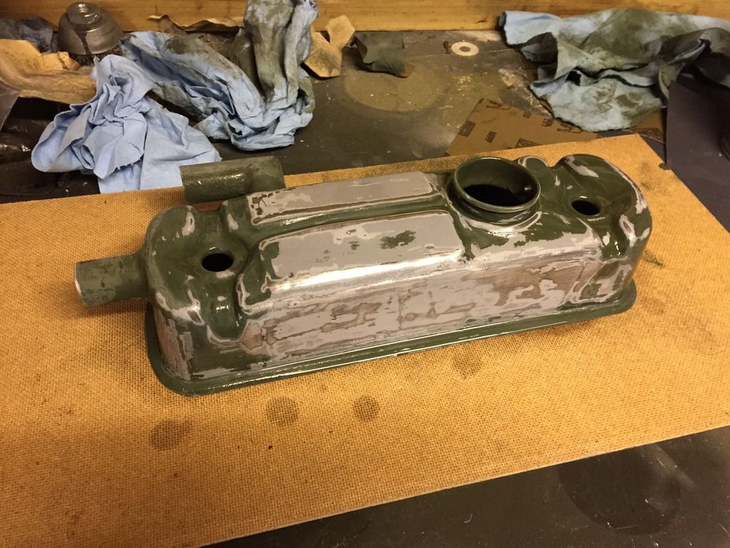

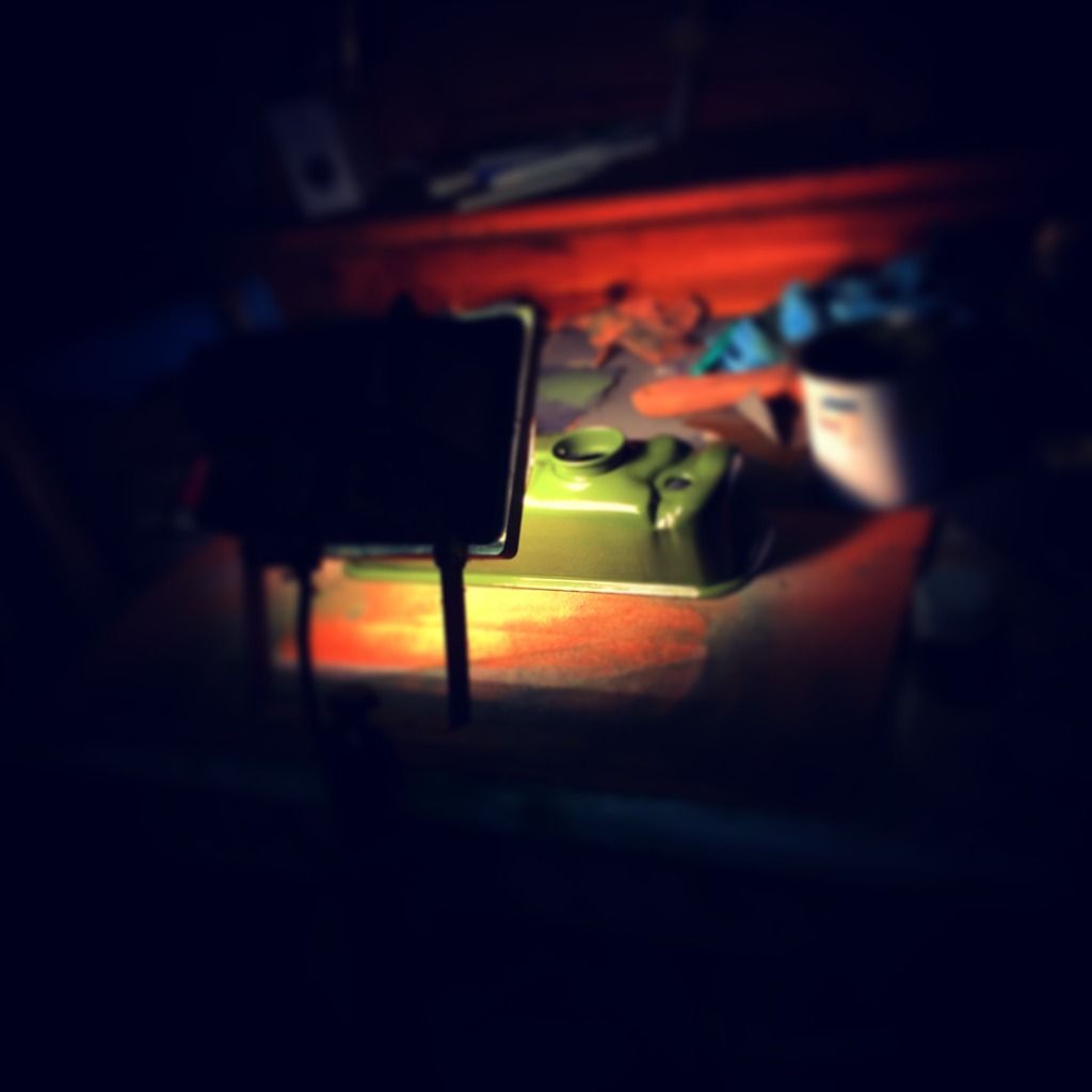

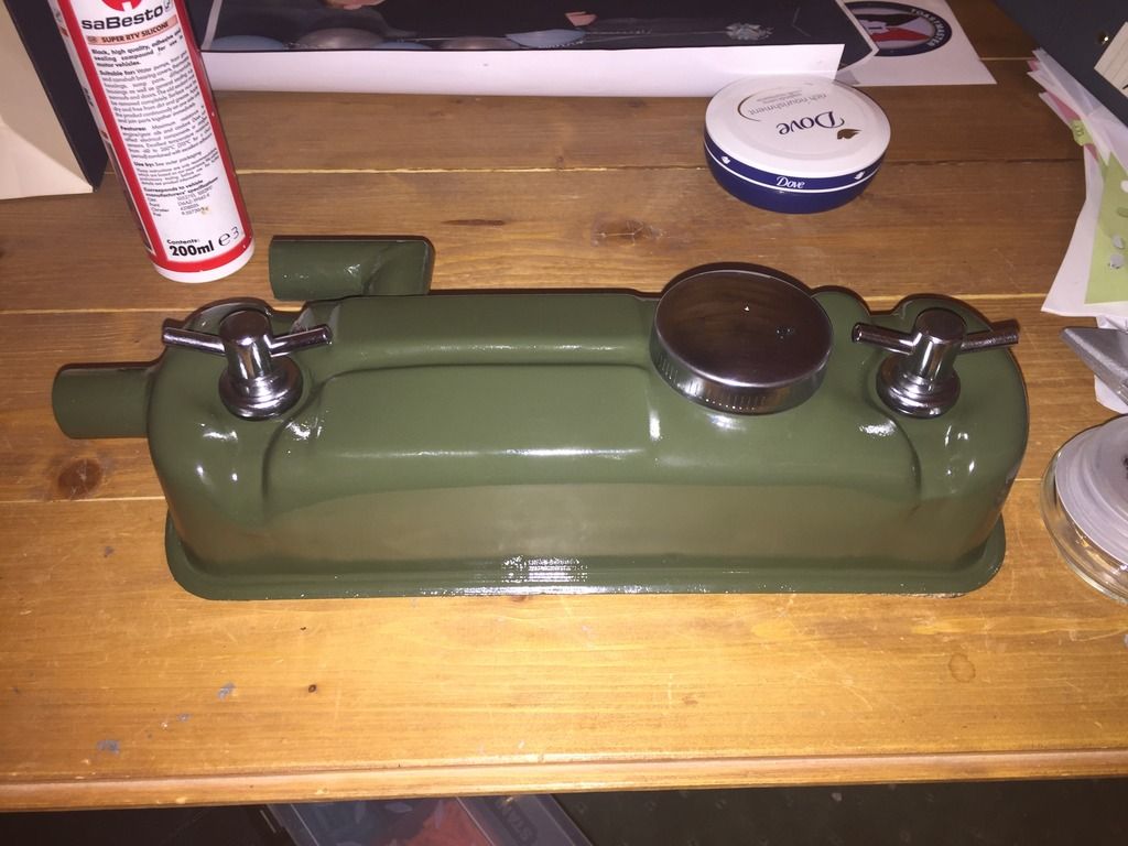

so like i said i have fitted and installed the starter and the rad, however one of my bug bears with my car was the engine bay, always looking messy and untidy, now one of the first things for me was the rocker cover, starting to look a little old, and was not fully functional it needed to have the outlets changed into new positions, as the old ones looked messy and also i wanted to be able to access the carbs fully without the pie catching on the heat sheild. now you would think when you go to buy BMC green paint that it has a tolerance of tone, now i purchased a tin from SC parts, to say i was disgusted with there customer services was an understatement, you will see why in a second.
 so be the build was on. and the mkII rocker cover was born
now i brought the paint thinking it would be same, however i got a completely different colour, now i understand shade matching and batch number sthere can be small differences this took the mick !!!

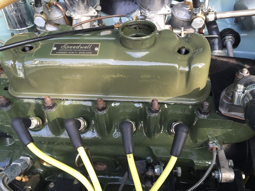

after buying an engine enamel i had to thin it down using some poly thinners and paint the rocker however the first one reacted and i only have photos from the second coat and attempt to spray
Cooking in progress
installed on the engine however missing a plaque

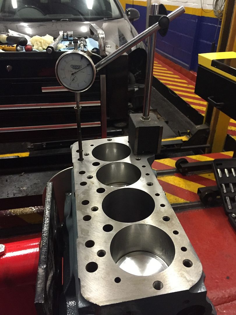

now in a previous post i said i would be making an Appendix K Spec Cooper engine, after much hunting i have started to collect parts ready for the build, now again simialr to the 1014cc engine that currently beats in the little bugger, it will be a little different from Appendix K with regards to using a steel crank on a standard stroke to cope with the rev's but to also give a better harmonic balance throughout the engine, the other difference will be the block and gearbox casing, i want to have the strength of an A+  and also a remote gearbox as i am in the process of purchasing a dog engagement Gear set,
but again similar to post above
new installed Swiftune cylinder head         --------Got - little more developed than the FIA regs
sw23w camshaft Swiftune followers          --------Got
A+1293 bore using Omega pistons
steel crank Swiftune/med
steel rods Swiftune/med/specialist Components

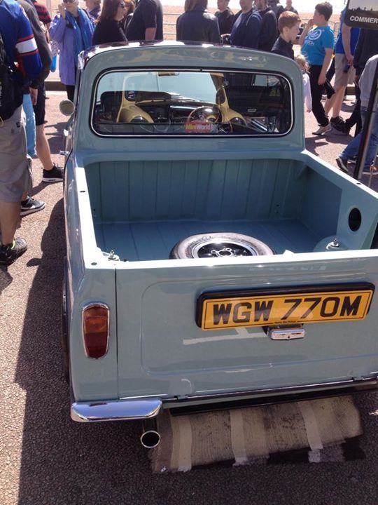

SOME PHOTOS FROM L2B

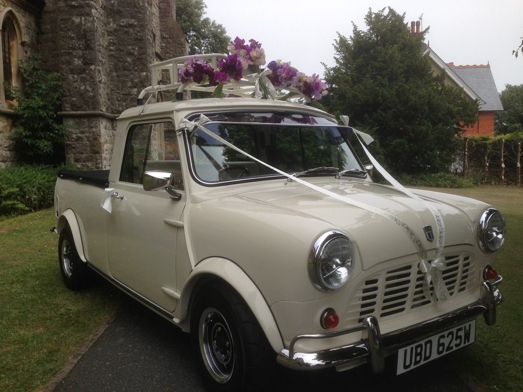

now the final part to my update, my car did me very proud last weekend, in the biggest show in my eyes of them all, my little pickup was my wedding car, myself and my new wife had some photos taken with it and lets say the future is bright and we cannot wait to do more shows as she now has a reason to come, I brought her a few wedding presents however I did manage a funny which was a rose petal to match the rest of the car which a tyre, now this is hers to keep and show at the show and shine competitions lol
who said that Pickups cant be usefull podium for throwing bouquet Check  ! although i did have to put a towel under here so she didnt damage the Load deck lol

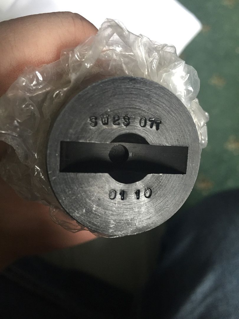

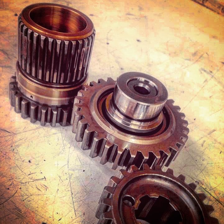

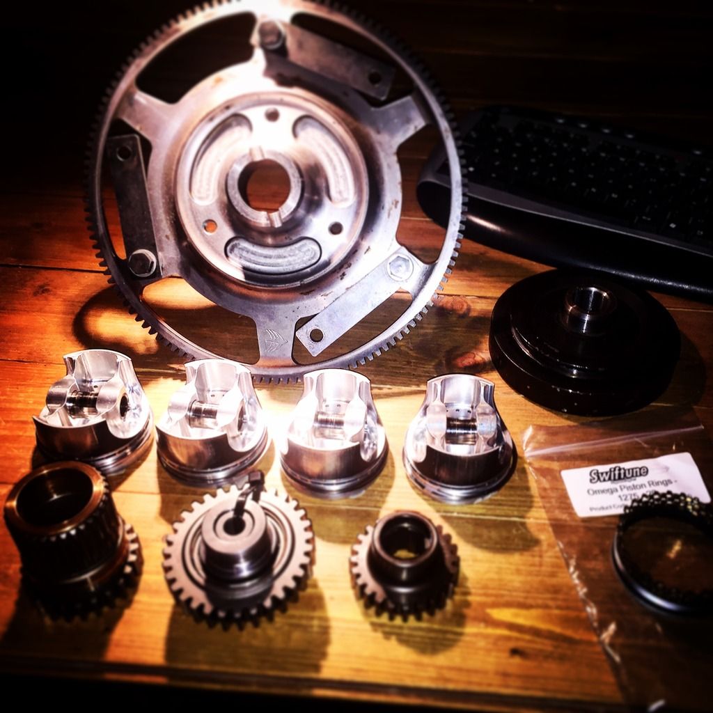

A few updates for the 1293 historic spec engine
The items below I have purchased and are ready to go
Swiftune Sw23 and Swiftune cam followers
Swiftune forged omega 5.8cc Pistons
Swiftune featherweight flywheel
KAD harmonic viscious dampner
Swiftune straight cut deop gears
Starting my little collection of parts! Can't wait to get some more power now :-), or do I change the cam and flywheel and go turbo ? 😕
