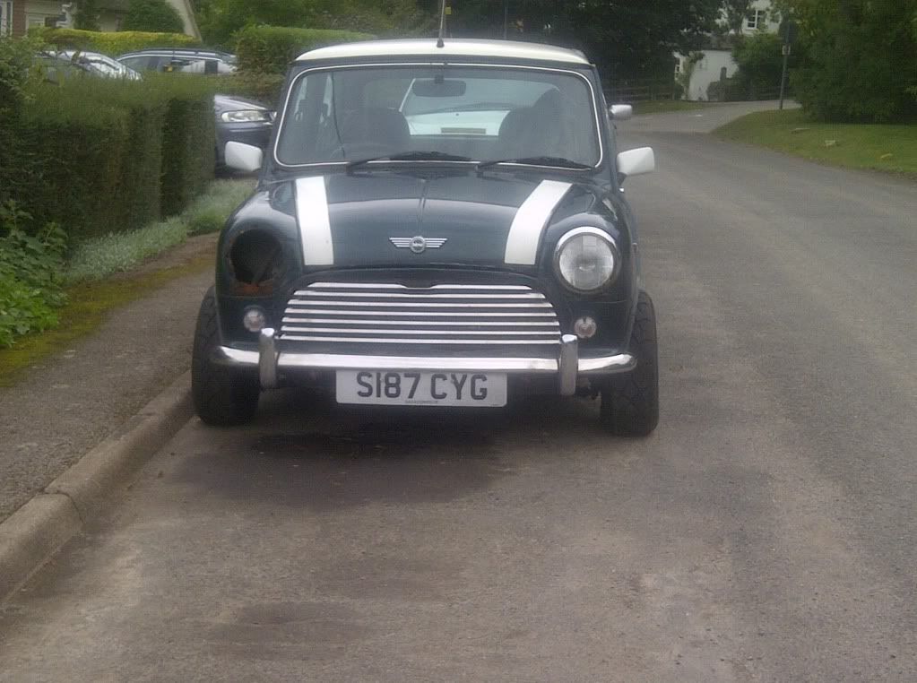

Also, I have a wonky headlight. The only thing I can see that will sort that is to drill out the rivets securing the bowl to the wing, drill new holes, and re-rivet it in the correct position. Am I right in thinking the headlamp can't be moved in the bowl, and that I do need to move the bowl itself? It was highlighted on last years MOT as it kicks the beam up the wrong way, so I'm sorting it at last!

It's strange for the headlight to be wonky as there is a cut out at the bottom of the headlamp hole to allow for the headlight adjustment motor to sit. I cant see the headlight bowl fitting in any other way.

Very good point Liam! I'll pop the wheel off later and see what it looks like from the inside. Perhaps the simple job isn't so simple! The motor has stopped working on that side so that's another job to do while I'm there.
