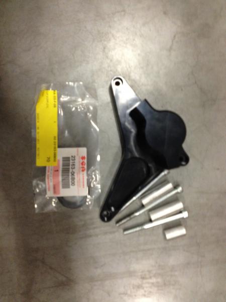

nice project, seems like lots of fun for you guys! Wish I could of done this stuff in my school time...maybe you should use a thicker chain, this one seems pretty small and if it brakes it will hit the clutch slave, this will break and there will be a gasket leak, which you can only replace by pulling the engine and split the cases...I know, I've been there and it's not pretty.

That is a very good point and one of our concerns. We are using the std. 530 chain and would really like to upgrade this. What chain would you recommend on a tight budget? We had a chain guard for our safety in order to avoid a broken chain flying around the cockpit but didn´t thought about the clutch slave. IS there any way to protect it aswell?

This type of clutch slave is lots stronger, but will also damage from a broken chain. I don't think there is a proper way to keep the slave in one piece when the chain breaks, so just replace it and keep it greasy.
http://www.theminifo..._1#entry2317223
This guy is using a 630, I have to go and check at home, not sure what i'm running, I ordered it at a local bike shop and it was the strongest possible according to this shop. i'm sure if Monte is running a 630 that's more than suitable for a standard B-king as well!!
I'm pretty sure if you push your car a little on accaleration, it will break in no time!

630 should fit I think, I don't use the original mounting bracket for the slave, but I guess you don't either, on the other hand, my pushrod is original so the distance is exactly the same as stock, and it doesn't interfere.
nice to see how you guys do stuff on a tight budget, it's always weighing what to do, you could try and run the 530 chain, as long as it stays in one part, that's the cheapest way, but if it breaks, you need a new chain, slave+pushrod and if you're unlucky like the former owner of my car, you'll need all the gaskets to crack the block open and close it once again in order to change the pushrod seal.
Or you fix it the budget way, which is glueing another seal against the block from the outside, but even than you'll need more parts as changing the chain as a precaution.
