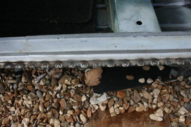

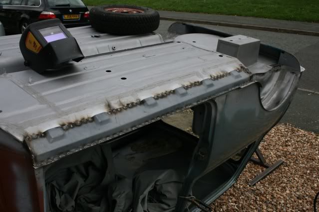

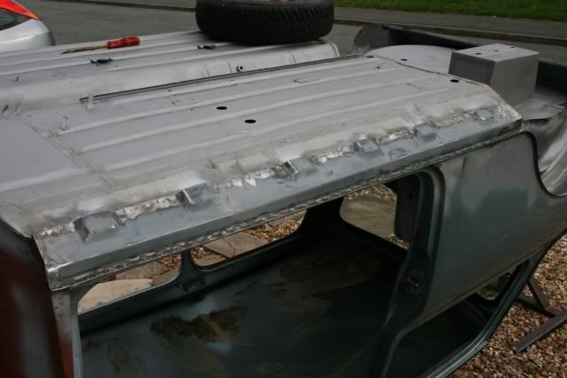

The rain did not stay mainly on the cheshire plain today and I got what I wanted done to the back end .

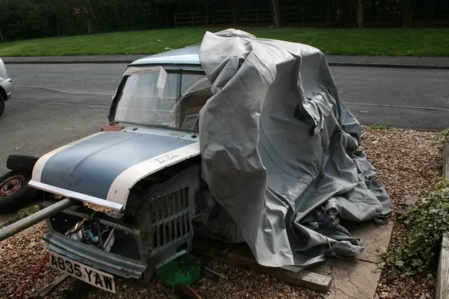

However it was windy again, so rigged up the welding tent but this time without Jan holding it up !!

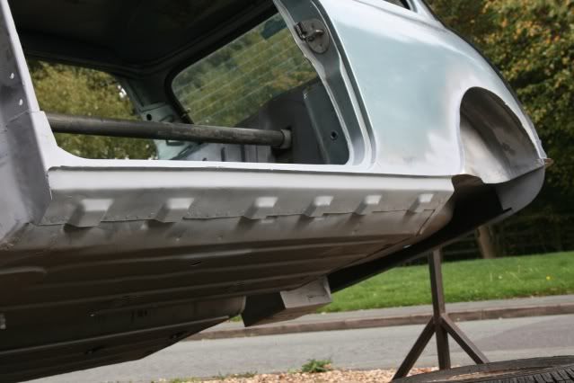

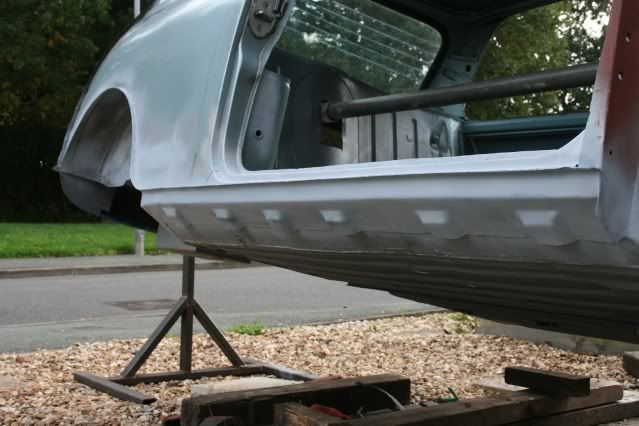

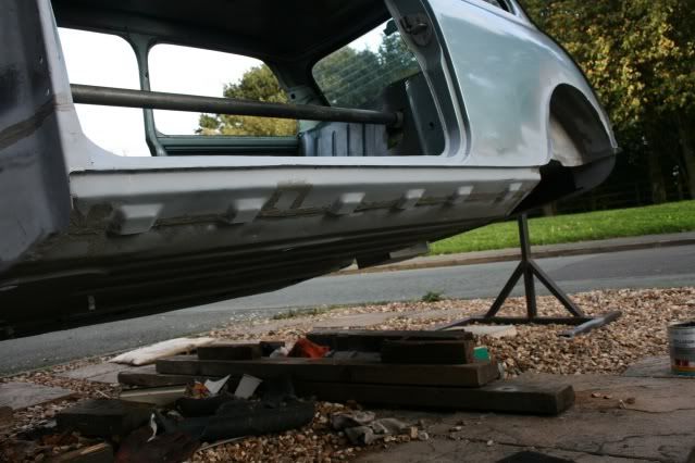

This led to welds like this today, much happier with the result and I ground down the crappy 'no gas' ones and re did them.
So the plugs went in fine and I ground them so the sill will take the cover strip, hopefully without snagging on earlier, les proficient welding, other side the same !

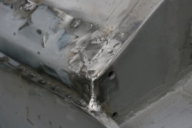

Also went from
to
Lots of welding and grinding back to take up the gaps I had been left with from earlier, very pleased with the result to be honest, the out and in ends of the two sills came out fine too.

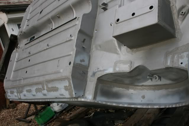

Voila !
Got some primer on and I am feeling very pleased with myself with progress this last week, so if there are any mistakes please PM me next week !!
On to some seam sealing, last week I did the underside but felt it a little thin, so as it will be covered up with stonechip or similar and underseal stuff, I lathered it on !! Neat it isnt but I'm too happy to care !!

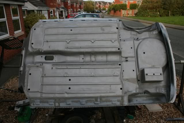

Minimuk, wax oiling imminent, got the spray bottle just need to get the waxoil. However constant surface rusting made me do some priming. But first took the block out for a look.
Piston bores no rust, glad I oiled them up. Knew the water ways were full of rust though so put them in an electric bath to loosen it up.
Washing soda, water, (1 tbs per gallon), and gas mark battery charger, two minutes saw the crap comming off !

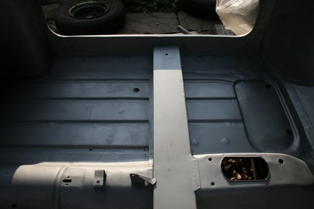

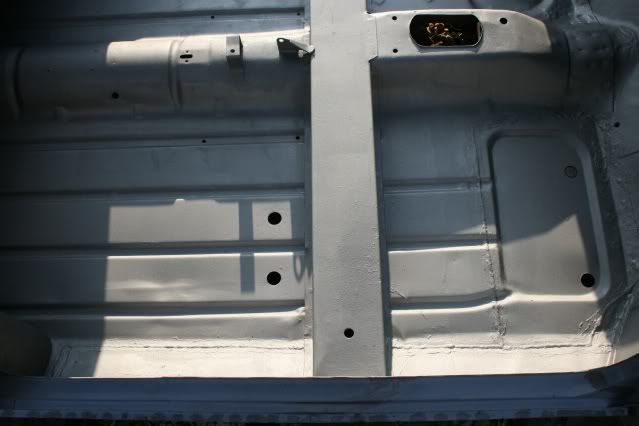

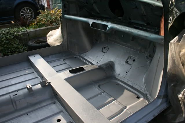

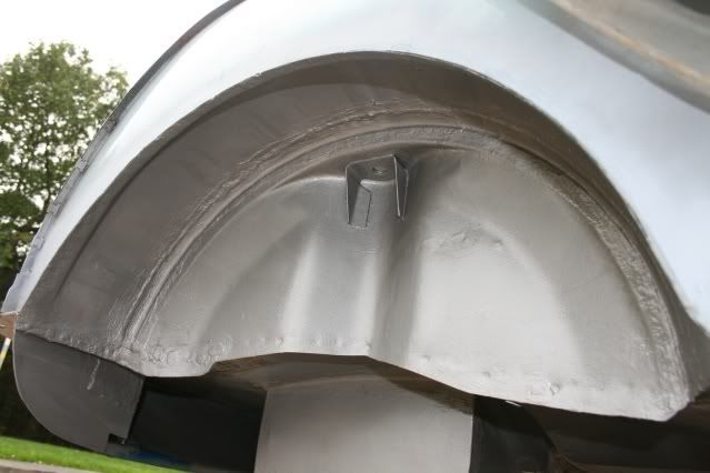

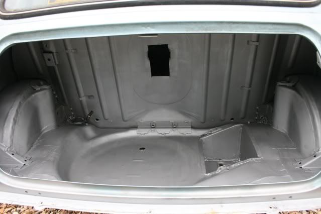

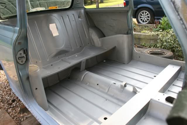

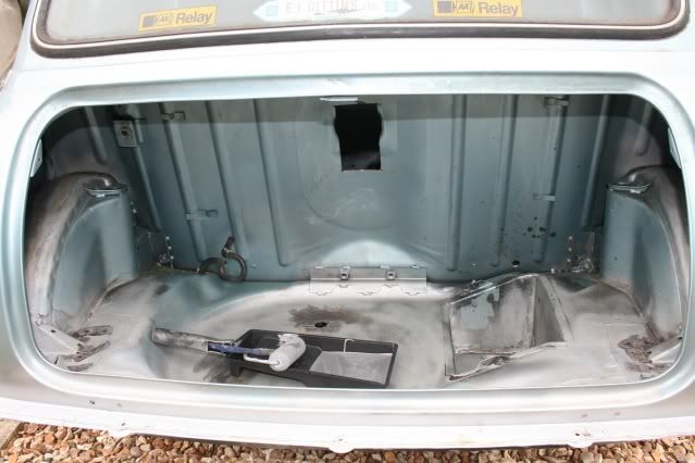

Boot before a prime and after, not too shabby I think, and the arches came up nicely too. Arches have been seam sealed so just another coat but the boot needs sealing tomorrow then another coat.
Inside I primed most of it but it also needs a sealing session. the upper part of the bulkhead I forgot when I was wire brushing and cleaning down so Will do this tommorow too.
Not sure if I will do the roof as it will be hidden and will be putting more deadening up there anyway but may just do it for completeness though !! Few bits of rust to sort round the windows but getting there back end.
The surface of the primer is a little textured but I rubbed down a little underneath and it was fine so will probably use it all over, just more rubbing down :ohno:
