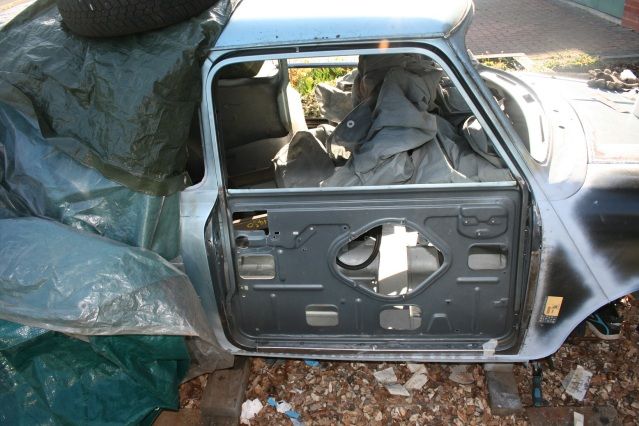

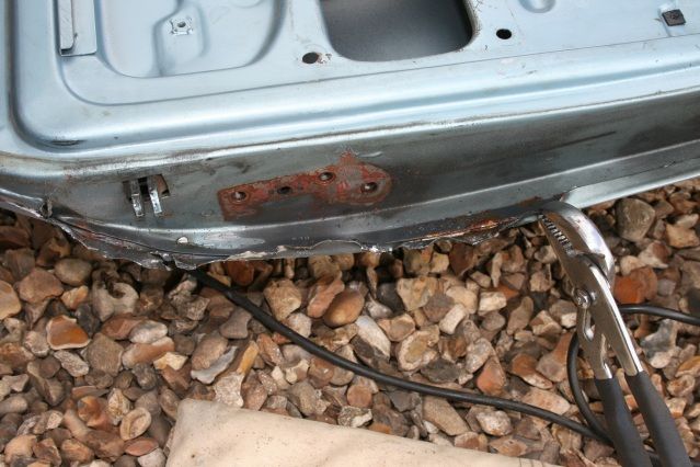

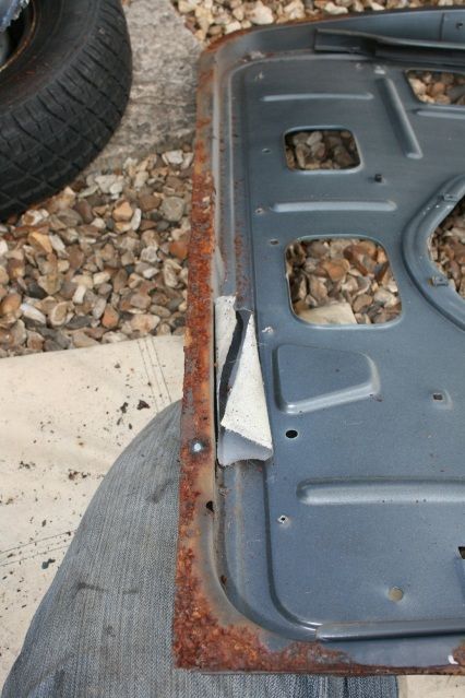

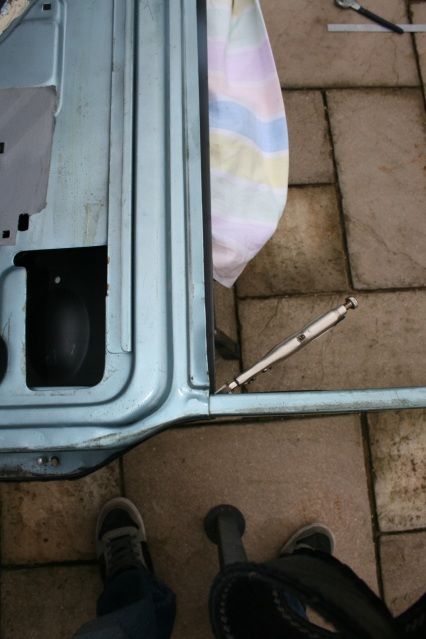

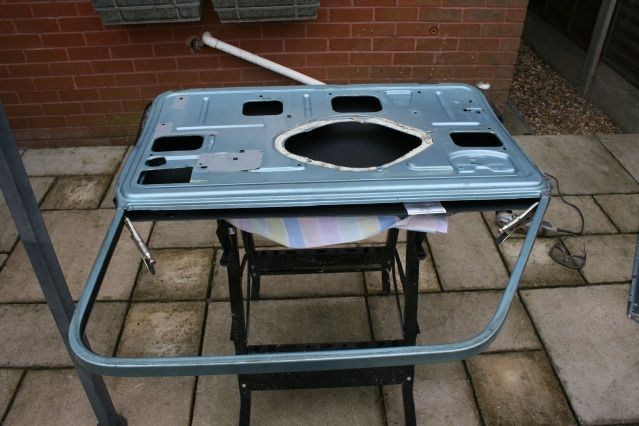

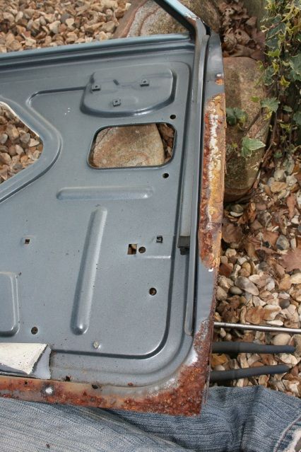

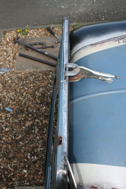

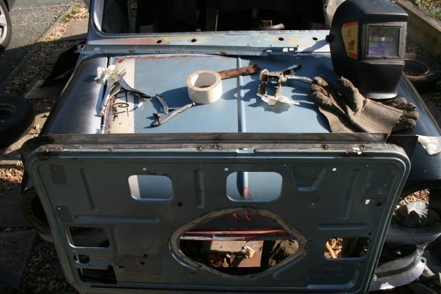

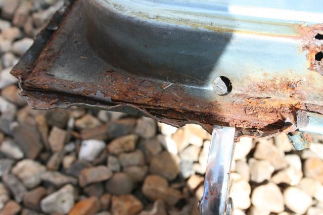

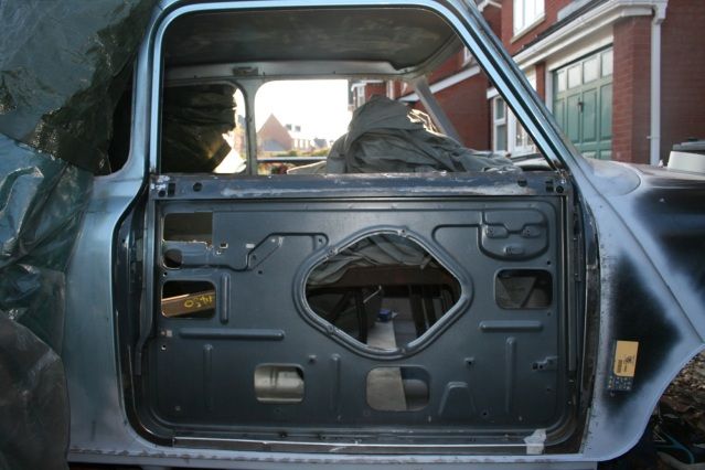

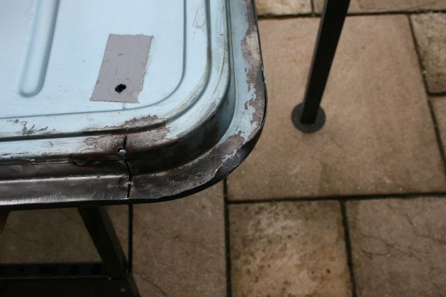

yes a crappy day in mini corner !! All about door fit and how to go from pretty good to bl**&y s*&t !! As I mentioned the other day the doors require a reskin as the drv has quite a bit of rust along the bottom and the pass is, after investigating, fillered to death !! So started the deskinning of the drv door to see how bad things were.

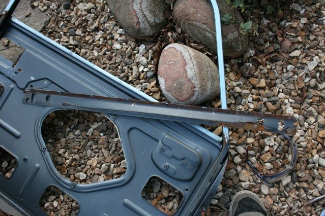

Glad I decided to do this job too as 6 months down the line I will not want to be redoing bits and the rusty crud along the bottom needed sorting. Off fairly easily but ground off the strengthener inside the door without knowing.
I used the old skin to reposition but still not sure it is in the right position but time will tell and not too bad a job to move. Then the fun / frustration started.

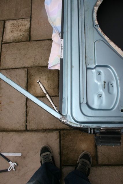

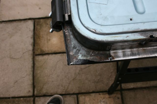

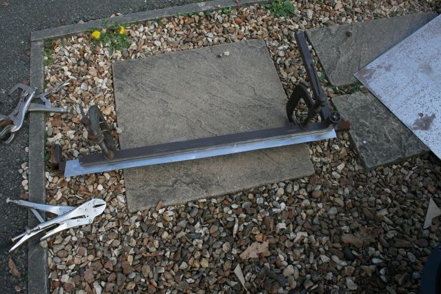

I used my diy metal bender to fols a strip of steel for a patch along the bottom of the door frame. Just the table legs again, some clamps and a large impact tool !!
I offered it up and due to the bulge outwards in the door orriginally I moved the patch in at the mid point to 'pull' in the door at the bottom. (hope that makes sense ! )
A couple of tacks and all was going well, crud out, patch in, looking good, NOT !!

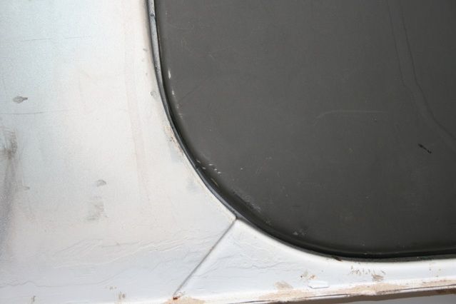

I slathered on the seam sealant behind the drv A panel lip and bent it over before fitting the door for positioning and trimming of the bottom edge.

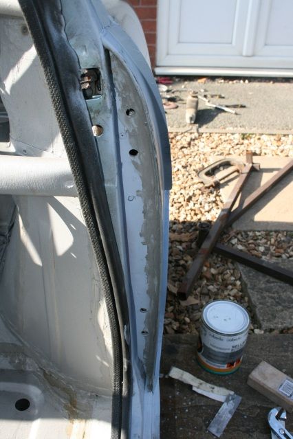

It now fits like a bag of sh*^e at the back as you can see. I tried shims, tightening the hinge bolts, twisting the door, nothing worked, the door has dropped back and down. Hopefully it is just a loss of rigidity on the part of the door but I am very concearned. Can't believe it has gone soo far out on the fit just by taling the skin off.
and before
What to do, I am for a change at a loss and quite down beat, I thought this would be an easy task, but it has set me back loads. I also noticed the hinges moving too. Wehn I reconditioned them, I filed a small amount off the mating faces of the two halves and there is now some movement in the hinge itself. Don't know how critical this is, may be new hinge time too ??

but to let you know, if you buy a genuin door skin it comes with the strengthener with it. so no need to worry about that one.

Now you've got the skin off the door it would be a good time to weld in your own side impact bar like in the later mpi's. I'll be doing this when time comes around to reskinning my doors.

I have no idea how to do that effectively, what steel to use or where it should go. I think I will leave that one as done incorrectly it is probably not going to work, but opinions welcome.

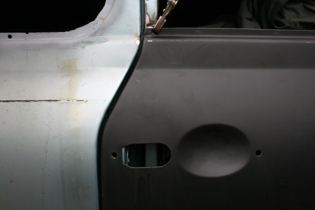

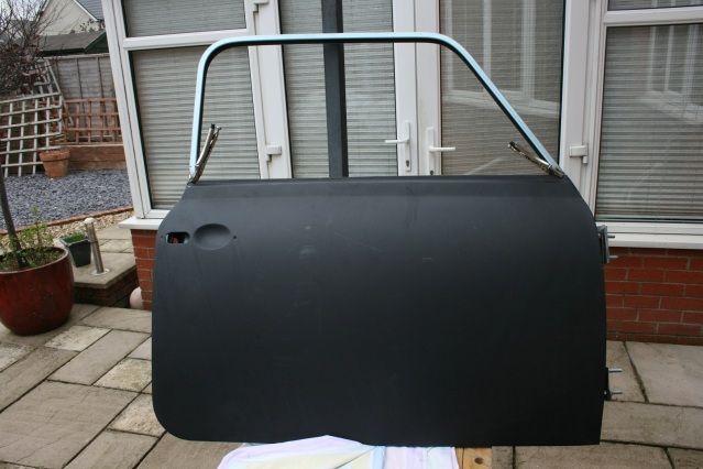

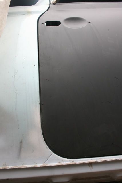

a brighter day today, not the weather, just on the door front. I went to a panel supplier near me and got a good old Magnum door skin. This is going to hurt I thought, but a surprisingly good fit. The door handle hole lined up and it was fine round the edges. So this is how it went
I clamped the top of the skin into position, according to the handle screw hole and the surround and turned a couple of corners over so it held in place for a trial fit into the door apperture. I turned the metal flanges over and clamped tight so I could see how the door flexed with a skin on.
Result was not too bad at all. The skin does indeed add tons of rigidity to the door and it didn't sag as per yesterday's efforts. I also made some hinge backplates to strengthen the rear of the flitch.
The door didn't flex at all really, but the hinges did wobble still so that maybe where my problems lay. Quite pleased with the gaps around the door, the bottom has a 1/8th gap along the bottom although it still sticks out. May have to adjust the frame further. The rear corner at the bottom is ok too and the panel lines all line up at the top. So, I will take apart, finish the welding and paint it inside before a final fix.
The only problem I can forsee is where the top of the skin finishes. One side is nearly level with the inside skin and the other is about 1cm higher, is this normal??
I could just grind down the top a touch but will wait till it's back on the car to look at it along the side front to back.
Feeling happier now,
Graham
Edited by grahama, 02 April 2012 - 05:33 PM.

sexy door fit that one, can you open thedoor easely, not scraping a-panel, with paint on it?

Muk, think I will be ok A panel side, I have a bit of slack in the skin to take in so the gap should be a nice 1/8 in.
