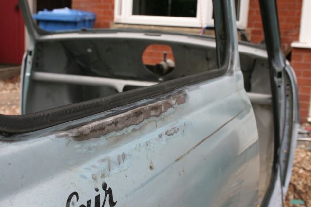

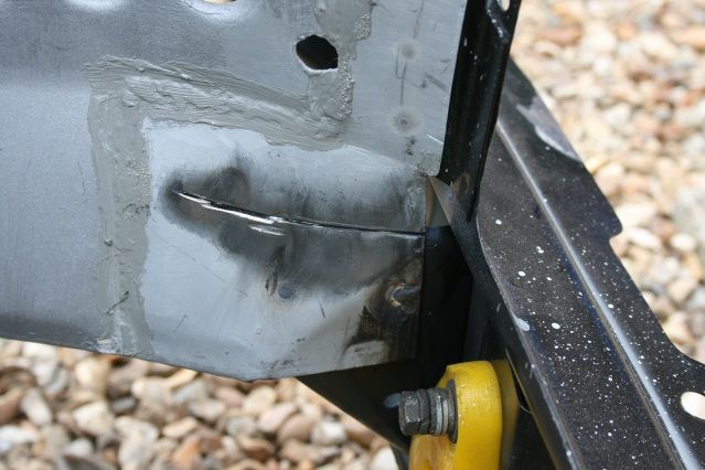

Getting to the end of the welding now thankfully, few frustrating bits to go, not done the underside bits yet as had a window problem. Anyhoo

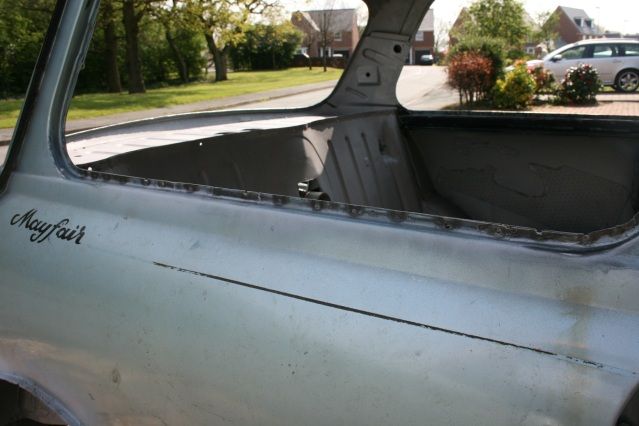

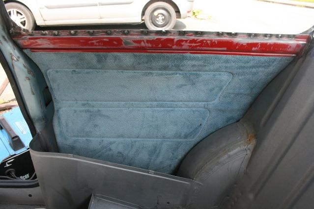

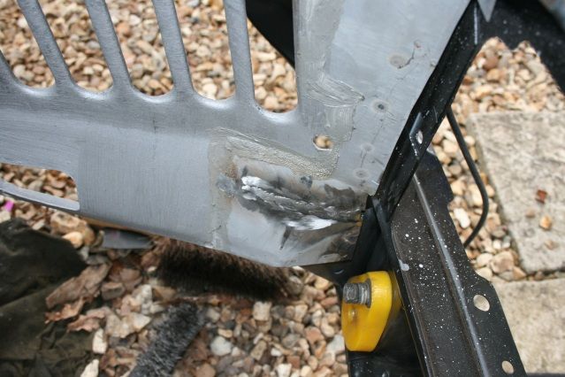

Rear strengthener panels got welded in and I tested the cards fo fit, same as they came out so pleased I haven't messed anything up. Got the cards out before Matt came home from work, he wouldn't be able to cope with things going into the mini after two years of thing coming out !!

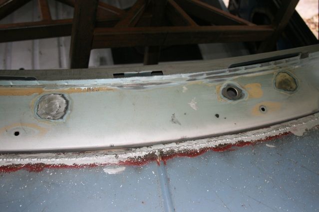

I put some slots in the inner wing repaire I did to get the fit to front panel right so I welded them up, another job done.

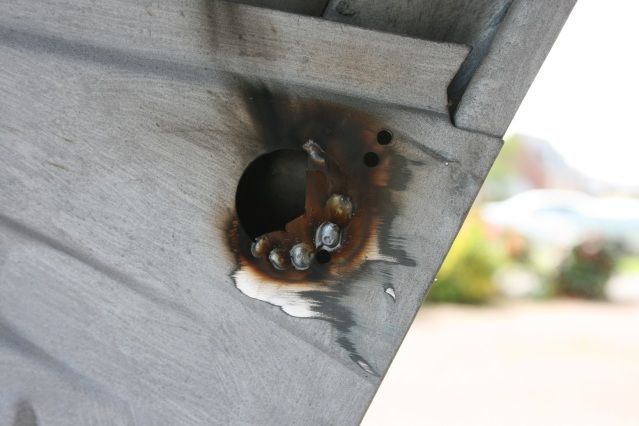

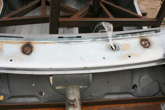

Same little job on the extra wiper holes
Had several looks at the original pics to make sure I filled in the right holes !!

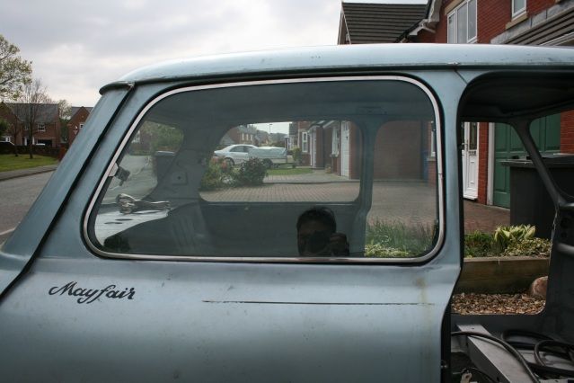

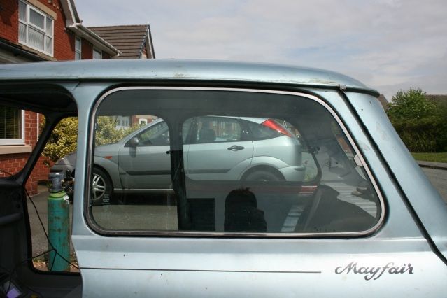

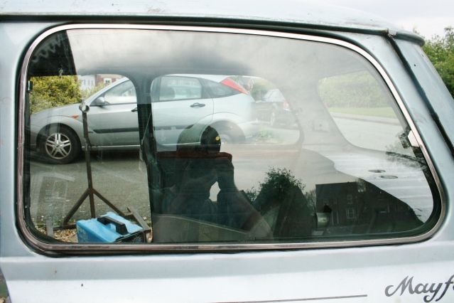

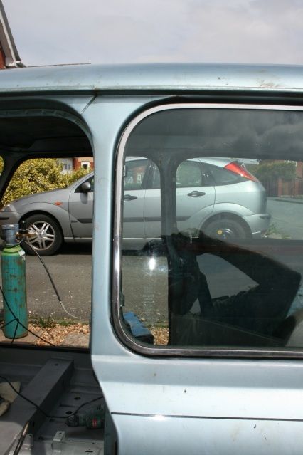

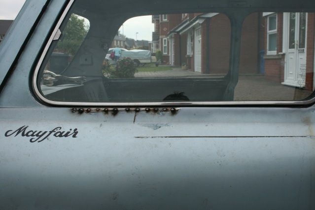

Then I thought I'd try the rear windows in place to see all still fitted after the frame repairs. They did but what a crap fit

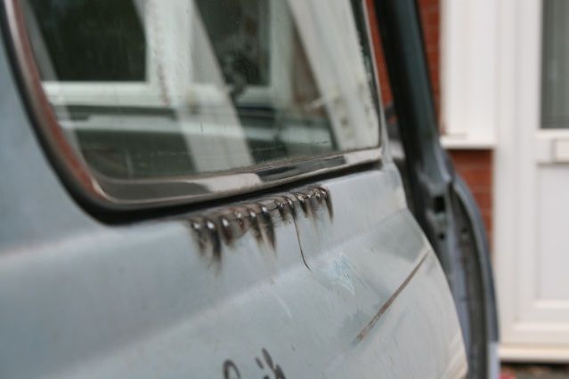

The window was all over the place as you can see, driver side similar but not as bad. A main problem was the frame binding on the top of the quarter panel when opening so I did different things each side.

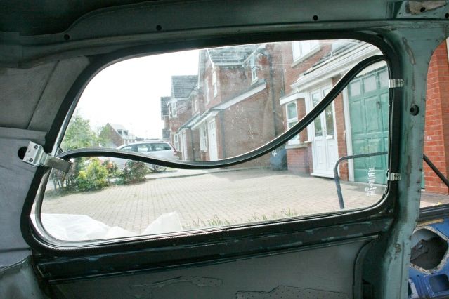

The passenger side I redrilled the B post to move the window down into the aperture.
Forgot to take pics of that but at the rear I had to weld a piece into a hole to allow a new hole to be drilled.
No catching on the frame on this side. Driver side needed a different approach. I drilled the B post as before and centralised the frame but it was still catching in the middle and couldn't sdjust with drilling anymore.

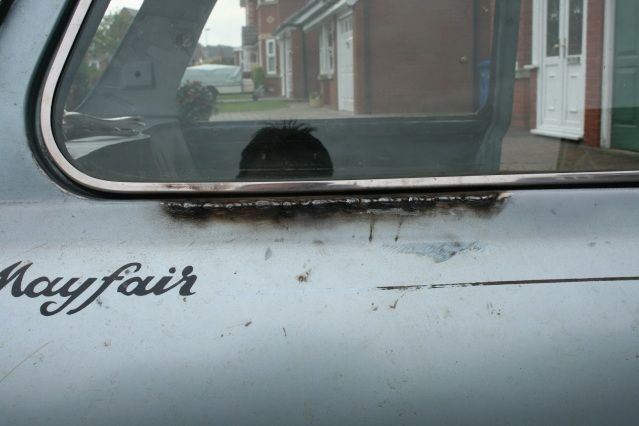

Slotting this side.
Gap round the frame now, all ground down and profile looking fine, to me anyway. I have however been thinking about the rear windows and not sure if I am going to keep the openers. May just swap for the closed type, so repairs may well be a waste of time. What do you think, openers or closed ??
Also realised after an hour battling with the rear window rubbers that they are not meant to come apart lol !! What a faff !
Nearly there, the tunnel light is very bright at the end of the welding tunnel, but many tunnels to get through yet :ohno:

Nice job on the repairs Graham, sorry to point something out but to me it looks like the trim around the window itself isn't straight especially in the 4th & 6th pic up from the bottom of your previous post. That may have meant the body was ok & the window trim was out? Ddi you check the straightness of the windows?
#473 grahama
grahama
  • 2,442 posts
  • Location: Warrington
Posted 04 May 2012 - 07:47 AM
Hi Brams,
well I have to say no I didn't, didn't occur to me that they would be wonky. Will check today but wont be unslotting the quarter lol !! I am seriously thinking of putting fixed windows in the rear, partly for leakage as mine are a bit slack and partly for added security.
Thanks for the keen eyes !

Brams, the frames are near as damn it straight, must have been the pic or my dodgy repairs !!

I like the idea of welding the wiper holes up, I bought silly shiny things to put in mine, but getting rid of them altogether will look far smoother

That's the problem Muk.
They are very tight front end, tight in the middle and nearly open at the back !! Can't adjust the frame anymore, but could move the front screw holes out to allow the rear of the frame to come in a touch. Off next week so will have a play !!
Carlos,
a ten minute job and as you say, once filled in they wont leak or rust around the plugs !!
Graham
