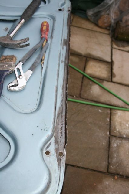

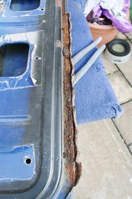

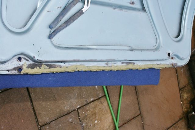

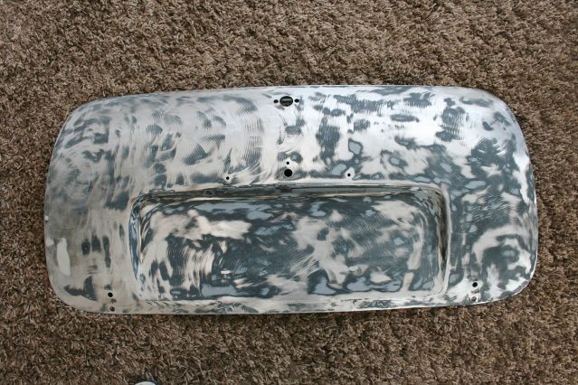

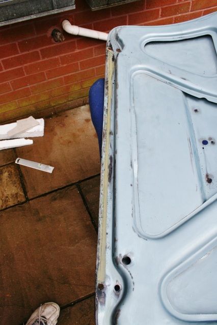

Had an inspection of the bottom lip of the boot door. It was looking a little pitted so I opened up the lip of the skin, cleaned, kurusted, seam sealed and re skinned it. The pitting was there, but sound so I am happy with the cleaning and sealing. I gave the boot lid to Matt to rub down and 3 hours later went to inspect progress. What a nightmare !! I think it has had a dodgy respray in the past as it had started to flake during rubbing down and it would have taken hours longer to get anywhere near good enough so out the grinder came.
10 mins later back to metal, just needs a quick block wet and drying before etch primer. Looks like I have the whole car to do now though as all the same !!

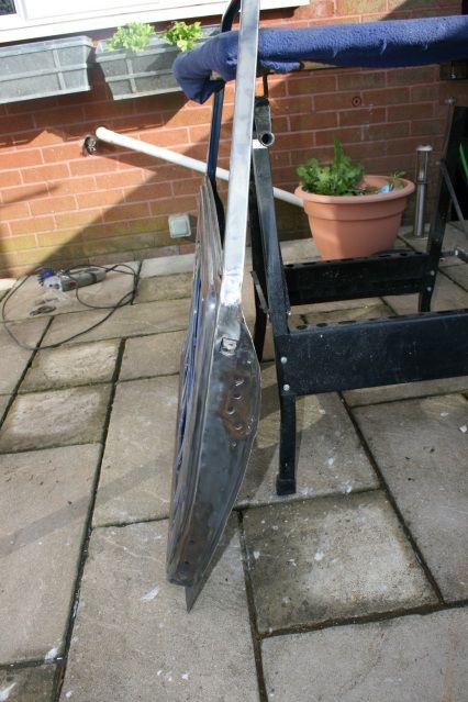

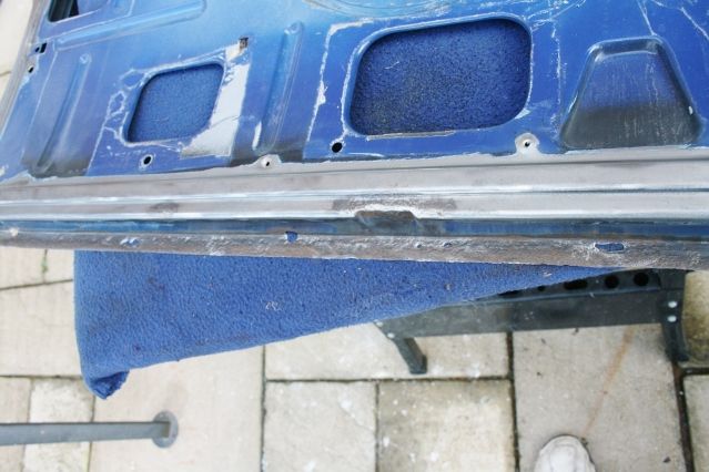

Also did the inside of the magnum skin, taking off the e coat till it was solid, again needs etch and prime before going on the frame which I took back to bare metal as it was easier. Didn't do where the card sits as I don't see it a needed.

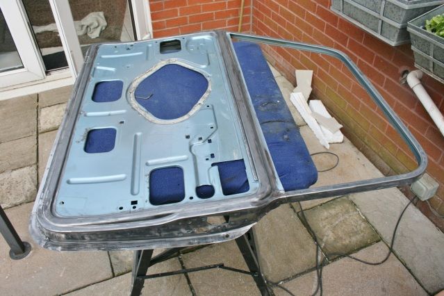

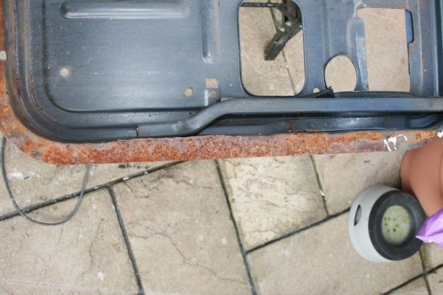

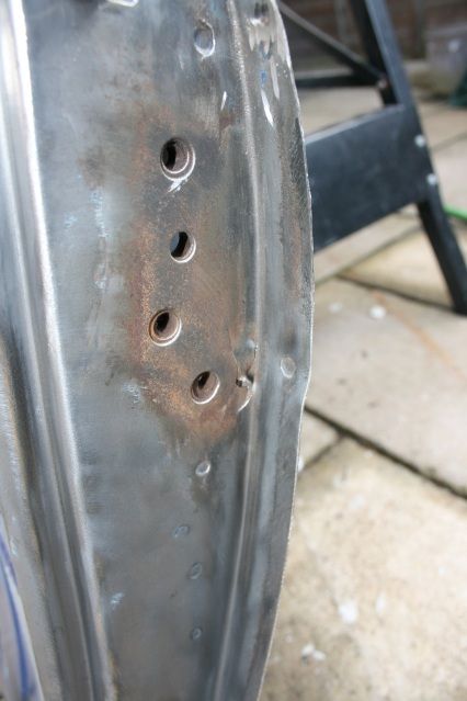

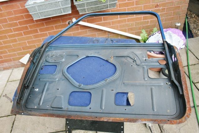

Then I deskinned and had a look at the passenger door I got off fleabay

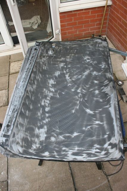

Looked a little crusty at first, but after a stripping and a good wire wheeling on the grinder it was better than the driver door. I will haveto replace some of the bottom lip and a patch near the hinge mount but not too bad.
All stripped as with the driver door but not repaired yet.
