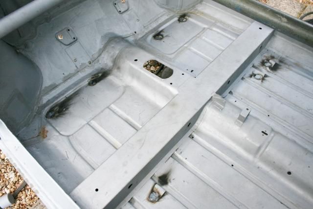

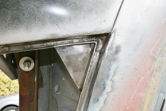

Started to paing the front subby, no pics as too mundane, but I want it done for when the underside is finished so it can go back on wheels asap. The bonnet drain channels are now finished and just need some sealing, they were a pig to do and really need a die grinder to get them looking nice !

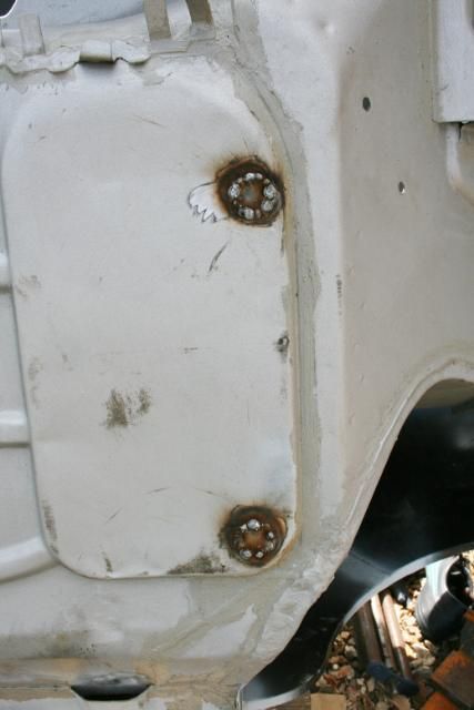

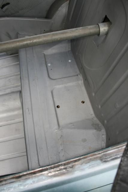

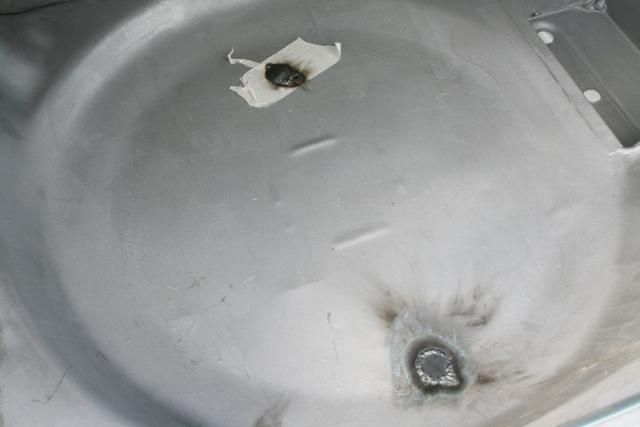

Otherwise I have been filling in the holes in the floor, the ones for the drain plugs. Some keep them but I want them gone as the new sound deadening will cover them up and if it does leak I can always drill holes lol. My way of thinking is if I fit new seals and get the doors fitting well then there shouldn't be any leaks. Famous last words.
The boot had a couple of them and one was surrounded by thinner metal than I remember so kept blowing through. A larger patch required but I am glad I found the crud steel now than in a years time !!
There are 15 holes, excluding the battery box ones which I will replace as one piece, in the floor, no wonder they leaked. Just these left to do under the seat
Bathroom done so nothing stopping me now !
Graham

well done Graham, looks like you are on a roll now, understood and agreed the holes situation, they are also used as key measurement points.but I am sure once this one is finished, you don't need those for a while.... ;D

Nice to see you moving along again now Graham, now the weather is improving. As Minimuk said, the holes are actually jig points used for assembly at the factory. I have a diagram somewhere showing the types of conical locating pegs used to jig it up and various measurements between the points. Keep at it!

Well that definately does it, they are gone permenantly !! Some cleaning up underneath, re sealing and priming and stonechip time.
