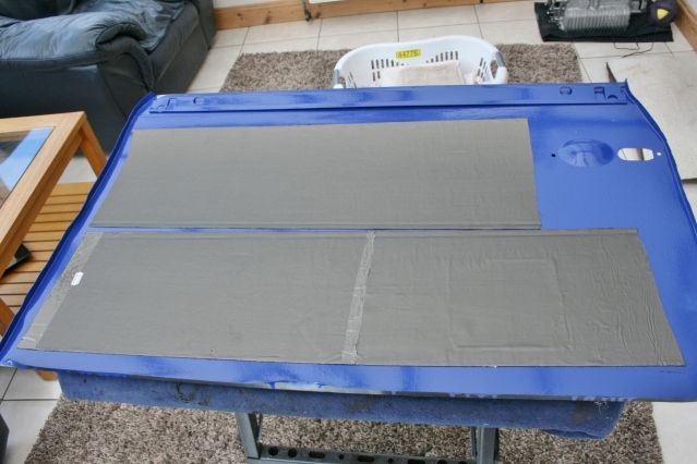

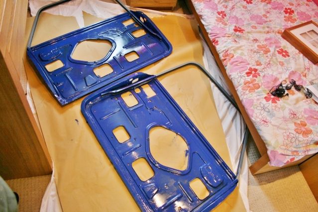

I rollered the inside of the skin with two coats of rustoleum and the same on the inside frame. Don't tell Jan the frames were painted in my daughter's bedroom while they were away, she will cut them off !! Have had a funny situation occur with the new batch of seam sealer too. It took the etch fine but the blue has sent it tacky!! Same inside the shell, old seam sealer was fine, any ideas ??
This is the sound deadening I am going to use. Not sound deadening but it sticks like the proverbial to a blanket and does what I need, deadens sound !!

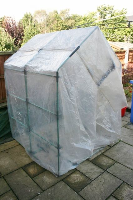

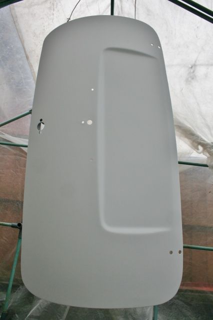

Then I could put it off no longer, built a spray booth for the smaller bits, boot lid, bonet and doors. Two old Wilcos fabric greenhouses and some sheeting.

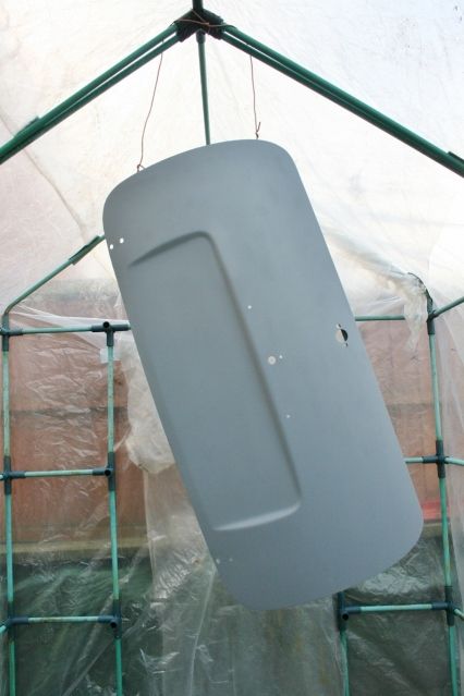

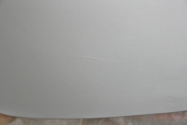

Set up the booth, dragged the compressor through the house, Jan watching in disgust, and set the brand new gun up, or so I thought. Had quite a few runs on the guineapig bootlid and should have done some more practicing first I suppose. I was 1k spraying high build primer mixed 50/50 with celly thinners.
So, watched some videos online and realised I was using it wrong, fan the wrong way, too high pressure and crap technique !! Rubbed the high build down with 180 grit and wipeddown for another attempt. Filled the gravity cup up with some white spirit and had a practice on the fence first this time with only 20 psi, much better when you know what you are meant to do !!
Much happier, just one small run but I will sand that out quite easily. I know why sprayers charge thousands for thier skills now, but haven't got thousands. I have been watching the "painting with hammerite" thread in the bodywork section and wish I had stuck with my orriginal idea and not gone for spraying !!!

I like the mini spray booth Graham.
Are you going to build a big one for the shell?

looking good quality job that, especially in yr greenhouse.....tomatoes next....

I have bought an 8 man tent off fleabay for the shell Carlos, another eyesore to annoy Jan with on the drive lol.

Loving the spray booth, I have one just like it.

Are you not planning on heating your spray booth ?
