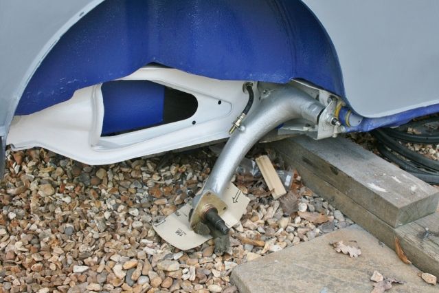

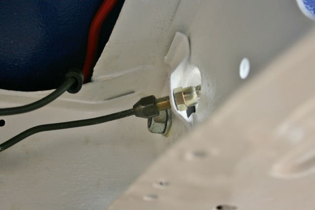

Yet again the holes on the subframe had closed up with the painting so they needed to be scraped out before the radius arm went in. Other than that it slotted in fine and the camber bracket went on nicely too after re attaching the captive nut a while ago.

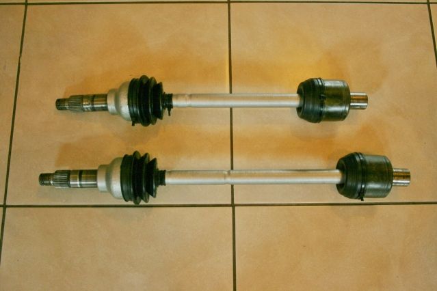

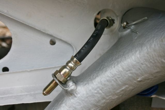

I tried the flexible hose in place to see the fit. Not bad but need the backing nuts all round to fix permenantly. Finished off the other day by regreasing the drive shafts either end and tieing up the boots, one tie missing tho at mo !!

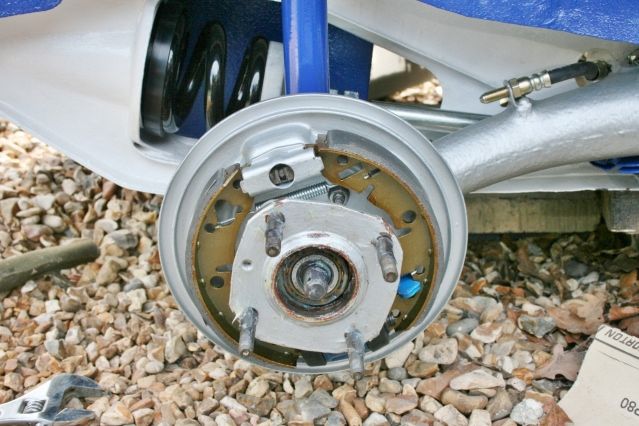

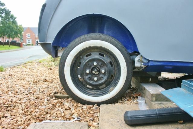

I began this afternoon trying to get the driver rear corner ready for a wheel so on the shock and drum backplate went. I am pretty sure the backplates are handed so I hope it is on the correct side, comments please !!

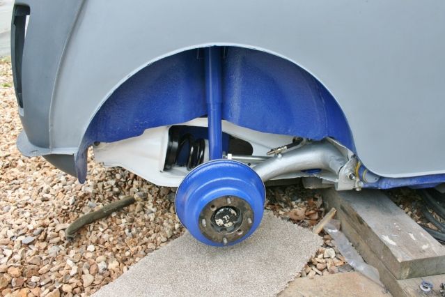

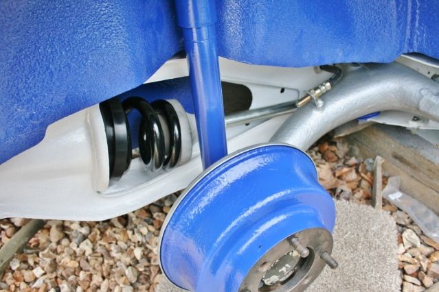

On the drum went next with the spring and hilo in place.
The spring is slack at the moment due to no weight being on the corner but when the drum is forced up it tightens up nicely. Willl have to perfect a method of changing the wheel so the spring doesn't always go slack and cause problems.
thats where shorter lowered shocks come in, dont let as much slack!

Nice one Graham, well sexy work, yu probably gathered that it is the right back plate.....

I looked in Haynes Muk, but not very clear. Thanks for the reassurance, Have torqued up and put the tight cap in place now lol. The hastle I am finding is finding all the bolts to put back or new ones to fit and the washers and split washers too. What a nightmare getting bits back on is lol !!

you probably have those in a box somewhere, full of bolts and washers you don't need..... backplate handbrake-leaver furthest away from heal-board
