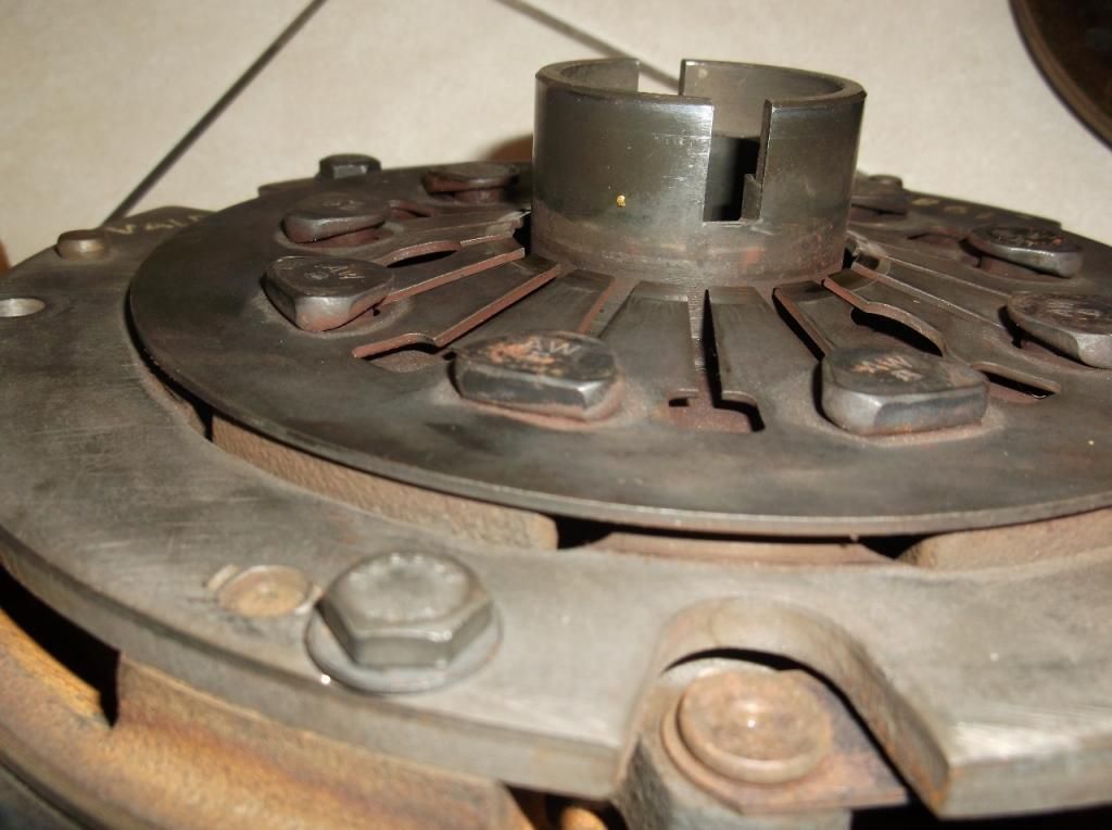

Clutch time !! The old one was looking a little worn, probably some life left in it but decided to change it anyway.

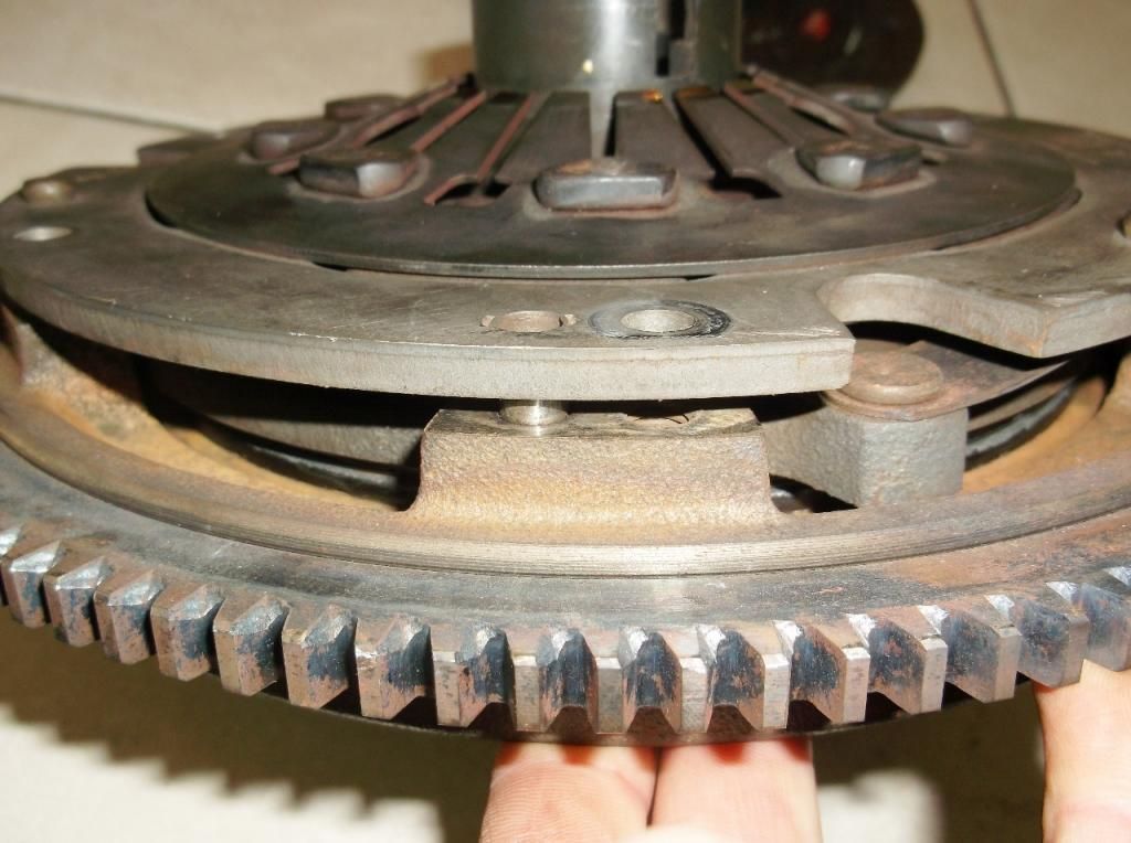

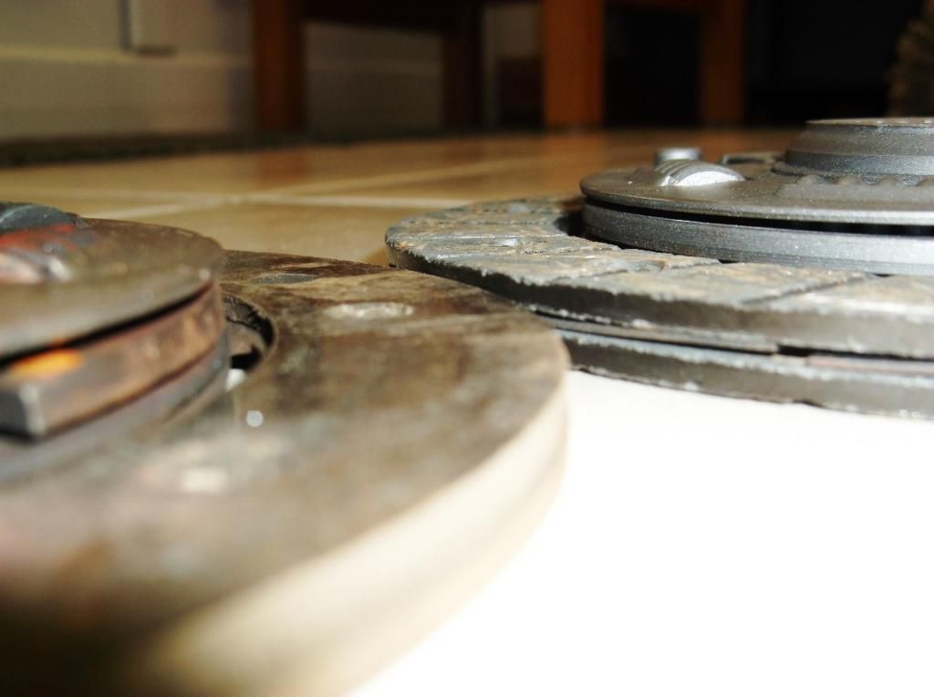

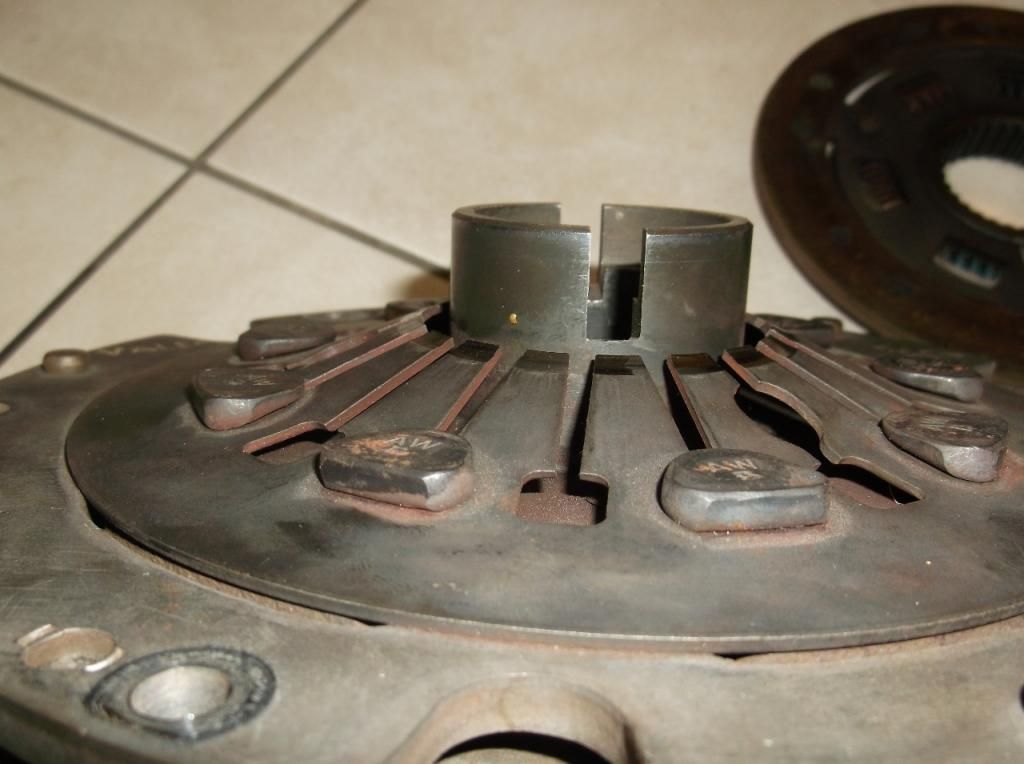

I put the pressure plate, clutch plate and flywheel together and found that there was a massive gap between them all. I tightened the screws down and the gap went but the finger springs on the prtessure plate went from this...
to this, a good way down towards the fly wheel.
No idea if this is correct but the tech section said it was ok so all good. I think as the clutch plate wears, the fingers move up self adjusting the clutch.

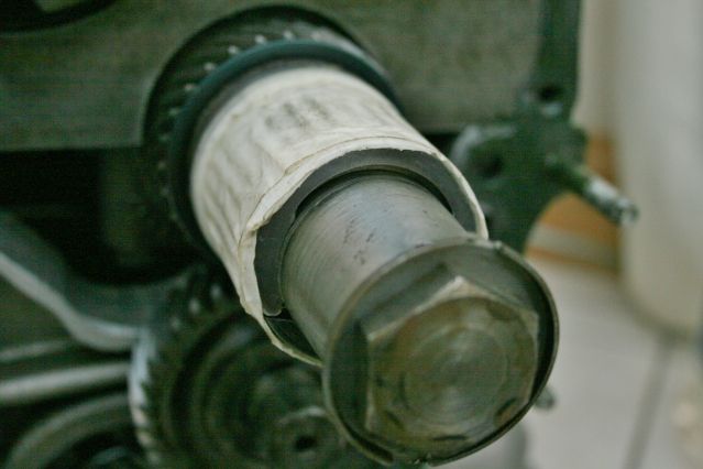

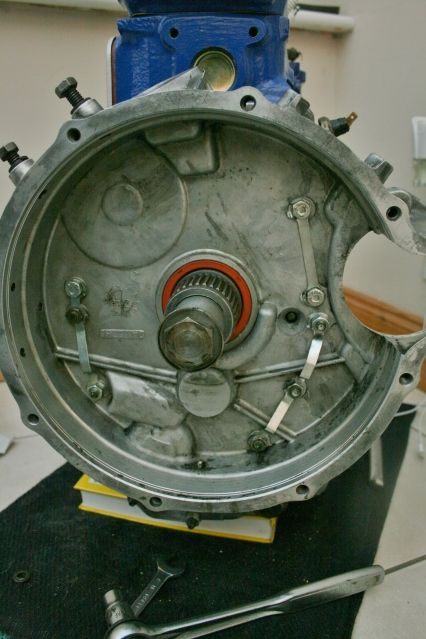

So new gasket on, backplate of the bell housing on. The pistons 1 and 4 were at TDC to make sure the C washer was facing down and wouldn't fall out, got away with this on the strip down as I didn't have a clue about it possibly coming out and siezing everything up.

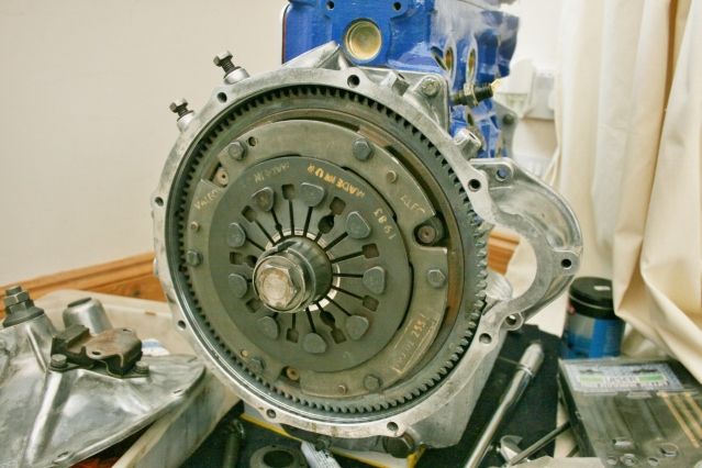

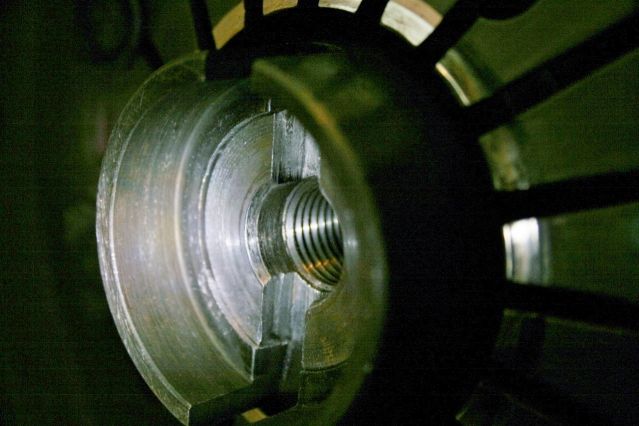

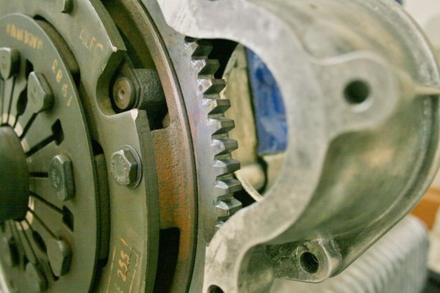

Next panic was the pressure plate not going in properly and there being a 1/2mm gap from it all being flush. I lightly lapped in the pressure plate and crank tail, read it somewhere that it extends life, but it wouldn't go any further in. Tech section to the rescue again, all good !!

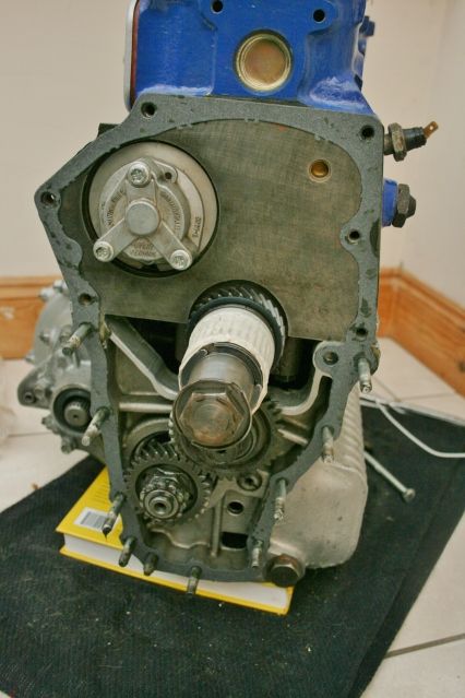

Put the keyed washer in and torqued it all up to 115 lb/ft, so clutch and flywheel assembly done and the new ring gear is even the right way round with the 'lead in' facing away from the engine.

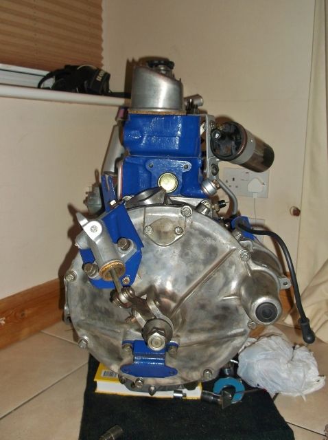

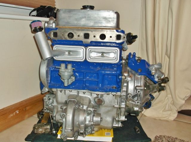

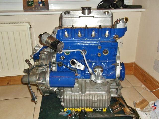

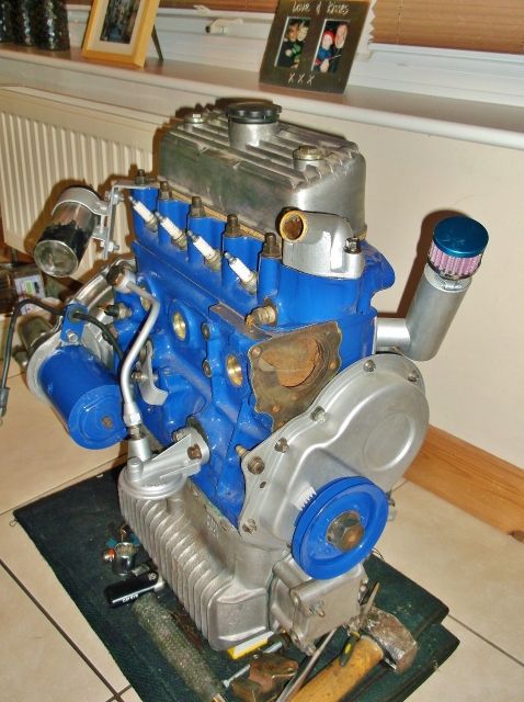

Decided to put some other bits on, fuel pump, starter motor, coil, oil filter bits etc and ended up with this...
Getting ready to test fire, omg very scary, few bits to do on the dizzy first though and water pump.
I found some lock tabs in a box of bits and discovered they were from the diff, so I looked at it and found it wasn't even torqued up !! That could have been disasterous on rurst running so checked oved all the other bolts. Nearly there on the engine but far too wet to uncover the shell for any further work there !!
