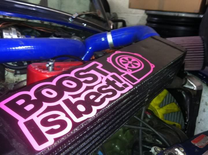

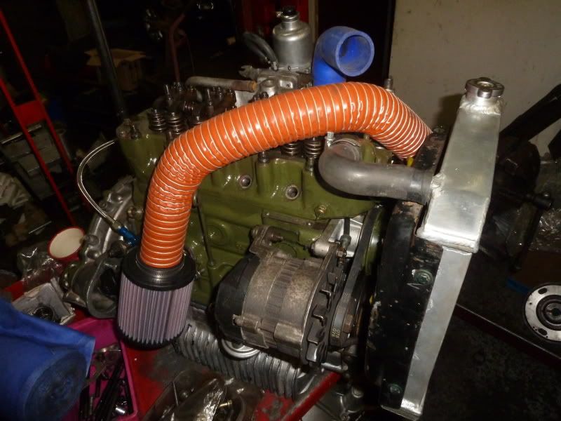

Anyway heres a couple of pics...

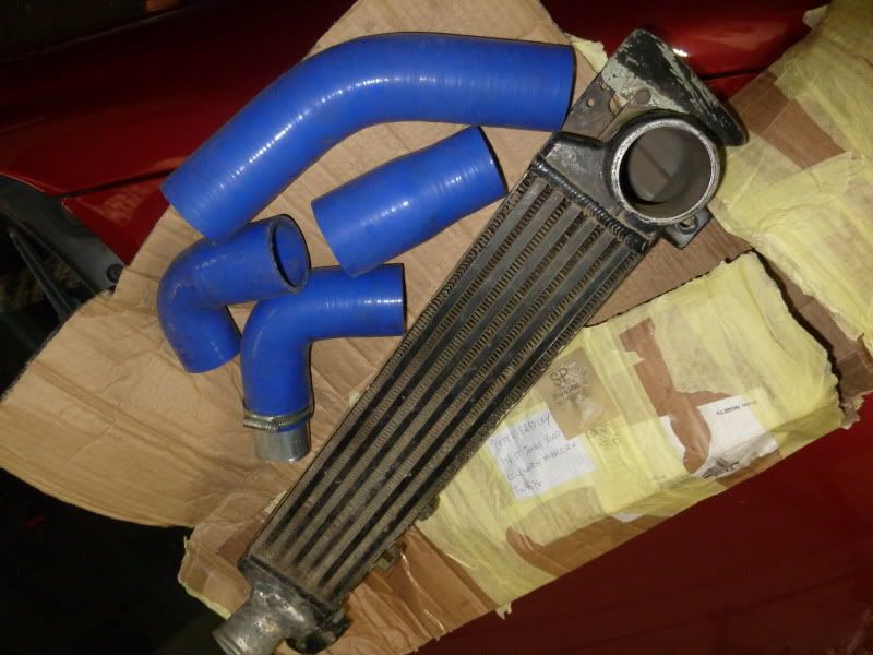

cossie intercooler and a few pipes for just a tener on ebay!!

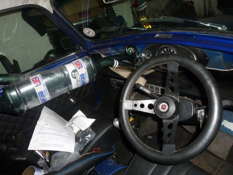

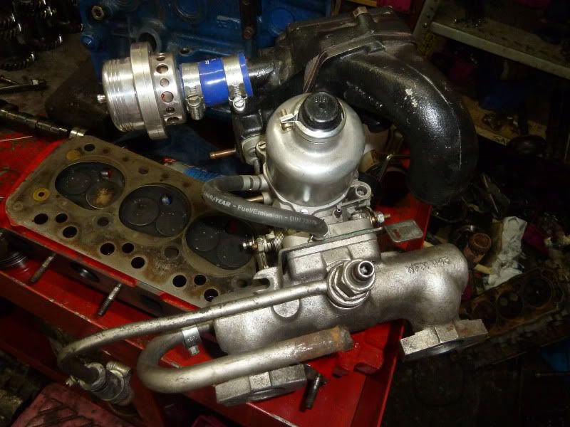

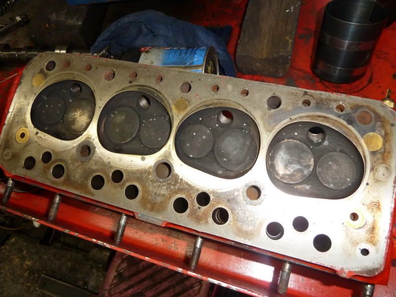

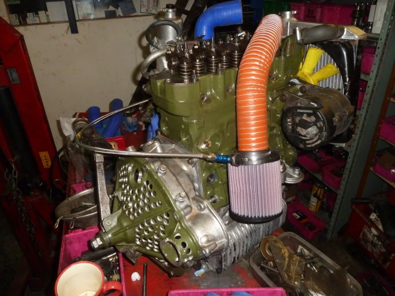

Few more pics so far -

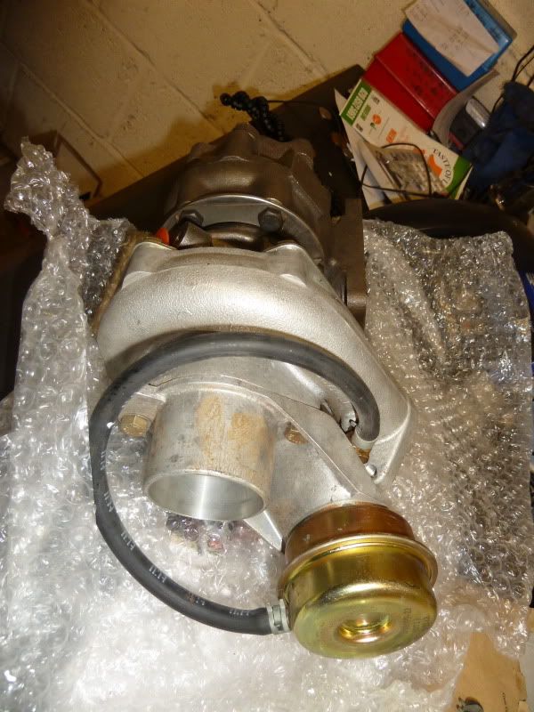

Brought a 'brand new' t3 turbo off ebay for £205 as the old one was 'proper fooooked!!
om nom nom, Im still going to use the t3 to start off with as you can still get brilliant power out of it, i dont really care how long i have to wait for it to kick in.

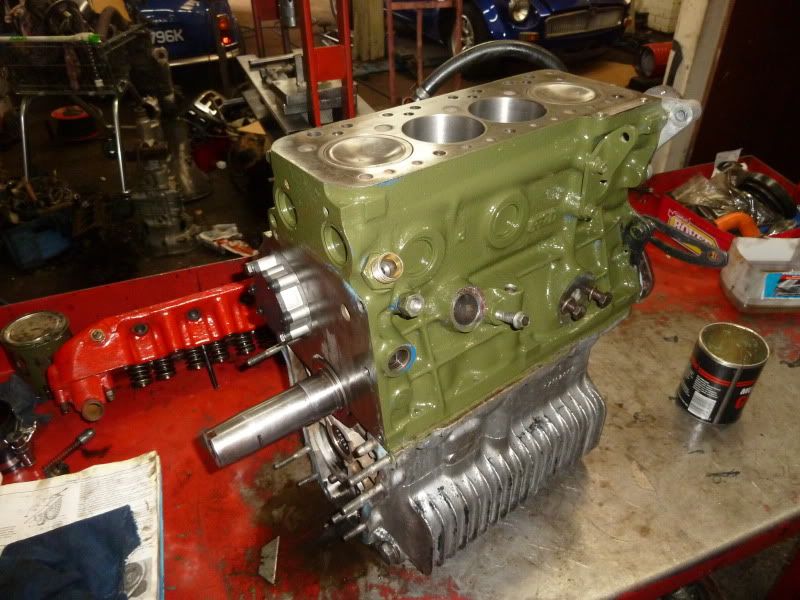

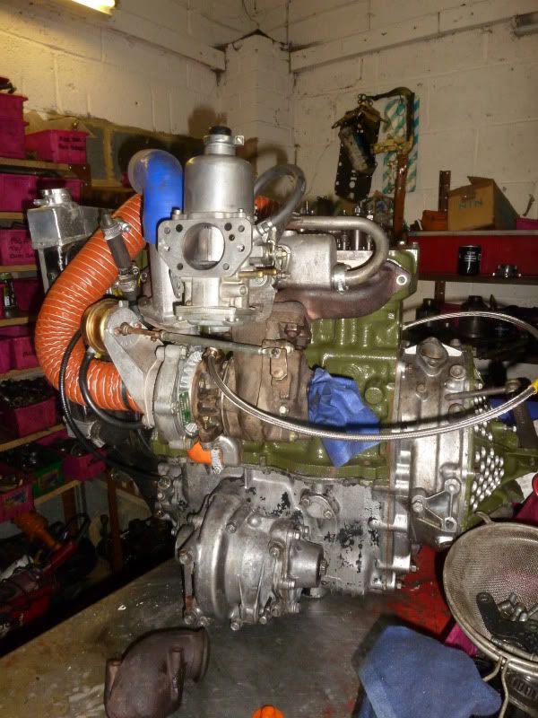

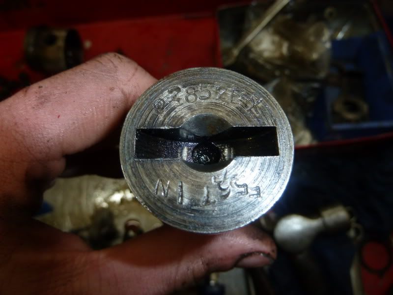

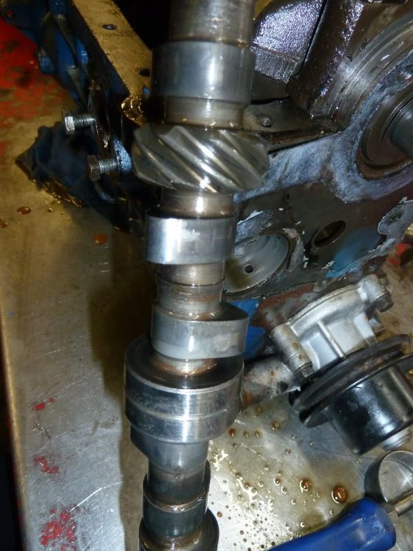

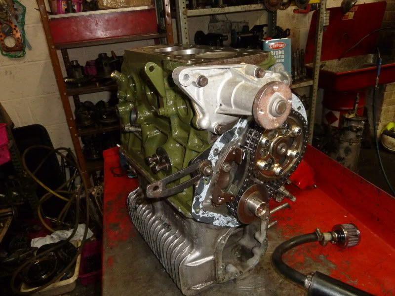

Short engine built with new turbo rings, cam in.
pic of special cam! ohhhh

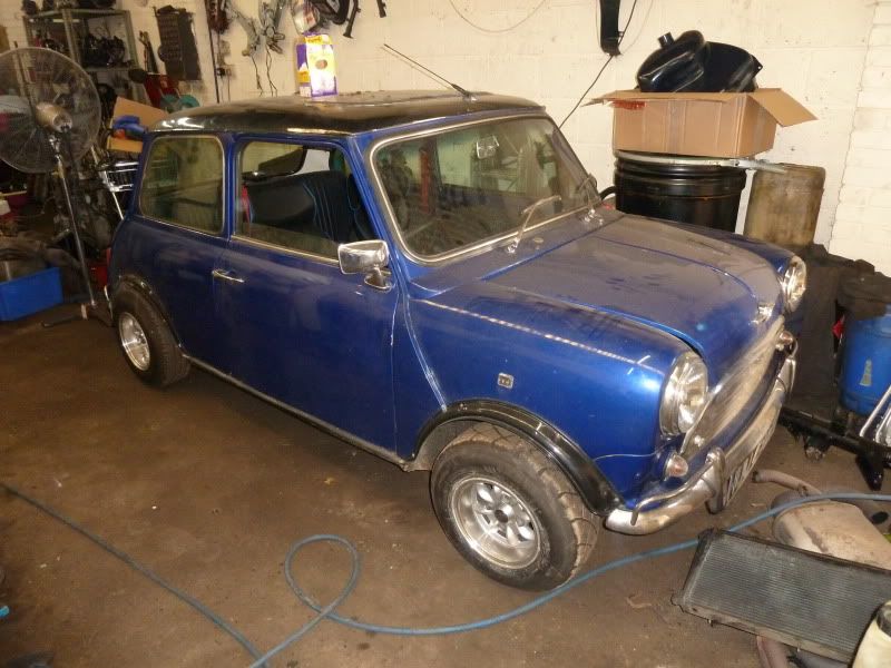

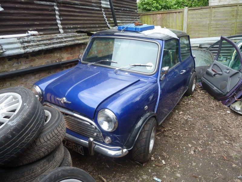

Mini is in! Looks like a barn find with the dust!!

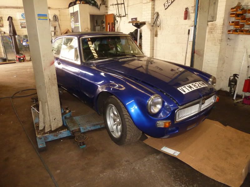

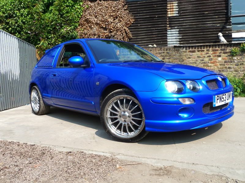

cheeky shot of a sebring style mgb v8, love it! and my zr express van, they made less than 550 of these :)

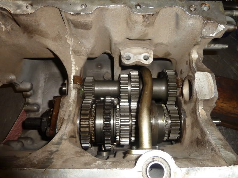

Got my x-pin diff and sc/cr gearset today from minispares, also got some 8mm cooper fuel lines too, so on saturday my old man will be building the gearbox while i start running all the fuel lines underneath and wire the mpi tank up. But going to take a few days off work next week to ge the bulkhead box fitted and put the engine in and maybe get it running.

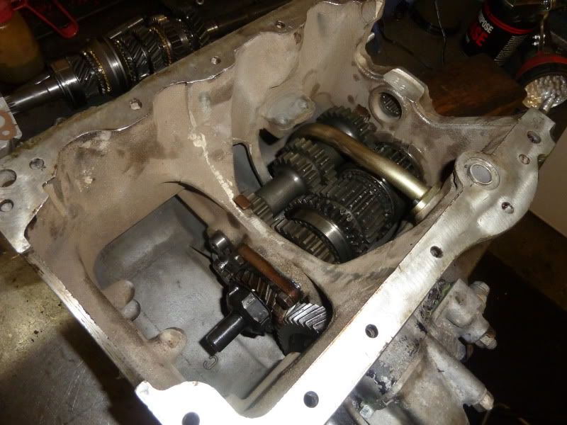

Thought i'd do a quick update with some piccies, box is now fully built up with the new gearset and diff, didnt get s/c drops, but theres a few on turbo minis that have 170+ and have sheard, will have to see :thumbsup:.

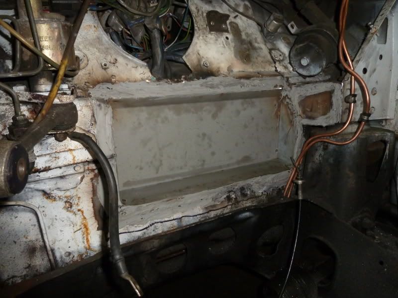

Both fuel lines are now in with the mpi tank, still need to wire it in though, engine is about 80% built up just needs the clutch to go on then its ready to go in pretty much, oh and just waiting for my gaskets to arrive from avonbar for the turrrbo, got the bulkhead box fitted aswell this saturday, think it turned out well, just needs to be tidy'd up with some paint. so this saturday or even before the engine will be going in, and maybe have it running by the following satuday. but does need a MOT and tax has ran out, but its not in to bad shape really, starting to get a fair bit of bubbling on the o/s rear window, and the bottom of the doors, but ill worry about that at a later date.
Theres also a change of colour for the roof and arches, its going to be MG x-power met grey. fancy a change really, and it needs new rear group 2 arches anyway as someone was having there mini too low :crazy:. So wont be ready for L2B, but WILL be ready for ace cafe in june.
heres some pics-

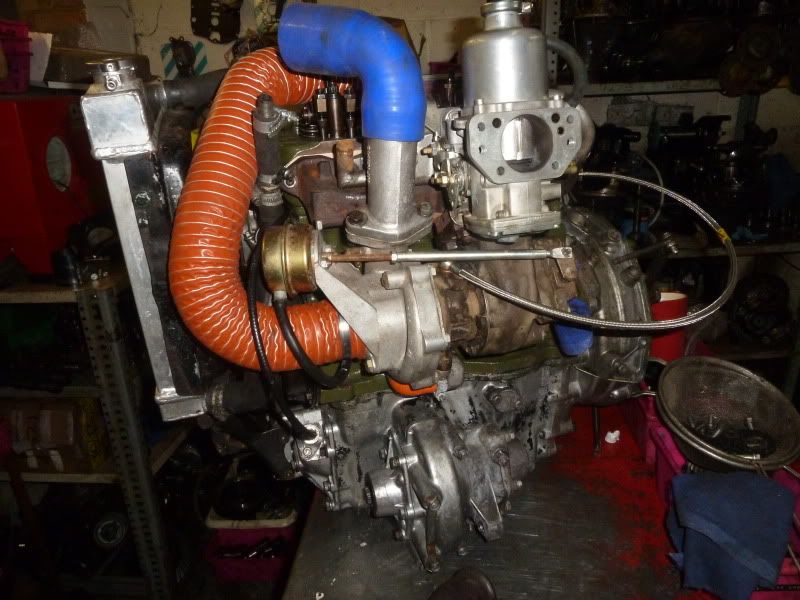

Need to collect my plenum tomorrow which needed to be tig'd because im running an intercooler, need a couple bits from moss to and also pirtek for some chavvy blue hoses for the bleed valve and intercooler pipes, and then it shoould be pretty much ready to go in the hole!, still need to do a few more odd's and ends on the engine though.
random pic, also got a new maniflow turbo exhaust 2'', spot the boost guage! :P
